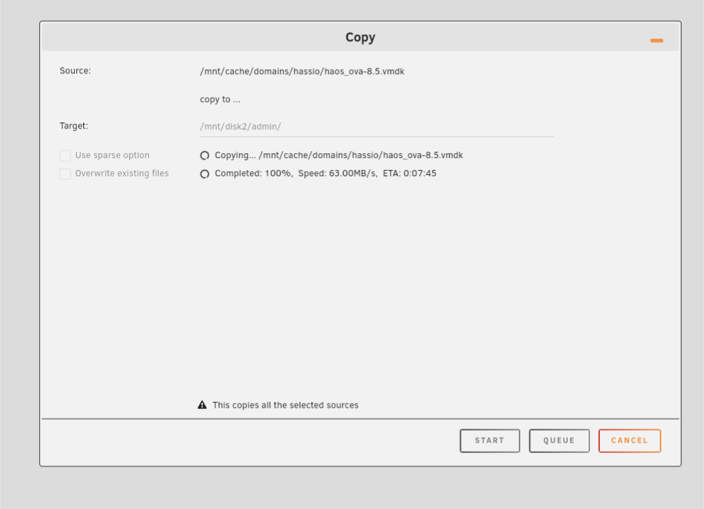

I thought I'd try to copy some files just to see if it works. I've only tried with one so far, and it got to 100%, but it doesn't seem to be concluding.
Is this because it's picked up the fact that there is an issue with the file?

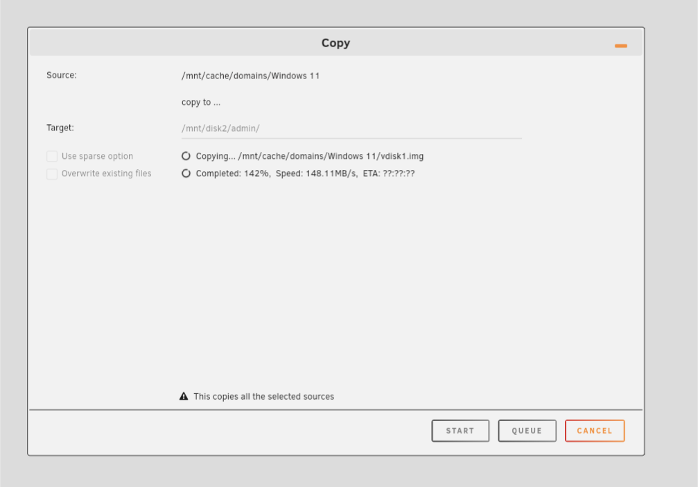

I just tried copying whoever file and it didn't work either. Thought I'd share this screenshot for giggles. Note the percentage lolScreenshot_20231218-211819.thumb.png.28dbd34496e192c951e05edb6e00a022.png
