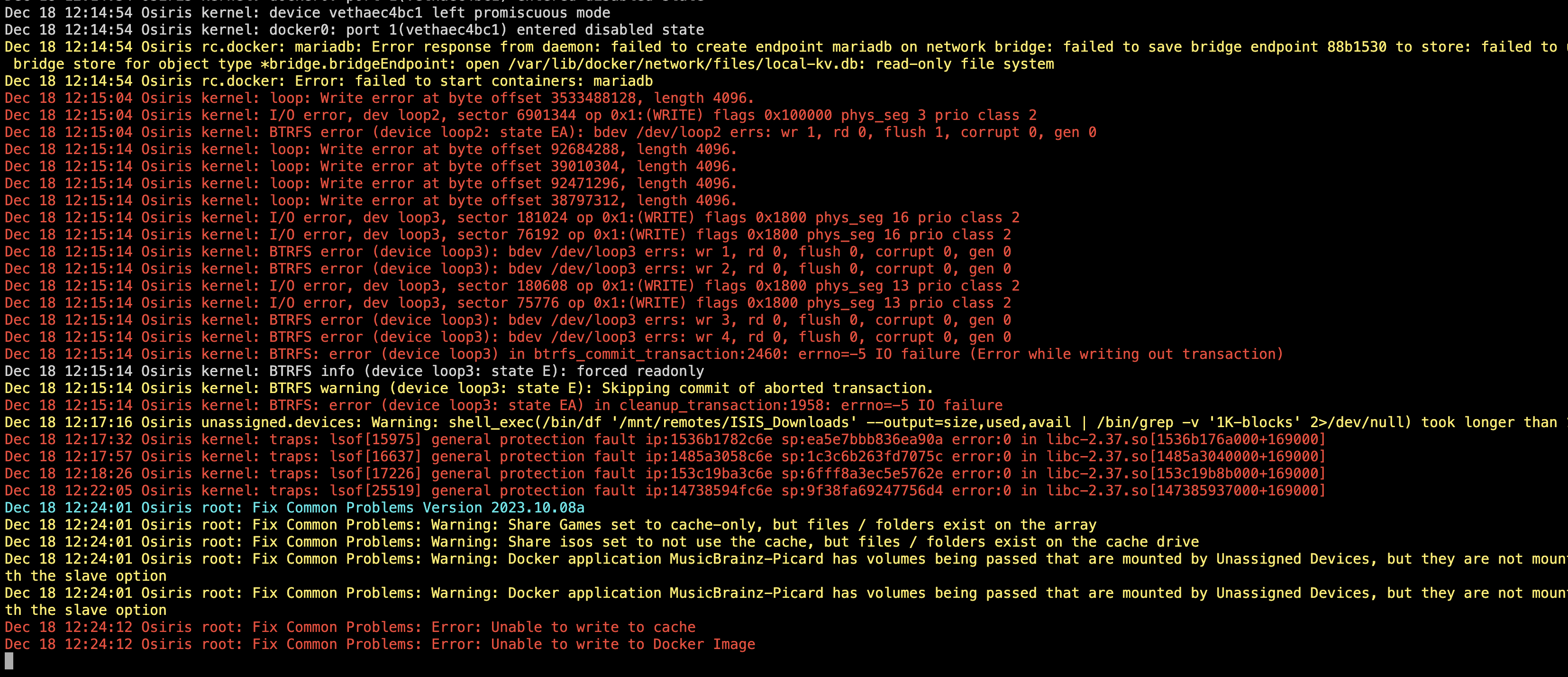

Yesterday night my server went down unexpectedly, when I got it back up again I noticed warnings about BTRFS errors in the logs.
After a bit of poking around on the net I came across the `btrfs dev stats /mnt/xxxx` command that tells me I have 4 corruption errors. However, when I try to start a scrub it aborts immediately and tells me there's no errors.
I'm a bit lost now, any advice would be greatly appreciated.
