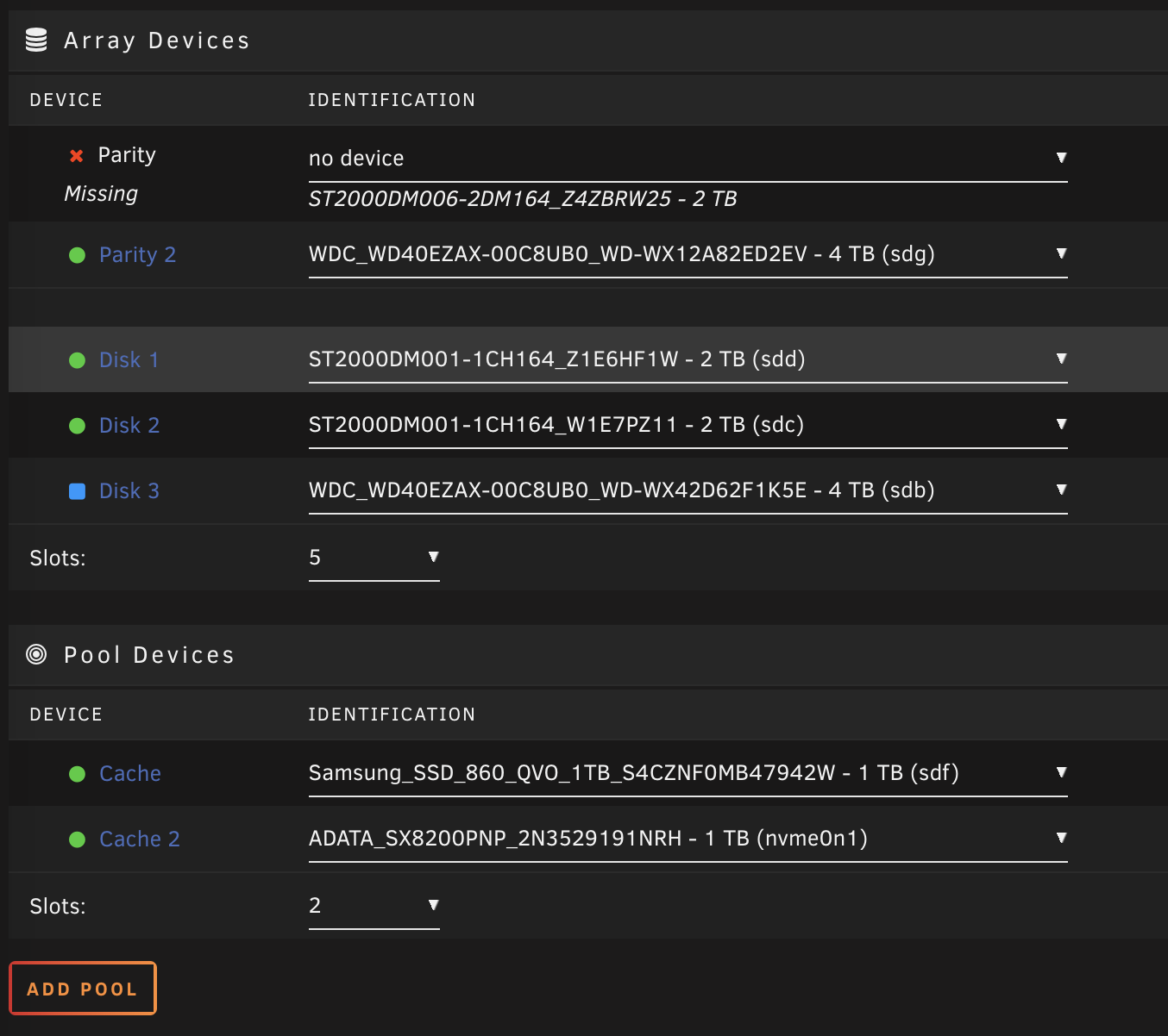

I'd like to remove it. How to do so?
Stop the array, unassign parity1, start the array, after that you can replace the disabled disk with a 4 TB disk.
I'm unable to start the array. After doing what you said (which was my first guess), I get the following issue:
Too many wrong and/or missing disks!
You need to unassign the new disk3, only after parity1 is removed you can use assign that disk.
Right! I did that and it works. Thanks a lot!
