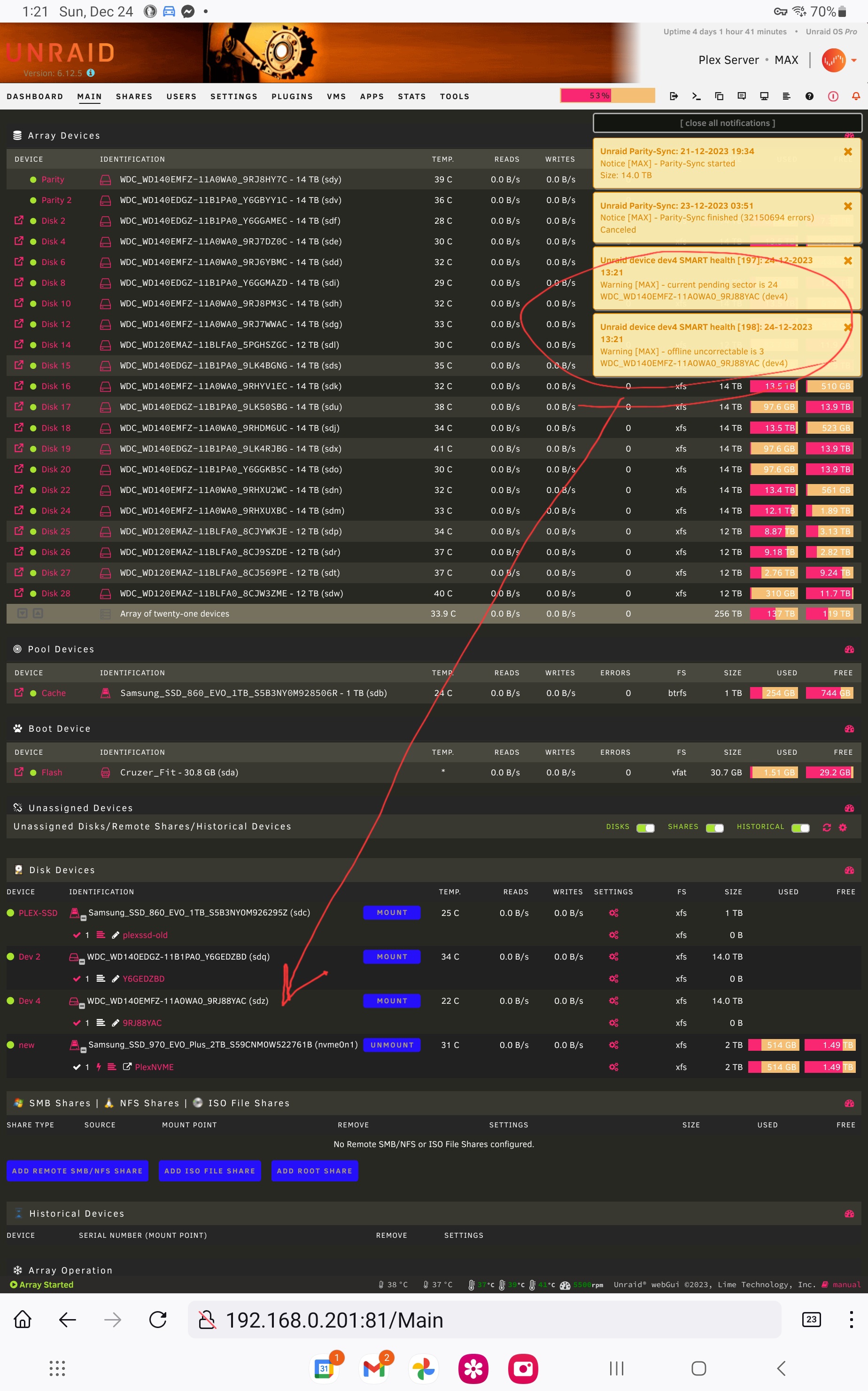

Is this drive still attached? Which drive was it?
Disk 20 I removed it from the array
WDC_WD140EMFZ-11AOWAO_9RJ88YAC-14 TB (sdo)
and it was 95% full of data
I don't have a backup of the data on it...but its not totally inreadable (I think?) I 'started' copying the data/media from it to an unassigned drive
"Dev 3 WDC_ WD1 40EDGZ-11B1PAO_Y6GEDZBD (sdq)", but stopped when I thought I could just replace it and rebuild it based on the parity drives

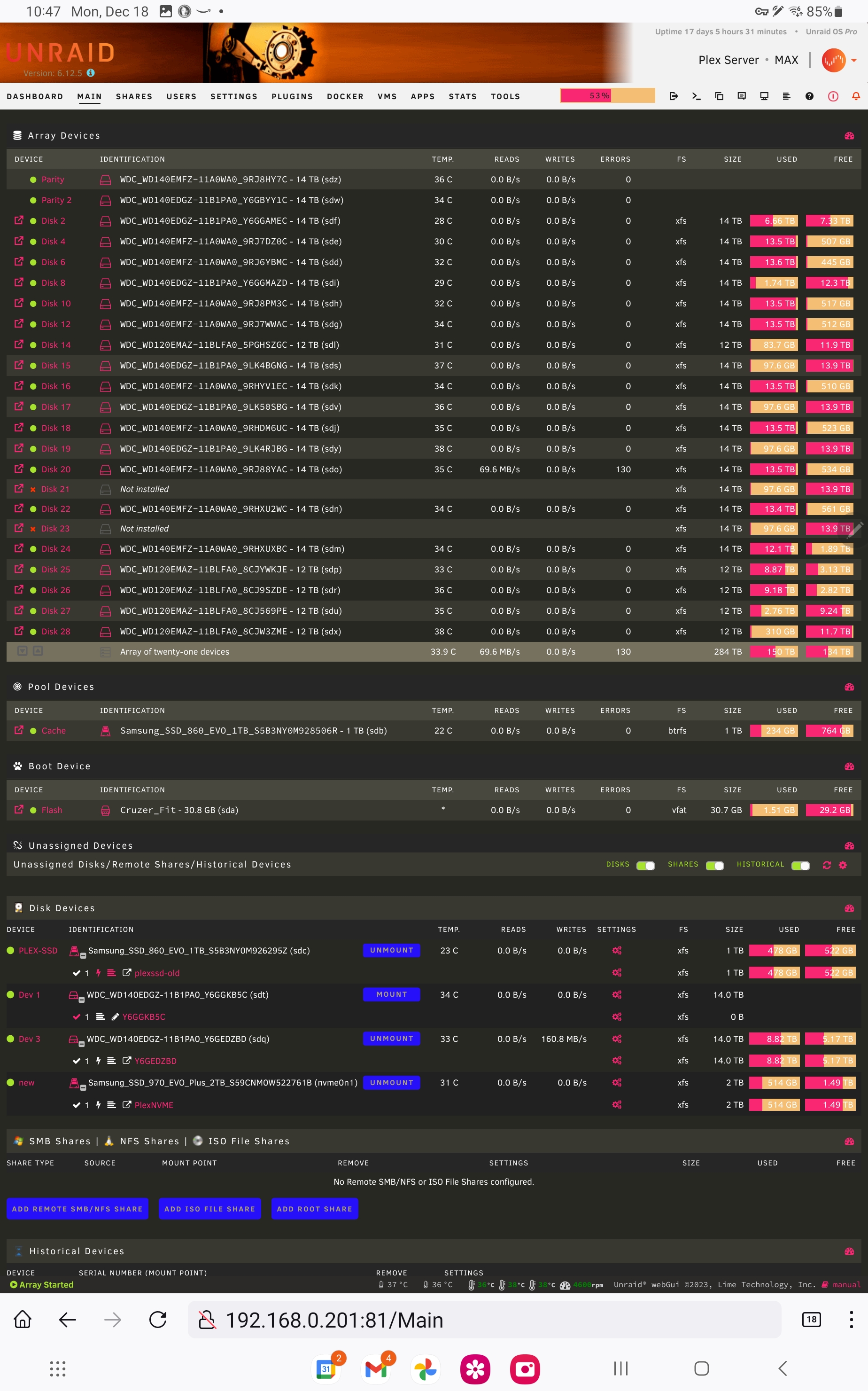

(you will see in the included screenshot, that I was moving files to the unassigned drive.. that was after I started developing the read errors on disk 20)

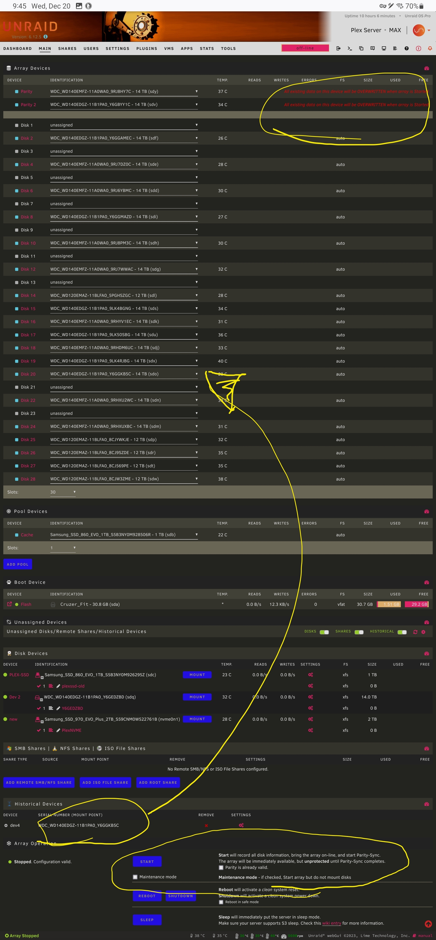

you will also see that I had the 2 missing drives (I stopped the array and reallocated those slots to "no drive" and then when I restarted the array they became unassigned drives.. but before I could save the new config, I started having errors with disc 20..

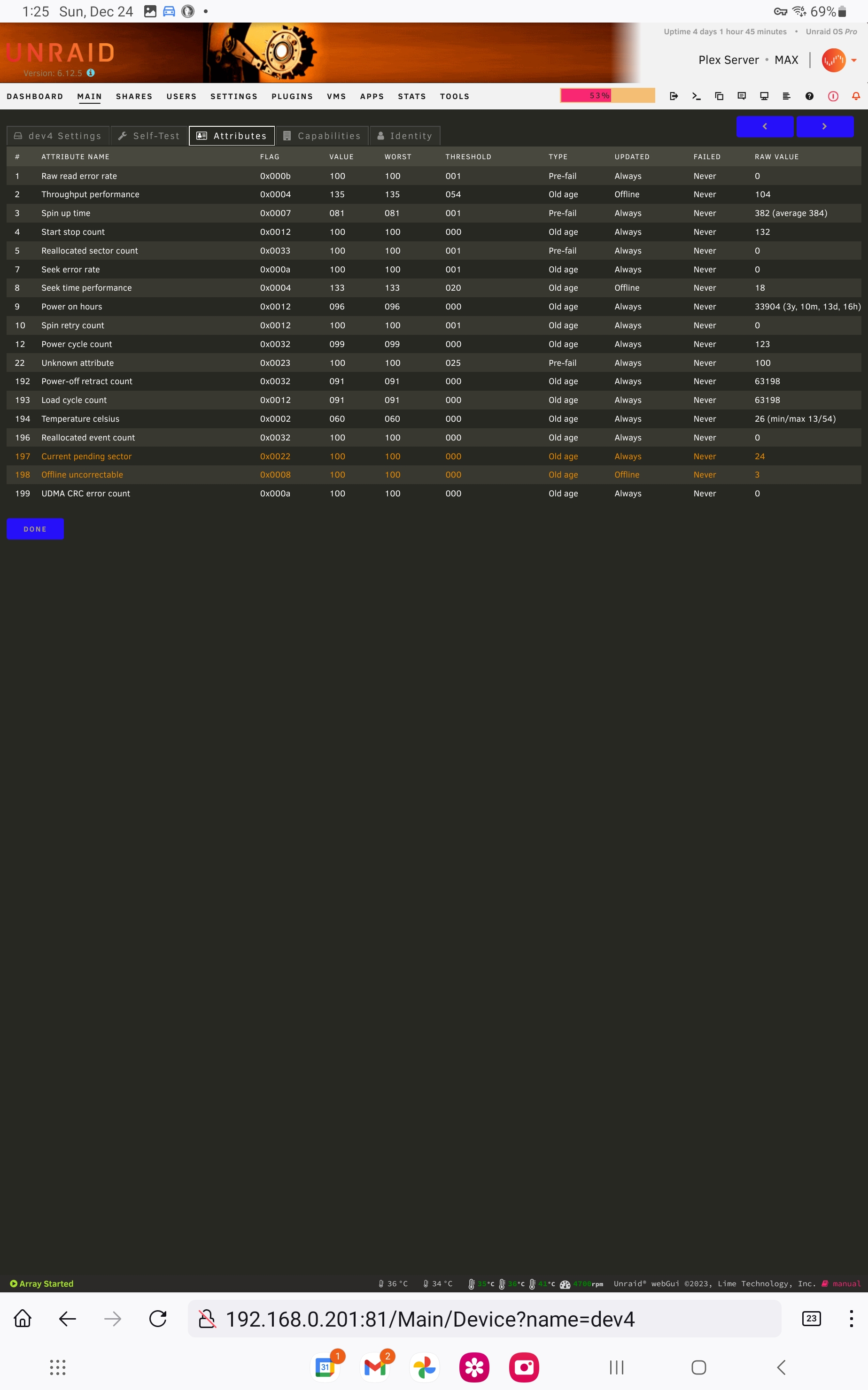

I tried the "SMART extended self-test:" of disk 20 and it failed because of a read error.Screenshot_20231218_224747_Firefox.thumb.jpg.392b91e346e542591d5108b8f5e21e96.jpg
Since that picture... I stopped copying the data from "WDC_WD140EMFZ-11A0WA0_9RJ88YAC-14TB (Sdo)" to "WDC_ WD1 40EDGZ-11B1PAO_Y6GEDZBD (sdq)" before it completed...
and then stopped the array and removed disk 20 and replaced it with "WDC WD140EDGZ-11B1PAO Y6GGKB5C (sdt)" (empty drive but was part of the array before....either disk 21 or disk 23)

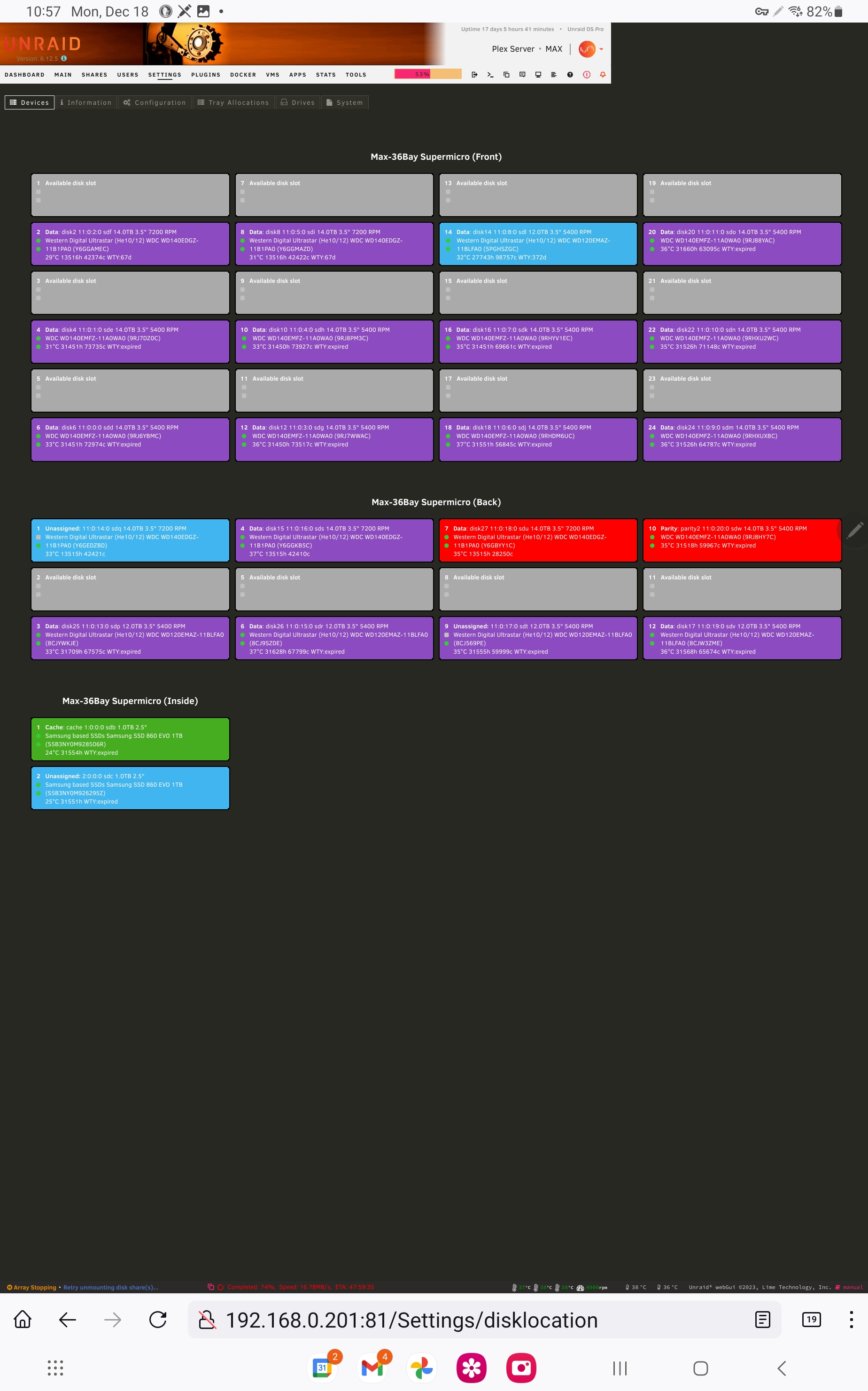

Also, the reason that I don't have the drive numbers sequentially is because I have them staggered in my server to allow for more airflow? And I decided to, initially, number the drives in the array to reflect the slots in the server, for the most part.
This is how the server bays look (mostly)
and this is a screenshot showing errors to disk 20... and the 2nd screenshot is what happened when I swapped the drives, SAVED THE NEW CONFIG, and then started the array after checking the checkbox "Parity is valid"......(I also chose to just "test" the parity, not correct array based on the parity drives....because I was sure it was going to mess things up?

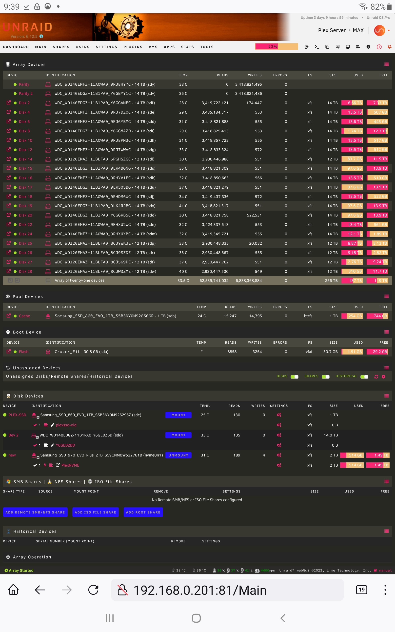

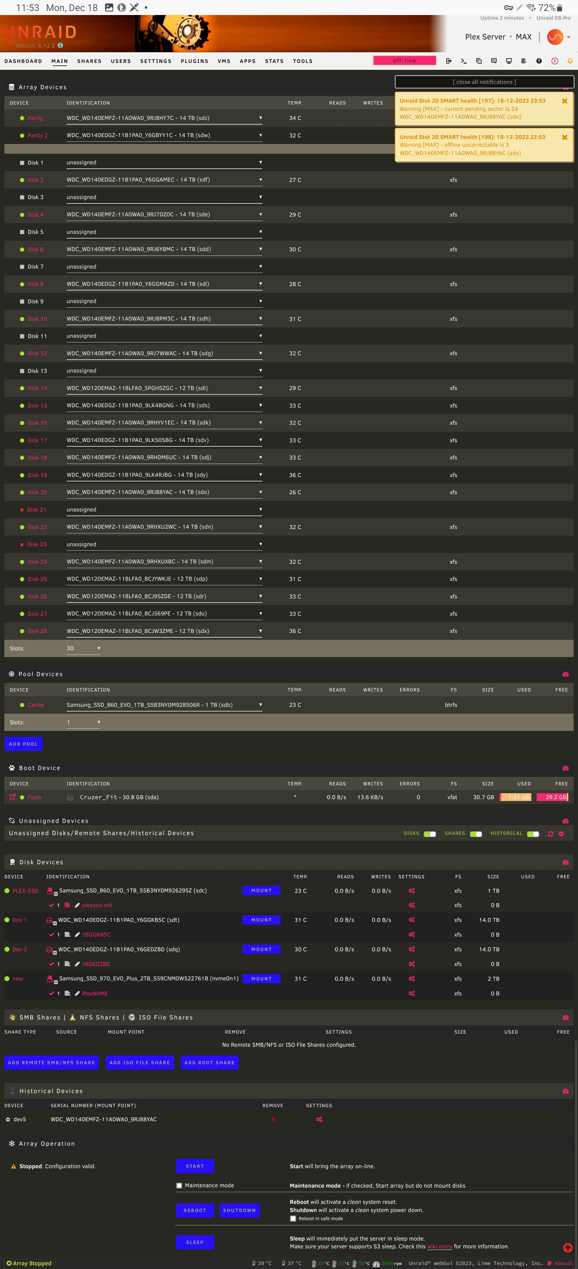

this is currently where I'm at...I just did a "new config" preserving allocations....and then chose the unassigned drive for the "Disk 20" slot.... and now I do not want to start the array...until I know more 🤕
Make sure you DON'T check the parity valid box, start the array, let parity rebuild.
While parity is building, in Main - Array Devices, you should see lots of writes to parity, lots of reads from data disks, no errors on any disks.
If it is getting errors, or going very slowly, or fails to complete parity rebuild without disabling any disks, post new diagnostics.
If all that goes well, post new diagnostics after parity rebuild complete, and we can go from there.

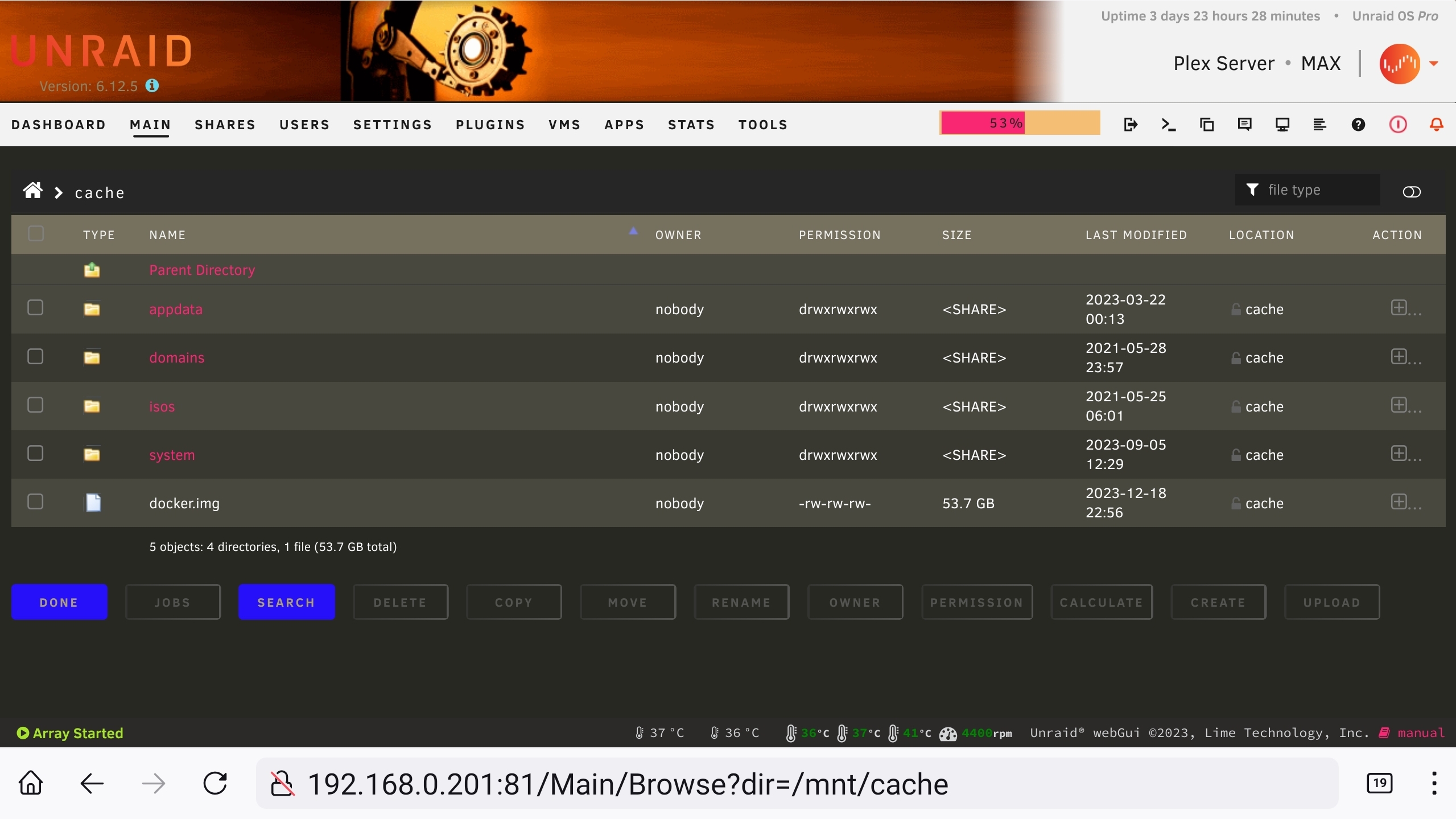

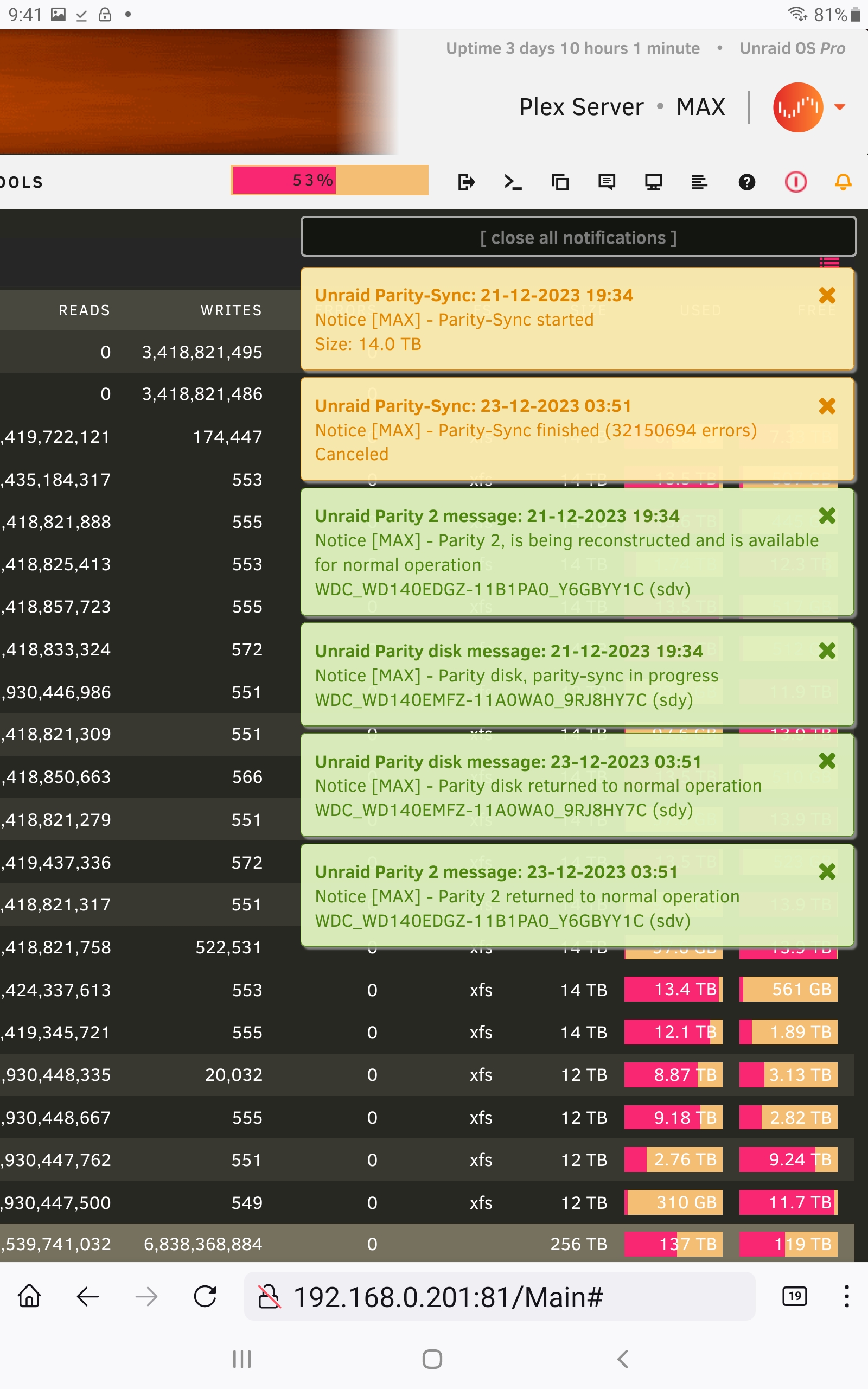

Okay. I did all that and none of my data that was on disc 20 has been restored from parity. And now my Docker container as well as all of my Dockers inside is gone!? I can see that it could be on the Cache Drive...? If I execute the Mover.. it was set to move appdata from the array to the cache... so I don't think that will work? If anything, it may very well overwrite my previous Docker container and appdata with the blank ones on the array?
I'm thinking I should reinsert disc 20 that had data on it and mounted as a unassigned drive and try to copy its data back onto the array.. specifically back onto the replaced disc 20? And manually copy across the app data and Docker container from the cache to the main array?
I would really like to get my Plex server back up and going for my family ASAP... and even if I restore the app data and docker images.. I will have to make sure that the media is restored to disc 20 before starting up Plex again as it and many of my other Docker containers will think that all of the media on this 20 has been purposefully deleted:-(

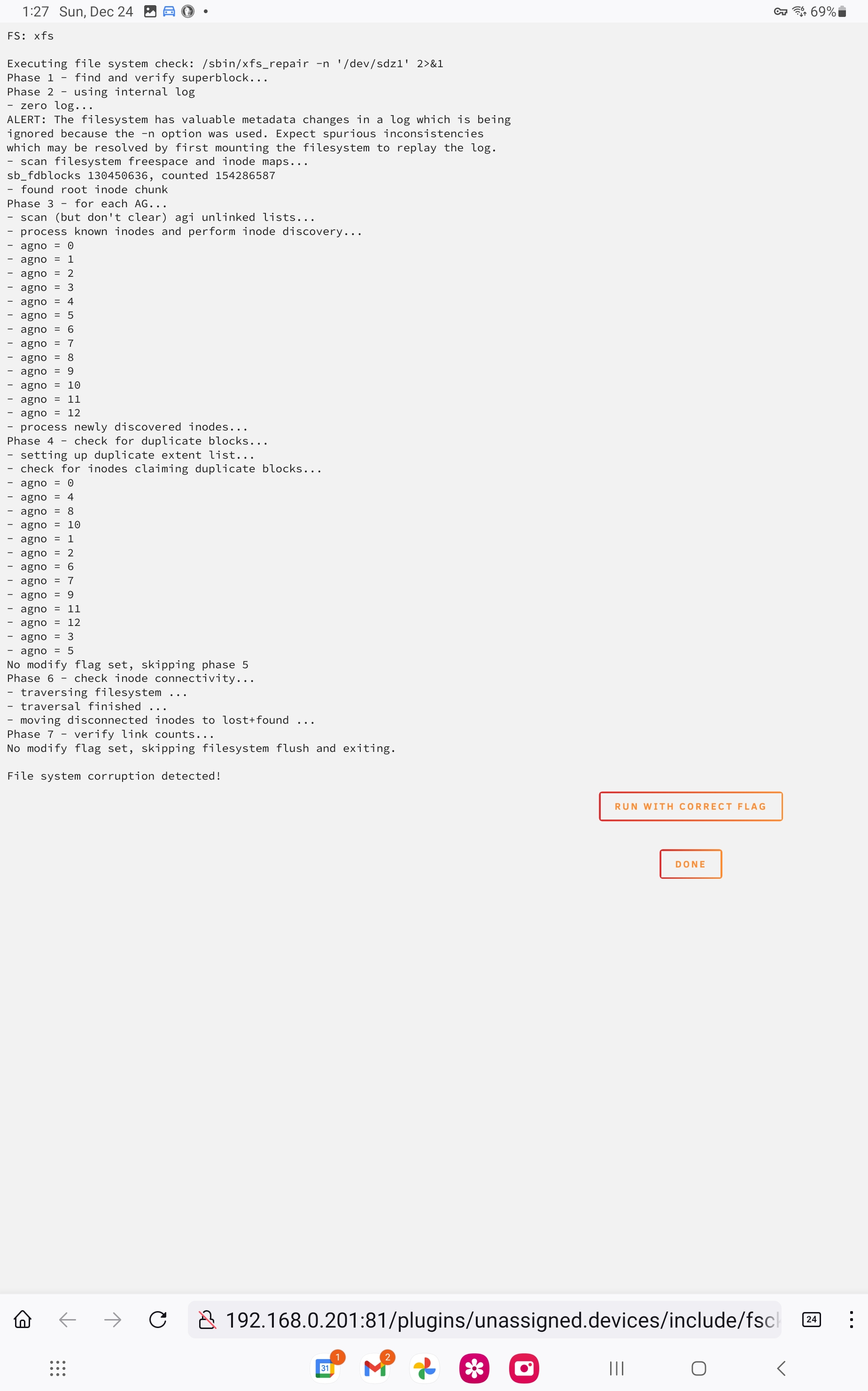

I've also attached a pic of when I inserted the (defective) old disk20 and checked filesystem.... Should I run filesystem check "with correct flag"? Or just mount drive and transfer contents back onto the array?  (And same with appdata from cache drive?)
Any help you can get will be greatly appreciated!
Of course not. That disk wasn't rebuilt, parity was.
Disable Docker and VM Manager in Settings and leave them disabled until all of your disks are working well and you have recovered as much data as you can. No point in trying to fix Dockers/VMs until then.
Yes
