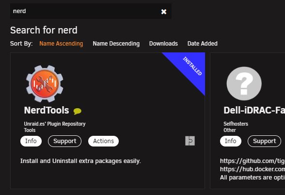

The More information link further discusses this mcelog as part of NerdPack, but the thing is I don't have "NerdPack" I have "NerdTools" and there is no "mcelog" toggle under NerdTools. Somewhere in my search I found something that suggested to use "edac_mce_amd" since I have an AMD CPU, but even that isn't found under NerdTools.

How do I install nerdpack? CA only has nerdtools and mcelog is not a part of nerdtools. There is obviously something I am missing here. Or something obvious that I am missing?
In nertools there is no mcelog on my system.
