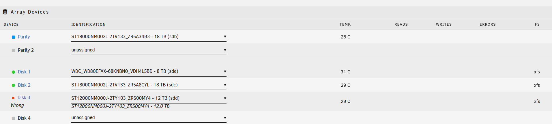

Last night I stopped the array to add a parity drive. Everything was working fine until I stopped the array. I just wanted to add a pre-cleared disk. I was blocked from starting the array again due to a "wrong" error for one of the existing drives. I've tried rebooting, and the "wrong" error persists.
The only change I made to the array was to select the parity drive from the drop-down. It was already installed in the pc, so I didn't need to reboot before trying to add it.
The build consists of an nvme cache drive, two old spinning drives (between 3-4 years old), as well as two "new" spinning 18TB drives (manufacturer refurbished from serverpartdeals).  The existing 12TB drive is giving me issues.

Disk3 is being detected with a different capacity, hence the "disk wrong", do you still have old parity?
thanks for the quick reply!
I've never had a parity drive. I was trying to add an 18tb drive to be the parity drive. This is why I stopped the array. The 12TB (Disk3)  was never parity. It's always been a storage drive. I didn't make any changes to it.
If there's no parity you can't rebuild, you can do a new config for Unraid to accept the new disk capacity but the disk may no longer mount.

I suspect this can happen if the disk had a previous partition, the format was not completely successful and it was using the previous layout until a reboot was done.

I started a new config. The other disks were added successfully (nice feature to have the existing array structure preserved 👍). But, the disk with issues was not able to be added successfully. I removed it from the array and am running xfs_repair. Hopefully I can get it to a point where it can mount (eg: via mount -t xfs) and then copy the files from the disk into the (now parity protected) array.
