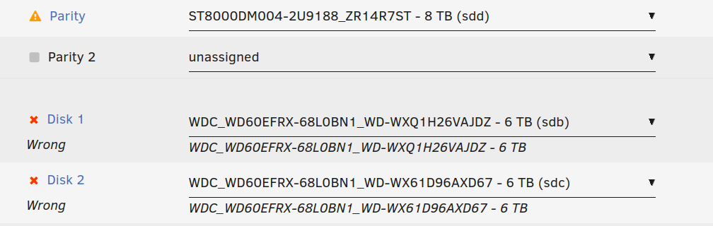

simple reboot, invalid configuration too many wrong and/or missing disks!
I'm running brand new install UnRaid pro Version 6.12.6 2023-12-01.
This is a completely new install, I'm not concerned about data loss, but i am concerned why this happened. I was about 75% completed with parity sync, but wanted to reboot, not sure If I really needed to, but stopped the sync process then rebooted. Pretty simple right? When it came back up, low and behold the array was not running and I had the wrong disk issues as shown in the attached.  Even stranger the selected disk and the "wrong label" match exactly!
Everything looks fine. For those that will point to it being the usb flash I doubt there's anything wrong with it, It's a new Samsung 32 gig flash and the system shows no errors anywhere. But who knows?
So again, just trying to figure out how, a new install could ever have this happen after a simple reboot.
Thanks
-TD
Solved by JorgeB
No hardware or BIOS changes?
Nothing at all, again brand new install. I left it run over night letting the parity drive sync. This morning it was about 75% complete. The only thing I did was install the RTL8152 Drivers, which I needed because my Realtek 2.5 USB  Nic was connecting at half duplex. It was working though and still is. Because it required a reboot to take effect, I did so. As I said I even took the step of pausing the parity sync. Doubt that should have mattered though. After the reboot, it was in the state shown.
My concern is how that happened, and what it even means? Why was it saying wrong drive but showing the right drive. In the end I just went to new config, I did say Preserve current assignments but that didn't help and even had to reformat them. I'm letting it run parity-sync once more take another day ...
I also rebooted right after and nothing broke, as a noob, it just makes me concerned that nothing really made sense here, its like it was complaining that the config was wrong when as far as I can tell it wasnt. Super strange that nothing shows up via the diag either.
Disks are "wrong" because the capacity changed, I suspect this is happening sometimes when the disks were already partitioned with a different starting sector, in this case 2048, since it's the only other starting sector Unraid accepts, and then when Unraid re-formats the disks for some reason they still use the old partition layout, possibly because it was still in RAM, and only after a reboot it starts using the new partition.
What we would need would be the diags pre-reboot, unfortunately the users only see the issue after a reboot, so unlikely they will have those diags.
            [id] => WDC_WD60EFRX-68L0BN1_WD-WXQ1H26VAJDZ
            [size] => 5860522532
            [status] => DISK_WRONG
            [sizeSb] => 5860521540
This is for disk1, size is the current size, sizeSb is the old one, what Unraid was expecting, note that:
2048 (old starting sector) -64 (current starting sector) =1984 / 2 (since each sector is 512B) = 992 + 5860521540 (old size) = 5860522532 (new size)
So this should not happen anymore after the first reboot, you'd just need to do a new config and re-format the disks.
Now, you mention you don't need the data, but if you can please try this, since it happened before to users who needed the data, and I have no way of reproducing this issue, try re-creating the old partitions with:
sgdisk -o -a 8 -n 1:1M:0 /dev/sdX
Replace X with correct disks 1 and 2 identifiers, then reboot again to make sure the new layout is used, or just try refreshing the main page, since a reboot should not be needed, the disks should no longer show "wrong", start the array and lease let me know is they still mount.
