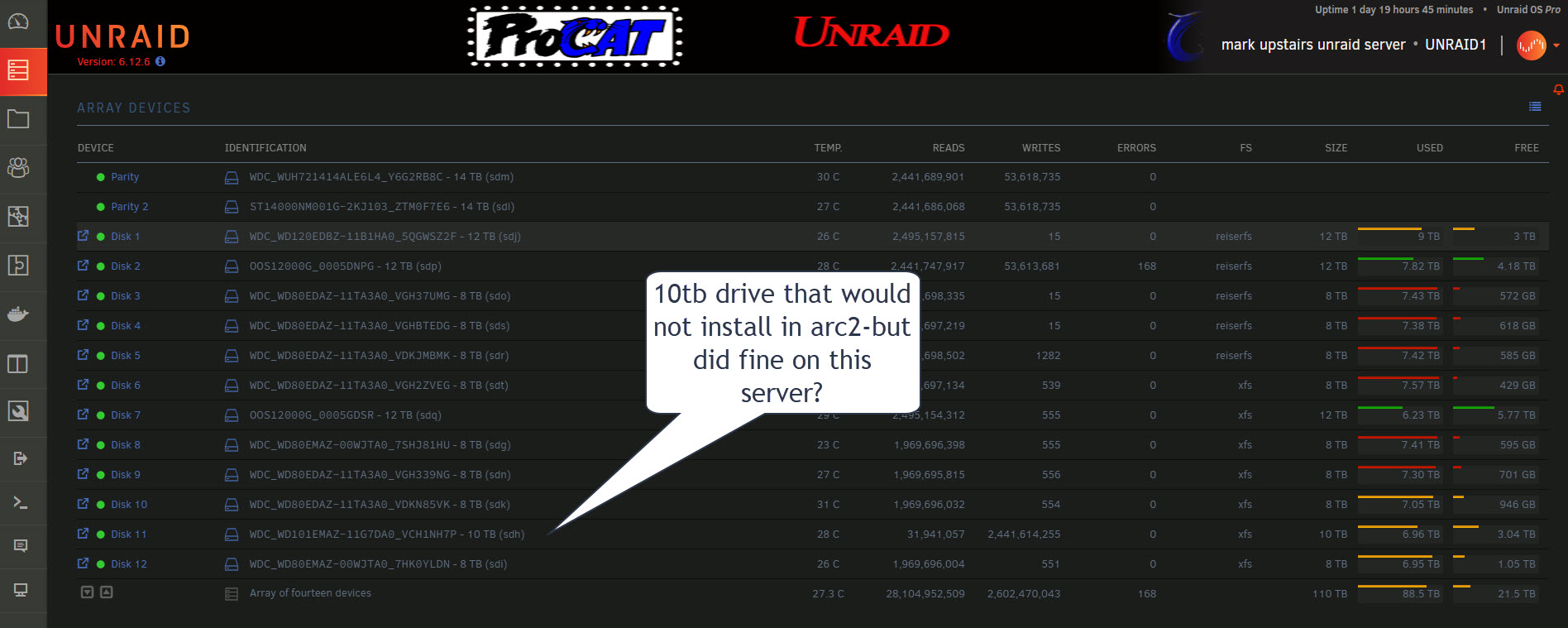

i used the SAME 10tb drive that just "ground out"  for 3 days on arc2 and tried to put it into a different unraid server (unraid1) thhis went fine - without issues -- so i'm thinjking it isn't issues with the 10tb drive - ive attached daigs for this server as well (unraid1)

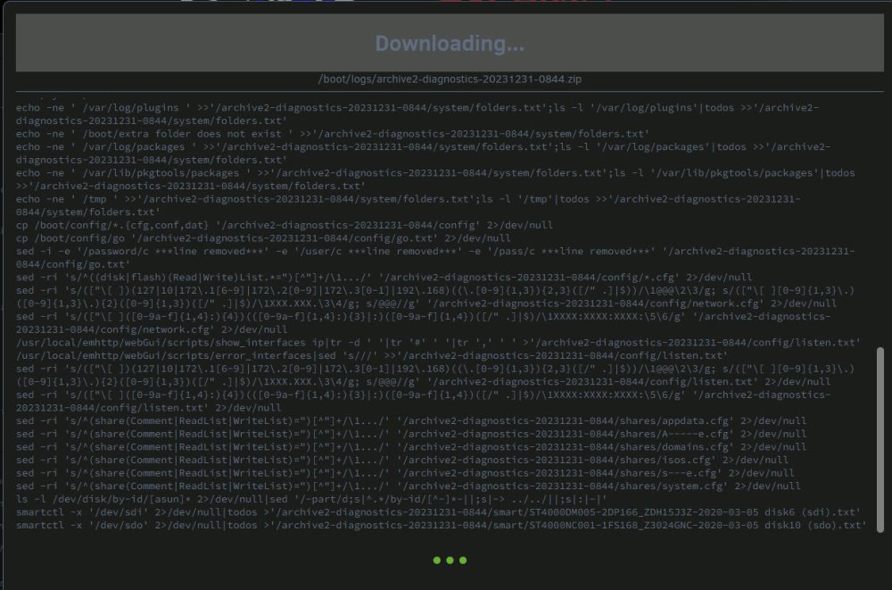

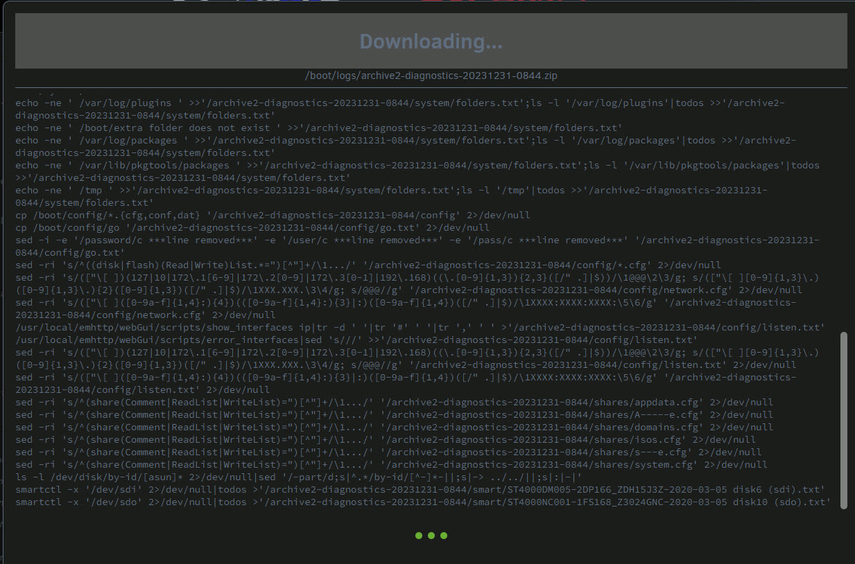

when arc2 was just grinding for a couple days, i tried to create diagnostics but it wouldnt create it, it tried  --  but overall just sat there -- i took a screen grab of this - perhaps it will help...
