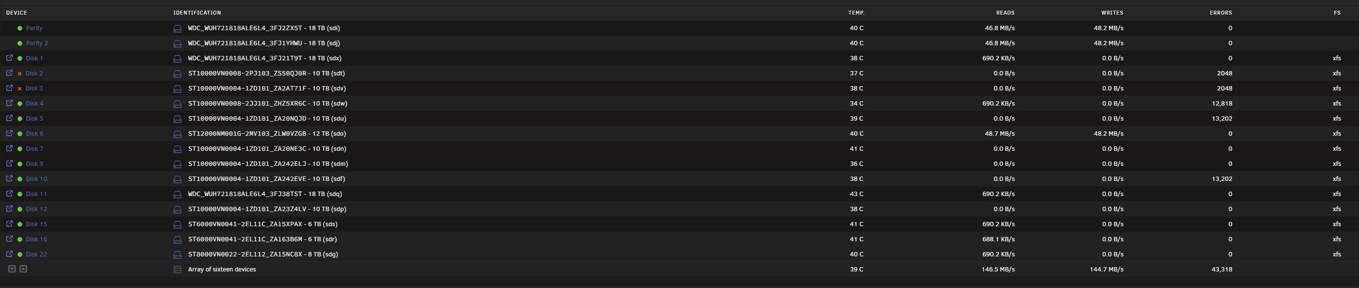

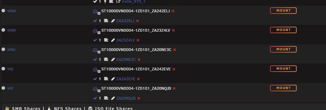

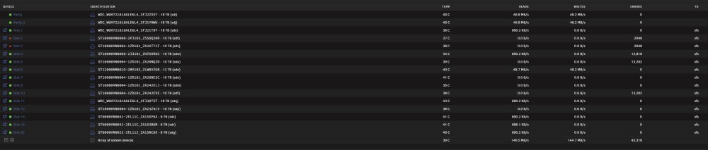

Hello, I have been away from my server, and it has been offline for 11 months, updated to lasted OS, and updated all my dockers, but I cant get sonarr and radarr to start? get error 403.
any help?
Thanks!
lucifer-diagnostics-20240102-2244.zip
Solved by JorgeB
Disk issues look more like a power/connection issue.
Did change my PSU and now it been 7days stable! Thanks alot. It did not even strife my mind that the PSU can be the problem!
