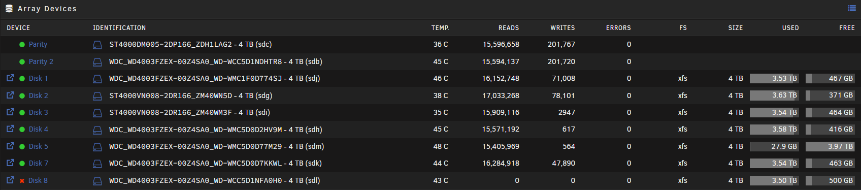

Hello, i am kind of new to troubleshooting on linux based OS's
I have had an unraid box running for about 2 years, with little to no issues, but now my disk 8 in my array keeps being disabled,
The following steps have been tried:
  • New config
  • new controller/cables
  • replaced disk (i only have very used disks, but plan to replace as soon as i can afford it)
  • reformat disk/preclear it
I have tried looking at the logfiles, but i am a little lost to where to find the right ones, and what to look for.
Please help and please let me know how i can make helping easier
Edited by Couch
Solved by Couch
Wish you had asked before doing anything. Most things you tried were the wrong things to do.
Looks like disk 5 is empty or nearly so. Is it supposed to be like that?
Attach Diagnostics to your NEXT post in this thread.
No worries :) it fixed it when i had the issue last, as mentioned all my disks are heavily used and i have plenty of them
Can you elaborate on it being the wrong steps?
Yes, i am nearing my storage cap, and will need to expand soon
Attached is my diagnostics
Thank you for helping :)
hera-diagnostics-20240107-2006.zip
Is disk5 supposed to be nearly empty? And nothing assigned as disk6?
Since you rebooted after disk8 became disabled we can't see anything in syslog about why, but SMART report for disk8 looks mostly OK, except for a large number of UDMA CRC errors, which is probably the reason, a bad connection.
Take a look at your Dashboard page. It should be showing you SMART ( 👎) warnings for several of your disks. Post a screenshot of that.
I have reviewed SMART for each of your array disks. Fortunately all their SMART warnings are UDMA CRC, which indicate bad connections. In particular, disks 5, 7, and 8.
How are these disks powered? Any power splitters involved?
FIrst thing you should do is check all disk connections, SATA and power, both ends, including splitters.
Then reboot, post new diagnostics, and we can continue to work on disk8 as well as a few other problems you have.
Thank you, i will look through these steps tomorrow :)
Okay, i checked connectors and they all seem to be plugged in right, i am using 1 splitter for 2 disks, but they are not the disks with issues
Power-supply is an older used one, so it might have bad connectors
hera-diagnostics-20240109-1029.zip
Attached is the new diagnostics :)
Again thank you for your help and your guidance
Disks 1,2,3,4,7 all mount and have data. Disk5 also mounted but is empty or nearly so. Nothing assigned as disk6. And, disabled/emulated disk8 mounts and has data so that is good.
You didn't answer this question:
Not clear from your initial description whether or not you let parity rebuild when you did New Config, but I assume parity must be valid since disk8 is being emulated just fine.
The contents of emulated disk8 will be the result of rebuilding disk8.
Unraid disables a disk when a write to it fails for any reason. This is because it is no longer in sync with the array. After a disk becomes disabled, it isn't used again until rebuilt (or you force it with New Config).
Instead, Unraid emulates the disk. Any reads of the disabled disk instead read all other disks and get its data from the parity calculation. Any writes to the disabled disk instead update parity as if the disk had been written. The initial failed write, and any subsequent writes to the disabled disk, can be recovered by rebuilding.
If we are reasonably confident everything is working well, usually we will just say rebuild on top of the same disk. But, it might be safer to rebuild to a new disk and keep the original with its existing contents in case of problems rebuilding.
Do you have another disk you can use for rebuilding disk8?
Very sorry
I do not know why disk 5 has been replaced recently, so i had to move stuff away from it temporarily.
Disk 6 missing is on me, i put the disks in 7-8 by mistake, but have not bothered moving them.
Yes i let it rebuild every time there is anything, and it runs parity checks weekly
Yes, i will try rebuilding hopefully over the weekend when i have a bit of time :)
Thank you very much!
