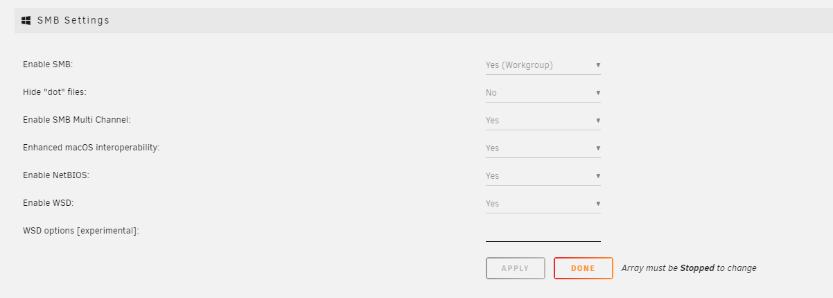

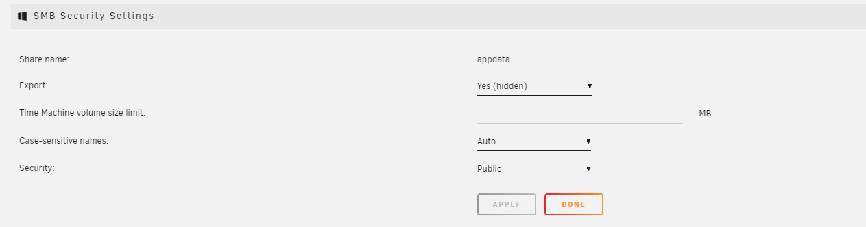

Be sure that the appdata share is enabled for smb:
Under settings samba:
Under SMB extra, you may need to add:
[global]
#Protocols:
    domain master = yes
    preferred master = yes
    os level = 200
    server role = standalone server
#Identification:
    netbios aliases = %hostnameofYourUnriadBoX
    server string = Samba Server Version %v
you should then test to make sure you can access the samba share via \\$IPADDRR\appdata\nginx
The extra setting will make unraid the NetBIOS samba master on the network and in control of the windows wsd name servers for ip access and samba windows sharing...
