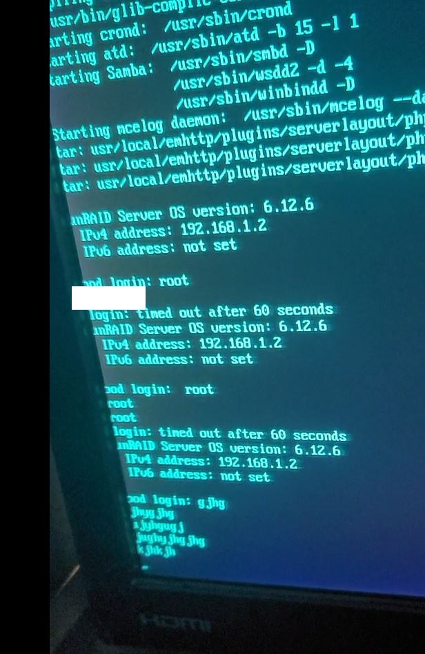

I moved to new hardware, and it seems like it went okay, but I the console won't let me log on.  Hitting "enter" doesn't accept input - it just seems to place a carriage return, and I can keep typing.
I'm not able to connect remotely, or get a ping response from the machine.

I just tried... I get the same behavior.
It appears to start up, but it's not connectable over the network, and the same thing happens where hitting "Enter" just starts a new line.

No... it still didn't seem to recognize the "Enter" and process my input... it just translated to a line-feed still.

I just tried this... the new drive now gives the same behavior, and I can't get it to accept the logon input.

BTW, I've noticed that the images which won't log on, don't shut down, either... they freeze on the "up to 90 seconds..." message, and never move on.
