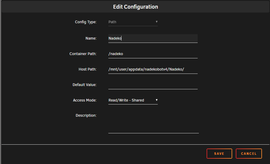

@Yeoubi Not a dumb question at all I had to edit the template a little bit to make that work. I have updated it by default now. Since you already have it you will want to add a add a path to the config
You can do this by editing the container.
Scroll to the bottom and click on Add another path, port, variable, label, or device.
It will be a Path
You can name it what ever I choose nadeko
container path must be /nadeko
Host path can be where ever you'd like the bot information to be saved on your unraid. You will edit the yaml files here
default value can be left blank
access mode I have it as Read/Write - Shared but normal read/write should also work.
Save your path and click Done at the bottom of the edit screen. After it restarts the folder should be populated and let you edit the yaml. For the bot to see the changes it will need restarted. You can do this with the Die command or restarting the container one more time.

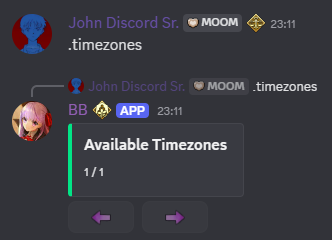

Ran into an issue when upgrading where I can't set the timezone, as the .timezones command returns a null value, shown below:

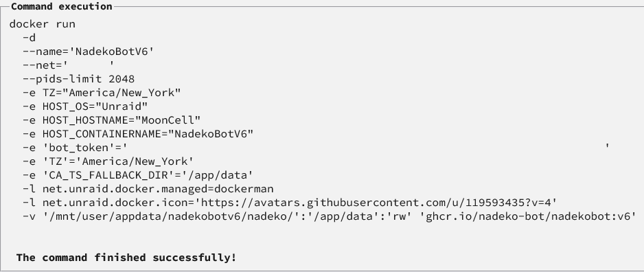

Got some free time myself to try, so I've gone ahead and tested by explicitly stating the TZ variable like you were thinking about doing, and it doesn't seem to change anything on the bot's end.
Don't think I set them up improperly, but here are some screenshots from my attempt:
