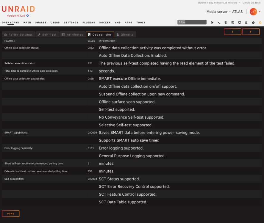

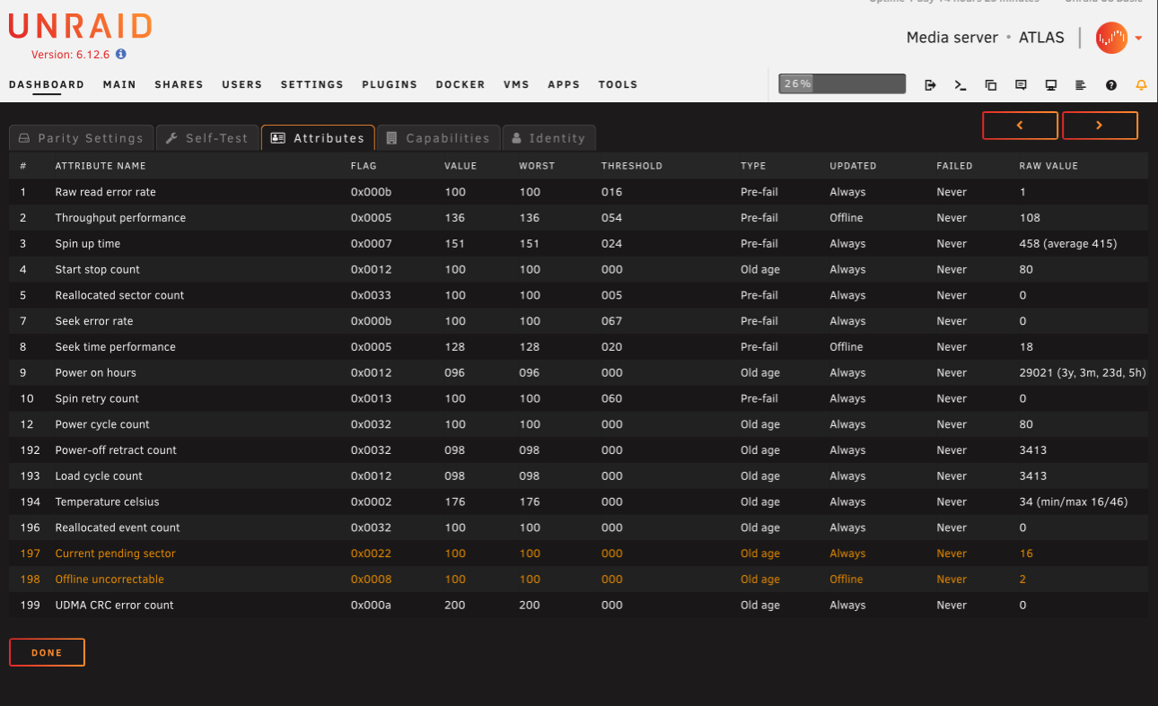

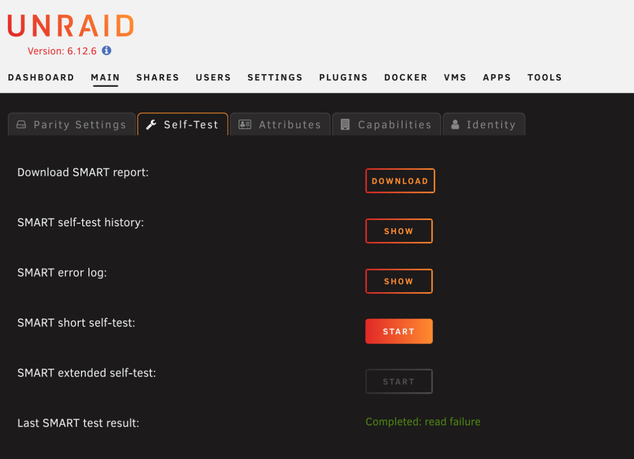

Now that this is fixed, on the parity drive i’m noticing a “read failure” error when performing a SMART check. Could this be related to the original issue by chance or a separate issue entirely.
(Apologies if the attached images are redundant)
Edited by Syzygy
This is just a bad disk, and since it failed the SMART test it should be replaced.
