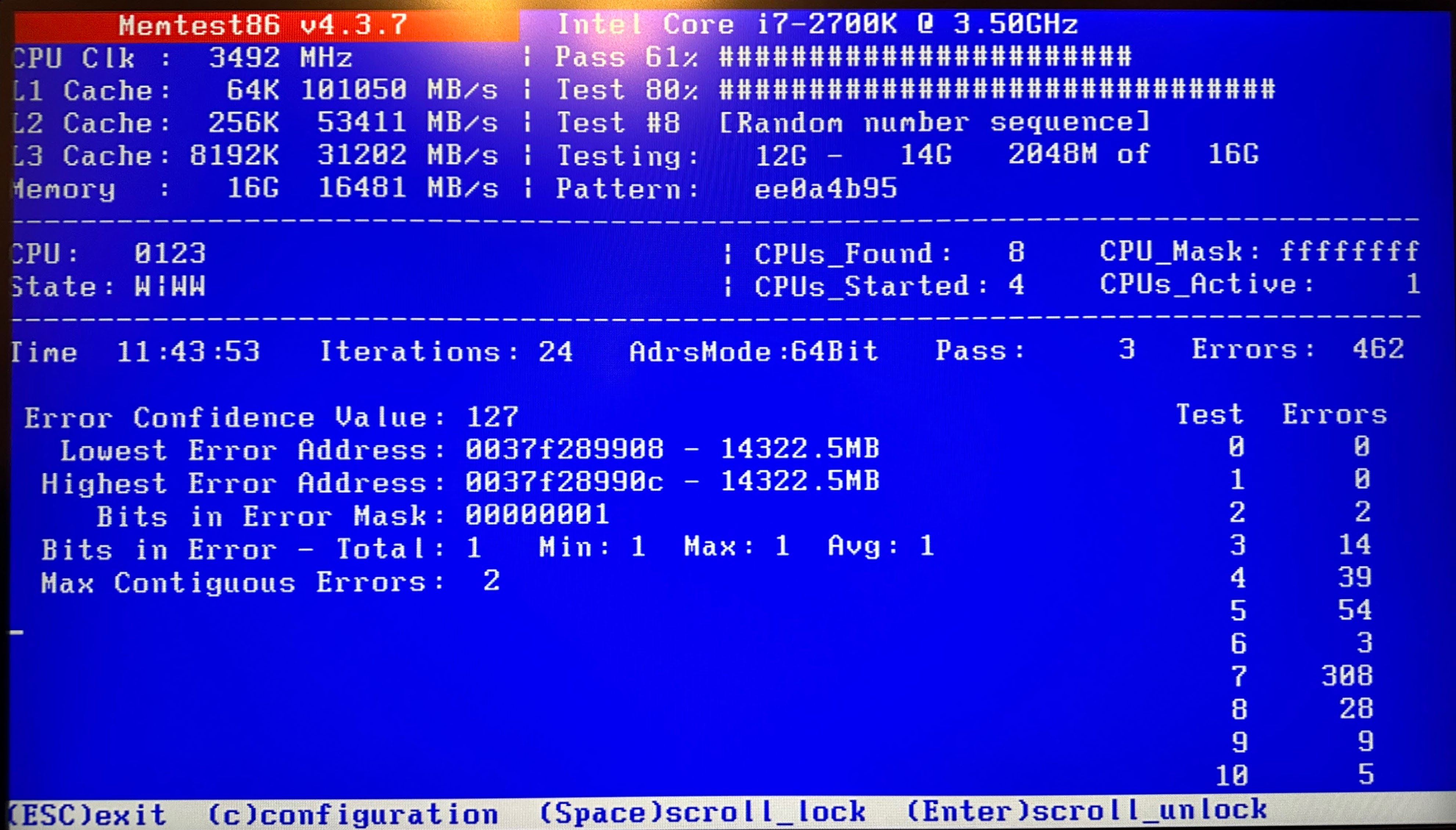

Since btrfs is detecting data corruption I would recommend starting by running memtest.
I believe the recommendation is to run Memtest for a full 24 hours, but given that I am 12 hours in and have already logged 462 errors, I'm suspecting this is enough data to call my dimms bad? Is that that the general consensus? I assume even one error is above a comfortable threshold.
If so, I need to work on tracking down some ram compatible with my motherboard and CPU. I am using older hardware and I am not clear on whether or not ram is still manufactured or available. Are there current recommendations around ram? Is it better/worse to utilize all four slots on the motherboard? If I have been comfortably running 16GB for years, is there any reason to bump to 32GB? If I move from 4 dimms to 2 dimms, is that going to present any sort of issue? I assume the answer to all of these is no, but better to check than be surprised.
Last question, would failing memory explain the drop in cache write speeds I have been observing?
Appreciate everyone's time and thoughts.

1 minute ago, JorgeB said:
That's correct.
Using all 4 slots is usually fine, though 2 can be more stable, especially if the board has an underlying issue.
Much appreciated. I will start to track down some new ram and report back.
Sorry to repeat this: but would failing memory explain the drop in cache write speeds I have been observing? Or is that likely another scenario which I will need to troubleshoot after getting new ram.
Thanks again.
Link to comment
Difficult to say for sure, but bad RAM can cause all sorts of issues, especially with btrfs, so fix that and then retest.
12 hours and error free with the new ram. I'm going to let this run the rest of the day to play it safe.
Assuming I encounter no errors in the next 12-24 hours, what is the recommended next step to troubleshoot my slow cache write performance outlined earlier in the thread? Just go back to normal day-to-day use of the server and see if the issue pops up again?
