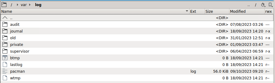

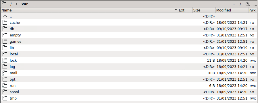

  9. Forgive me if I am missing something painfully obvious, but the new Unbalanced UI is indicating the following: However, when looking through /var/log via Krusader, I am not seeing any log file. The last modified date for /var/log is back in 2023 for me. Appreciate the help!

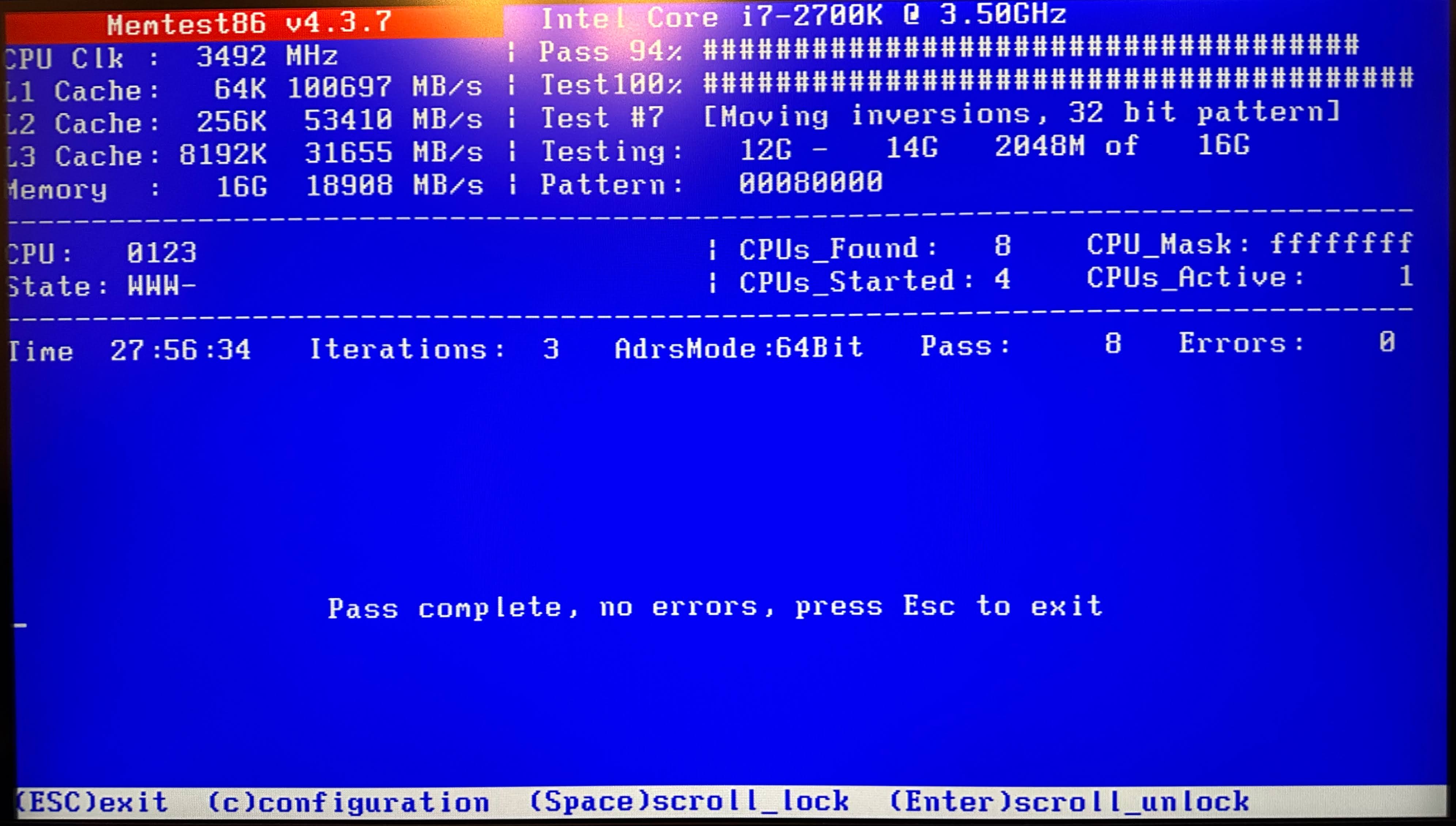

  10. 28 hour MemTest with clean results! Booting back up the server again after several days of downtime. Fingers crossed! Thanks again for all the help.

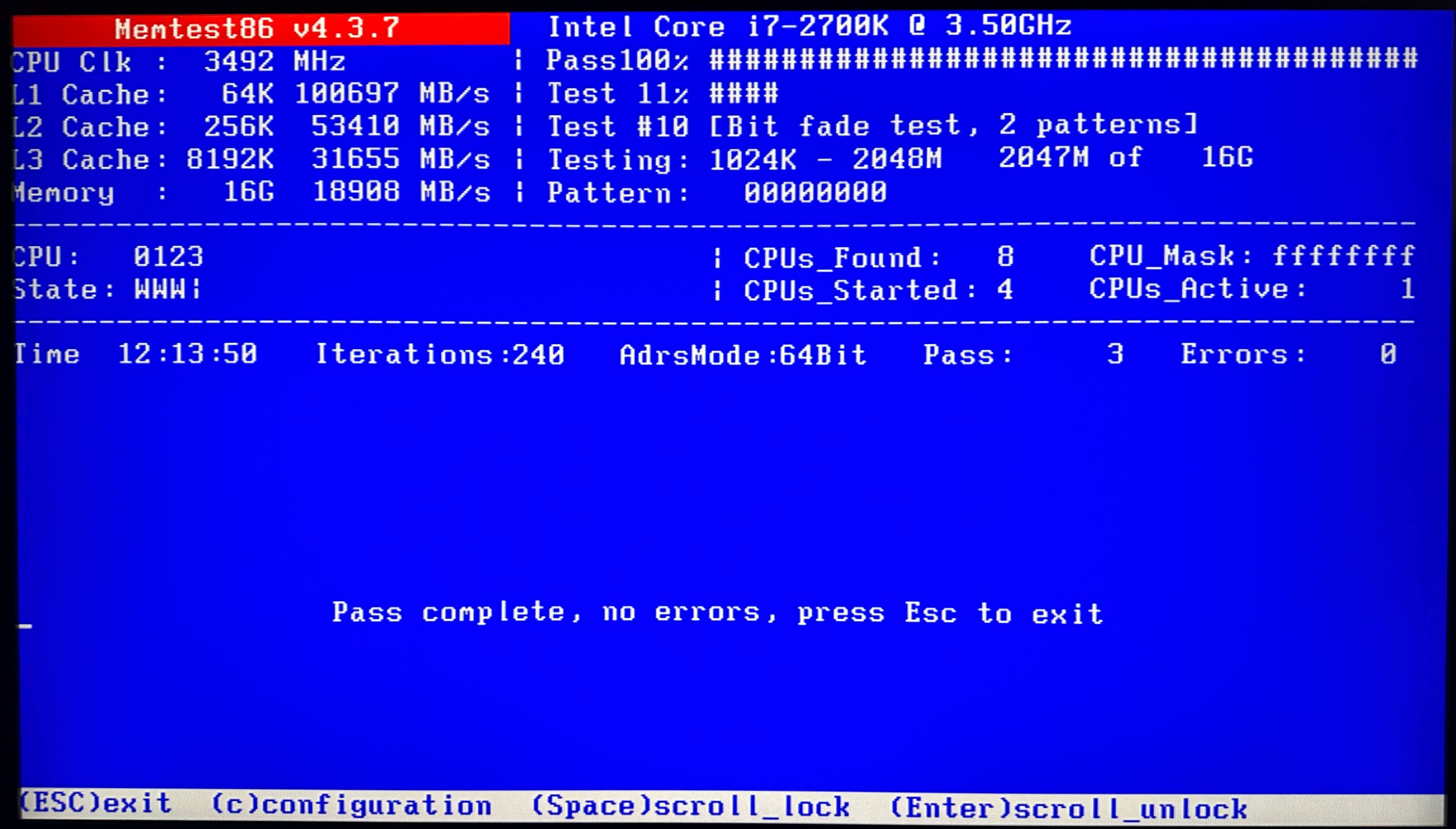

  13. 12 hours and error free with the new ram. I'm going to let this run the rest of the day to play it safe. Assuming I encounter no errors in the next 12-24 hours, what is the recommended next step to troubleshoot my slow cache write performance outlined earlier in the thread? Just go back to normal day-to-day use of the server and see if the issue pops up again? Thank you again for all of the help!
