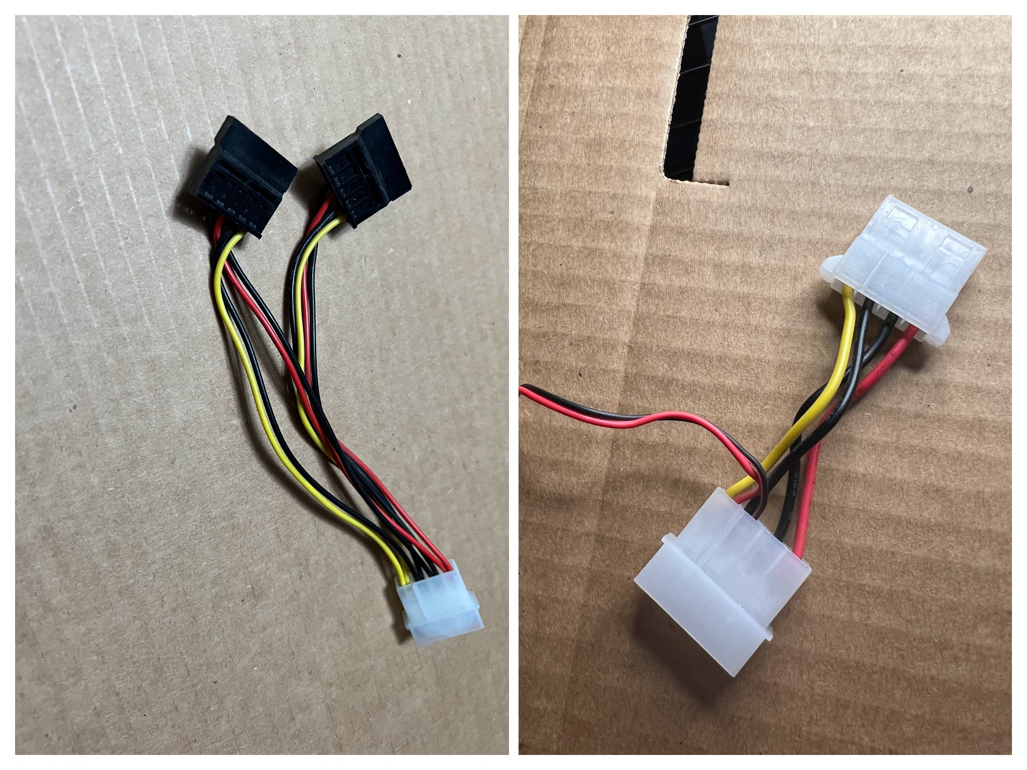

You don't mention power to the disks. Did you also check that? Any splitters involved?

Yes there is a molex to x2 SATA power splitter.  The 5-bay drive cage has two SATA power inputs so it uses both from the splitter.  And between those there was a molex-to-molex with a smaller cable powering a fan.  Stupidly just now I examined this setup while the unRAID was running and the other 3 drives in the drive cage had read errors, so I shut down.  Now that it's shut down I've been examining the power connections and removed that molex-to-molex from the SATA power chain.
