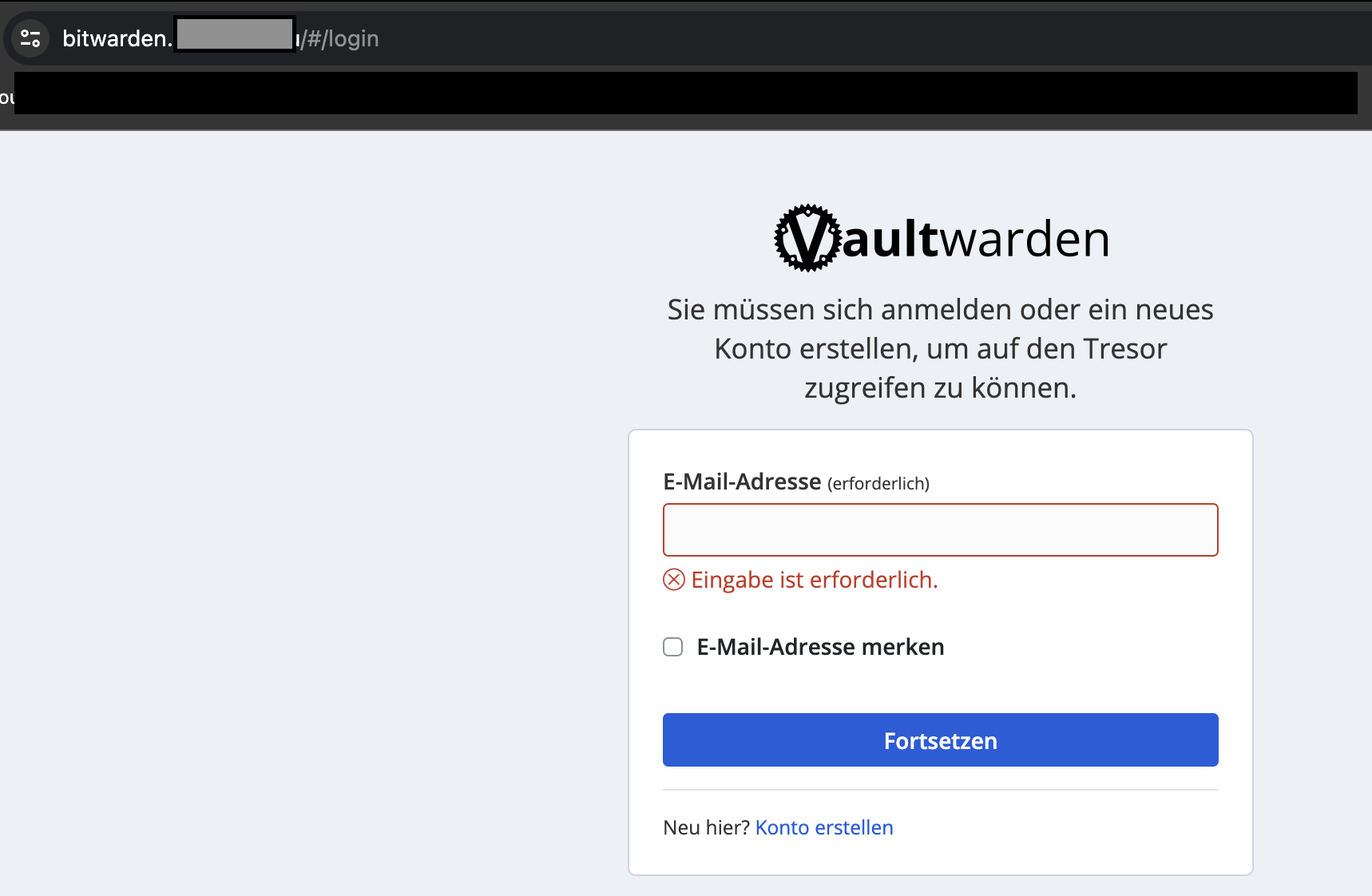

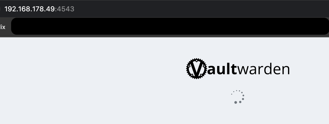

Docker and the containers are running just fine. However, some containers have broken WebUI. If I try to access these containers via IP and port, the WebUI starts and I get stuck in the loading animation of the container (see screenshots). If I try accessing the same container via FQDN (via Nginx Proxy Manager), I just works as intended.
The affected containers are running in a custom network (10.10.10.0/24 , "proxy_net"). Other working containers are running in bridge or host mode. If I try to switch the affected containers to for example bridge mode, they won't work either.
