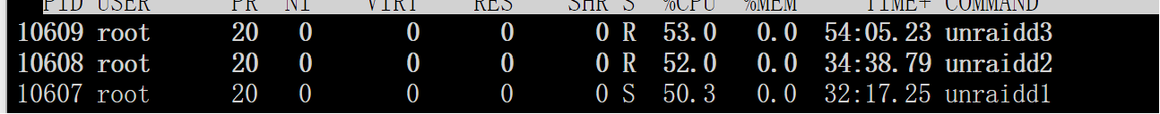

I have 9 disks for zfs format data disk and 2 parity disk for unraid array.When I read data from 9 data disks simultaneously through /mnt/diskx, the overall throughput is very low, only 300M/s, slightly higher than the throughput of a single disk (260M/s). At the same time, I can see that my 32-core 7d12 CPU is almost fully loaded in the background. By using the "top" command, I can see that processes like unraidd1 and unraidd2 are consuming a significant amount of CPU.

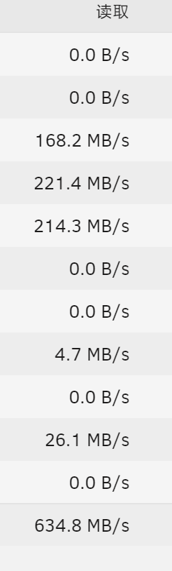

I test three disk,It more faster

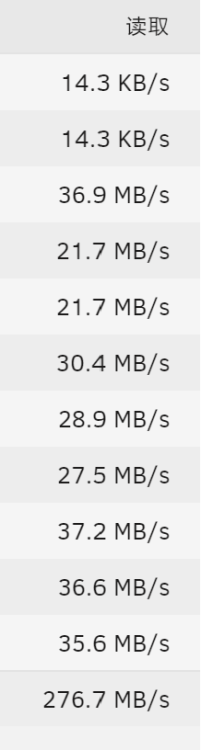

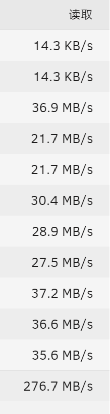

9 disk read:

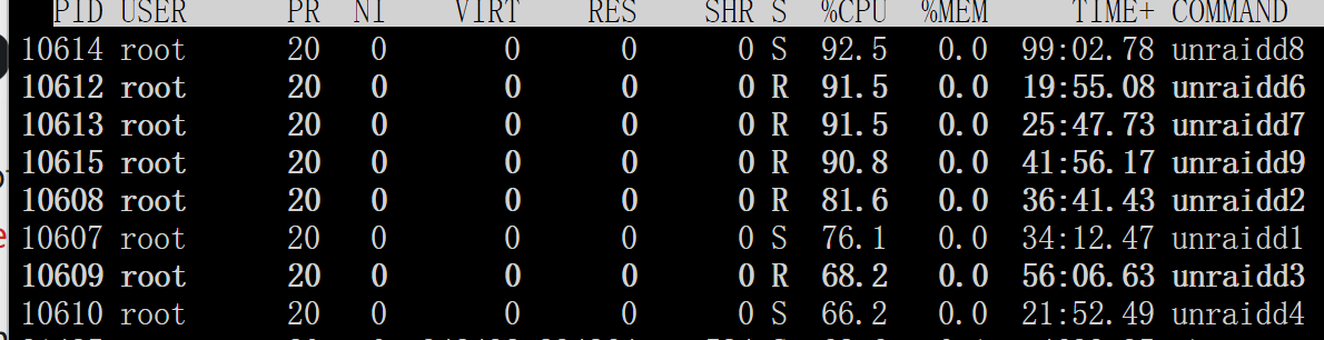

I don't believe that checksum verifications are the main culprit in this situation. Nowadays, even single-core CPUs have computing power measured in GOPS (Giga Operations Per Second), and a data flow of less than 1G/s should not cause significant CPU usage. Additionally, based on the "top" command, it is evident that the CPU-consuming processes are kernel threads of Unraid. It is highly likely that Unraid has assigned a separate kernel thread for each disk to handle IO requests,miuse spin locks make that happen(more disk,slow thorughput,but higher cpu usage.
