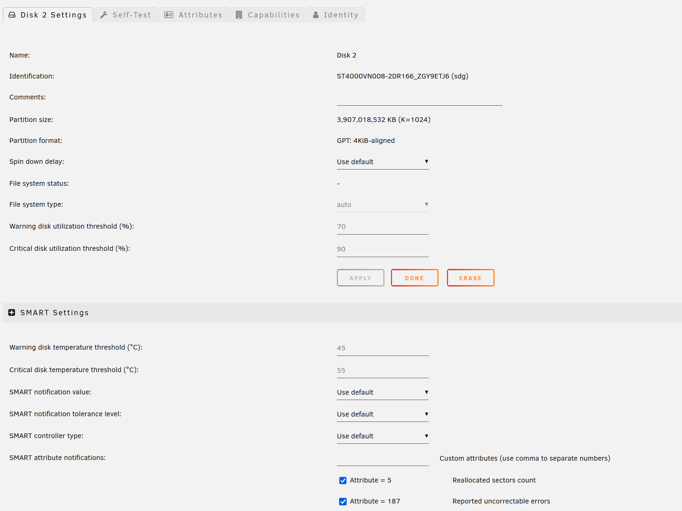

Hmm I don't see any 'Check Filesystem Status' option. I have the array in maintenance mode
It doesn't know what filesystem to use.
I am guessing it was XFS since that is your default. Is that correct?
Yes, it was previously XFS
