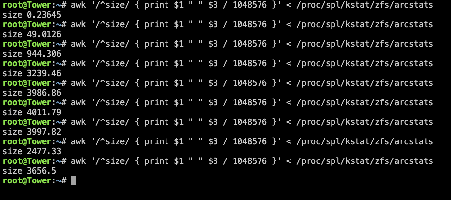

The ARC size should be fixed, at least it is by default, if the main RAM keeps going there may be something else using it, check the current ARC size in GB:
awk '/^size/ { print $1 " " $3 / 1048576 }' < /proc/spl/kstat/zfs/arcstats
After you notice the RAM usage increasing check again to see if it's different.
It seems to reach the max and stay within the original settings from what I can see from that screenshot. Is there a way to determine from that diagnostics report what could be causing the ram increase problem?
Not that I can see, you can try disabling docker and VM services, then enable just the services, test to see if everything is stable, if yes, start enabling the containers and VMs one by one and retest.
Found the issue in the rclone mount. It was running up the ram.
