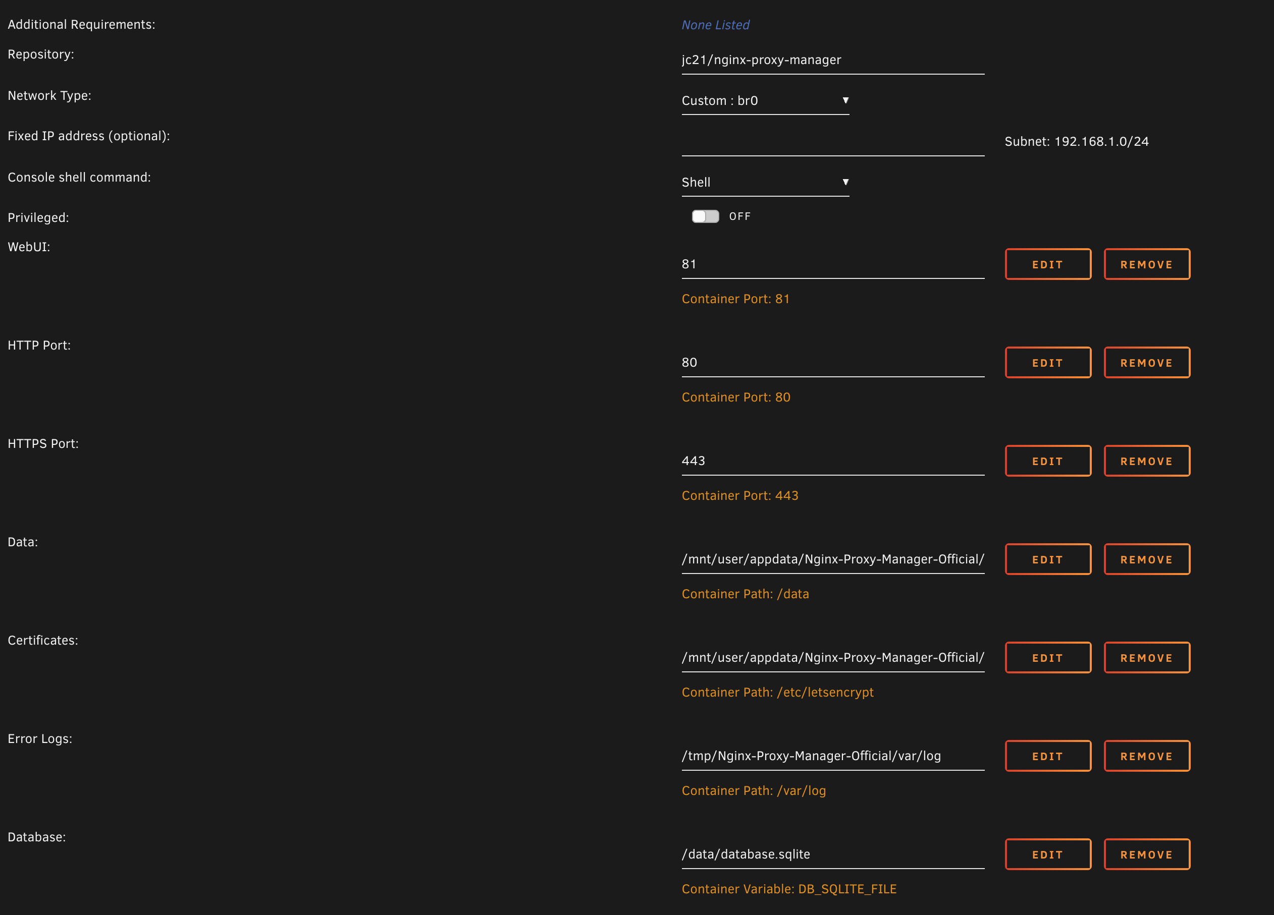

  2. Installed NGINX Proxy Manager with the following settings:384395616_CleanShot2024-02-03at11_07.58@2x.thumb.png.89a98faa823c855bc471e650ca400149.png

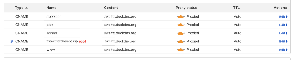

  4. Bought a domain on Cloudflare and set it up as such:1408109932_CleanShot2024-02-03at11_09.32@2x.thumb.png.435ecc1201f44912da27fb794f7a487c.png

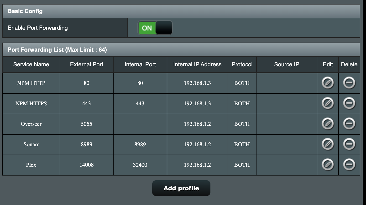

  5. Forwarded all necessary ports on my AX88U router. (I manually changed in Plex's Settings the external port to be 14008 hence the mapping below)859977404_CleanShot2024-02-03at11_11.51@2x.thumb.png.1499451306f3faf91466daf0d1e3810d.png

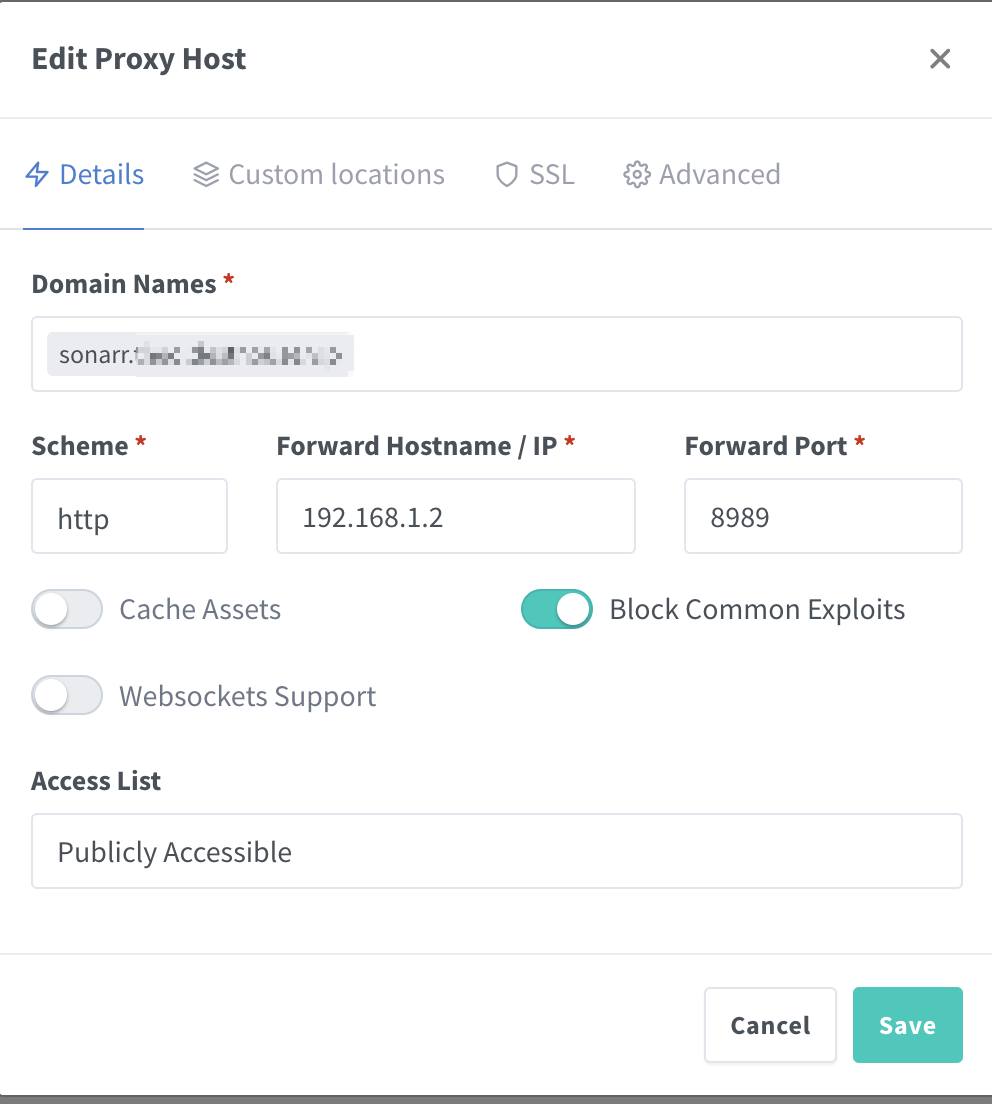

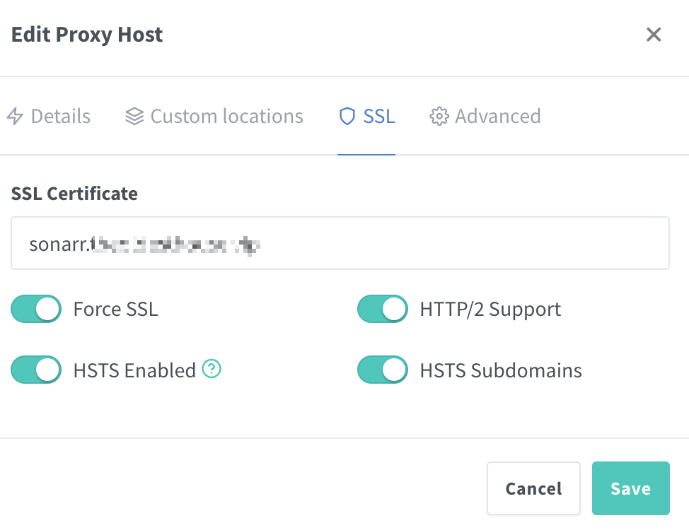

  6. Setup NPM (example of Sonarr)470429375_CleanShot2024-02-03at11_14.40@2x.png.4df071603885a0224995482abbf0f580.png1009559953_CleanShot2024-02-03at11_13.56@2x.thumb.png.a2a03839ca679064240093e1ebb15914.png

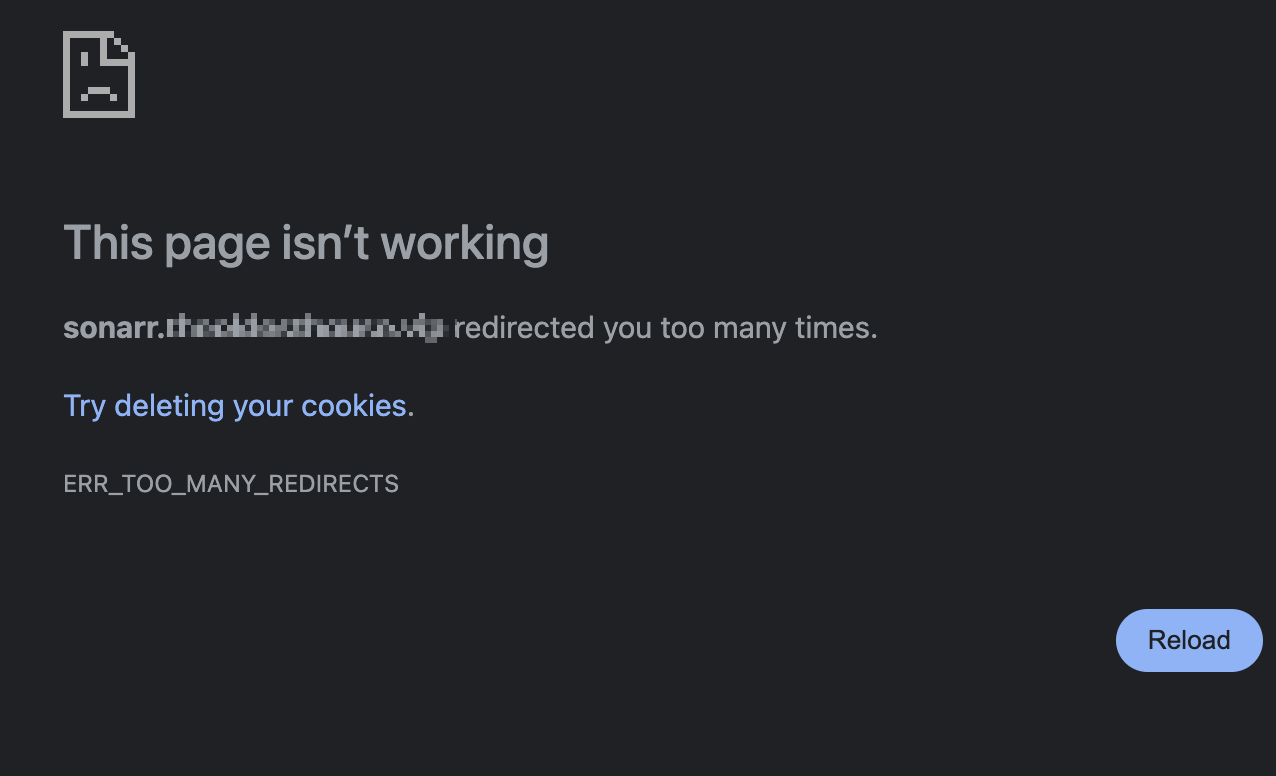

  7. Attempt to connect to sonarr results in:1799554946_CleanShot2024-02-03at11_16.15@2x.thumb.png.eb4f0b17566242a73c378c3eec58f161.png
  8. But, if I attempt to connect to myserver.duckdns.org:8989 it works perfectly. As well as if I connect to my wanip:8989. So the issue is definitely in the latter stage with NGINX PM / Cloudflare.

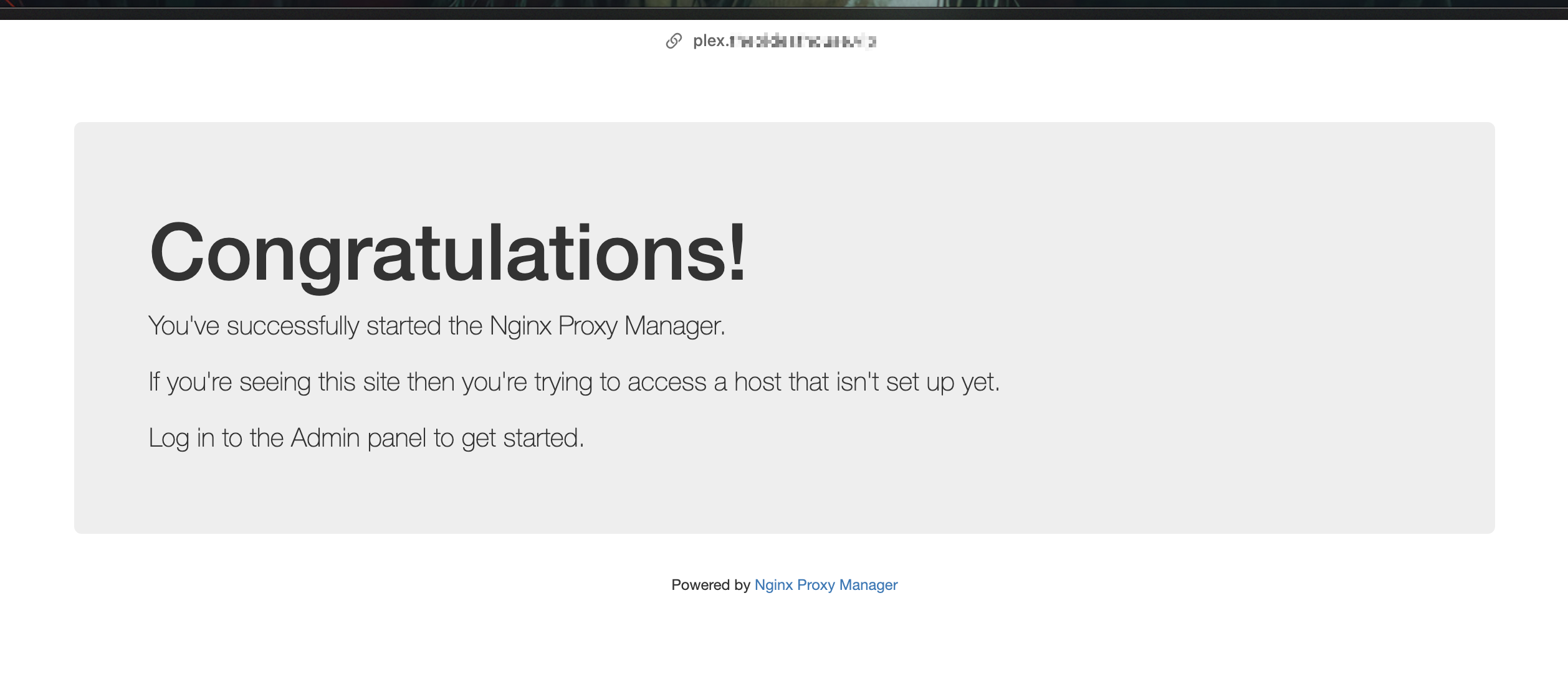

  9. BUT, if I go to the plex one:829755535_CleanShot2024-02-03at11_18.25@2x.thumb.png.1bbbc76ac7b374436be374eb9f62dfda.png
So, for some reason the plex dns leads to the "default page" but anything else just errors out. Any idea on where to go from here?

I wouldn't recommend changing 80 and 443 for unraid.  Change the ports in the NPM docker instead and be sure to forward the rights ones.  I would get rid of duck dns if you bought a domain and use Cloudflare-DDNS by selfhosters.  Use Spaceinvader video here and skip ahead to 9:20 in the video.  You can setup you DNS challenge as cloudflare in NPM.  Also do not forward a port for Overseerr or Sonar that is the whole point of NPM to direct traffic to those containers.  The myserver.duckdns.org:8989 works because you forwarded the port to the gui.  This is not secure.
