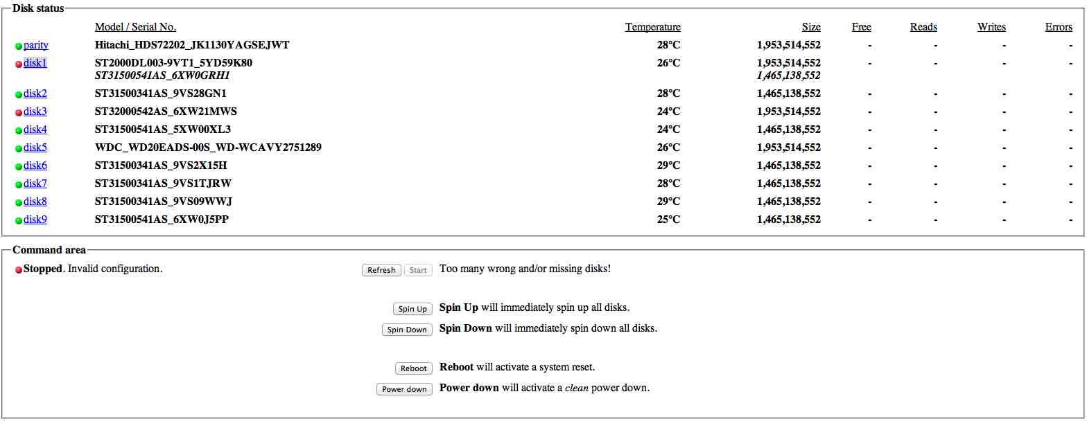

I just saw that I had 2 drives that had several errors (284, 41) and the one with 41 errors was red balled. I stopped the array and started it back up to see if it was something that could be rebuilt itself with a parity check. When it started back up, it showed both of the drives that had errors are now showing "Unformatted". I shut the server down.
I just went and bought 2 replacement drives and was hoping someone could give me an idea on the best way to go about this and keep as much data intact as possible. I'm running 4.7, btw.
Thanks

I read the syslog earlier, and didn't have time to reply..
Redballed means a "write" to the drive failed. They appeared unformatted after the restart because it could not read the partition
Your first clue was back on Sept 18th:
Sep 18 07:43:50 MediaServer kernel: md: parity incorrect: 128  (which you correctly ran a parity check)
then
Sep 24 16:28:51 MediaServer kernel: ata1.00: exception Emask 0x0 SAct 0x0 SErr 0x0 action 0x6 frozen
Sep 24 16:28:51 MediaServer kernel: ata1.00: failed command: CHECK POWER MODE
then
Oct 18 22:18:19 MediaServer kernel: ata6.00: exception Emask 0x0 SAct 0x0 SErr 0x0 action 0x6 frozen
Oct 18 22:18:19 MediaServer kernel: ata6.00: failed command: CHECK POWER MODE
Oct 18 22:18:19 MediaServer kernel: ata6.00: cmd e5/00:00:00:00:00/00:00:00:00:00/00 tag 0
Oct 18 22:18:19 MediaServer kernel:          res 40/00:ff:00:00:00/00:00:00:00:00/50 Emask 0x4 (timeout)
Oct 18 22:18:19 MediaServer kernel: ata6.00: status: { DRDY }
Oct 18 22:18:19 MediaServer kernel: ata6.00: hard resetting link
Oct 18 22:18:19 MediaServer kernel: ata6.01: hard resetting link
Oct 18 22:18:25 MediaServer kernel: ata6.00: link is slow to respond, please be patient (ready=0)
Oct 18 22:18:29 MediaServer kernel: ata6.00: SRST failed (errno=-16)
Oct 18 22:18:29 MediaServer kernel: ata6.00: hard resetting link
Oct 18 22:18:29 MediaServer kernel: ata6.01: hard resetting link
Oct 18 22:18:35 MediaServer kernel: ata6.00: link is slow to respond, please be patient (ready=0)
Oct 18 22:18:39 MediaServer kernel: ata6.00: SRST failed (errno=-16)
Oct 18 22:18:39 MediaServer kernel: ata6.00: hard resetting link
Oct 18 22:18:39 MediaServer kernel: ata6.01: hard resetting link
Oct 18 22:18:45 MediaServer kernel: ata6.00: link is slow to respond, please be patient (ready=0)
Oct 18 22:19:14 MediaServer kernel: ata6.00: SRST failed (errno=-16)
Oct 18 22:19:14 MediaServer kernel: ata6.00: limiting SATA link speed to 1.5 Gbps
Oct 18 22:19:14 MediaServer kernel: ata6.01: limiting SATA link speed to 1.5 Gbps
Oct 18 22:19:14 MediaServer kernel: ata6.00: hard resetting link
Oct 18 22:19:14 MediaServer kernel: ata6.01: hard resetting link
Oct 18 22:19:19 MediaServer kernel: ata6.00: SRST failed (errno=-16)
Oct 18 22:19:19 MediaServer kernel: ata6.00: reset failed, giving up
Oct 18 22:19:19 MediaServer kernel: ata6.00: disabled
Oct 18 22:19:19 MediaServer kernel: ata6.01: disabled
afterwards you get a bunch of I/O and read errors on sdg and sdh...
1.  Check all connections and cables first.
2.  sdg and sdh look dead...but try to run on a smart test on both of those.
Either from unMenu, or telnet/putty
smartctl  -a  -d  ata  /dev/sdX
where "X" is the drive assignment.
(sdg and sdh)
Post the results here.
Likely the system can not find the partition (either due to drive failure or it is looking in the wrong place)
IF the smart test looks ok, type..
3.  for sdg
fdisk -lu /dev/sdg
and for sdh
fdisk -lu /dev/sdh

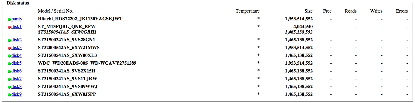

Thanks for looking into it. I finally got around to running this test. Here are the results of the Smart tests:
Linux 2.6.32.9-unRAID.
root@MediaServer:~# smartctl -a -d ata /dev/sdg
smartctl version 5.38 [i486-slackware-linux-gnu] Copyright (C) 2002-8 Bruce Alle
n
Home page is http://smartmontools.sourceforge.net/
=== START OF INFORMATION SECTION ===
Device Model:     ST_M13FQBL
Serial Number:    QNR_BFW
Firmware Version: 04240957
User Capacity:    4,142,054,400 bytes
Device is:        Not in smartctl database [for details use: -P showall]
ATA Version is:   6
ATA Standard is:  ATA/ATAPI-6 T13 1410D revision 2
Local Time is:    Thu Oct 27 22:27:48 2011 Local time zone must be set--see zic
m
SMART support is: Available - device has SMART capability.
SMART support is: Enabled
SMART Disabled. Use option -s with argument 'on' to enable it.
root@MediaServer:~# smartctl -s on /dev/sdg
n
=== START OF ENABLE/DISABLE COMMANDS SECTION ===
Error SMART Enable failed
Smartctl: SMART Enable Failed.
A mandatory SMART command failed: exiting. To continue, add one or more '-T perm
issive' options.
root@MediaServer:~# smartctl -a -d ata /dev/sdh
n
Device Model:     ST32000542AS
Serial Number:    6XW21MWS
Firmware Version: CC95
User Capacity:    2,000,398,934,016 bytes
ATA Version is:   8
ATA Standard is:  ATA-8-ACS revision 4
Local Time is:    Thu Oct 27 22:30:48 2011 Local time zone must be set--see zic
m
=== START OF READ SMART DATA SECTION ===
SMART overall-health self-assessment test result: PASSED
General SMART Values:
Offline data collection status:  (0x82) Offline data collection activity
                                        was completed without error.
                                        Auto Offline Data Collection: Enabled.
Self-test execution status:      (   0) The previous self-test routine completed
                                        without error or no self-test has ever
                                        been run.
Total time to complete Offline
data collection:                 ( 633) seconds.
capabilities:                    (0x7b) SMART execute Offline immediate.
                                        Auto Offline data collection on/off supp
ort.
                                        Suspend Offline collection upon new
                                        command.
                                        Offline surface scan supported.
                                        Self-test supported.
                                        Conveyance Self-test supported.
                                        Selective Self-test supported.
SMART capabilities:            (0x0003) Saves SMART data before entering
                                        power-saving mode.
                                        Supports SMART auto save timer.
Error logging capability:        (0x01) Error logging supported.
                                        General Purpose Logging supported.
Short self-test routine
recommended polling time:        (   1) minutes.
Extended self-test routine
recommended polling time:        ( 255) minutes.
Conveyance self-test routine
recommended polling time:        (   2) minutes.
SCT capabilities:              (0x103f) SCT Status supported.
                                        SCT Feature Control supported.
                                        SCT Data Table supported.
SMART Attributes Data Structure revision number: 10
Vendor Specific SMART Attributes with Thresholds:
ID# ATTRIBUTE_NAME          FLAG     VALUE WORST THRESH TYPE      UPDATED  WHEN_
FAILED RAW_VALUE
  1 Raw_Read_Error_Rate     0x000f   114   100   006    Pre-fail  Always       -
       60598630
  3 Spin_Up_Time            0x0003   100   100   000    Pre-fail  Always       -
       0
  4 Start_Stop_Count        0x0032   037   037   020    Old_age   Always       -
       65535
  5 Reallocated_Sector_Ct   0x0033   100   100   036    Pre-fail  Always       -
       0
  7 Seek_Error_Rate         0x000f   069   060   030    Pre-fail  Always       -
       8923044
  9 Power_On_Hours          0x0032   094   094   000    Old_age   Always       -
       5625
10 Spin_Retry_Count        0x0013   100   100   097    Pre-fail  Always       -
       0
12 Power_Cycle_Count       0x0032   100   100   020    Old_age   Always       -
       24
183 Unknown_Attribute       0x0032   099   099   000    Old_age   Always       -
       1
184 Unknown_Attribute       0x0032   100   100   099    Old_age   Always       -
       0
187 Reported_Uncorrect      0x0032   100   100   000    Old_age   Always       -
       0
188 Unknown_Attribute       0x0032   100   100   000    Old_age   Always       -
       0
189 High_Fly_Writes         0x003a   100   100   000    Old_age   Always       -
       0
190 Airflow_Temperature_Cel 0x0022   076   070   045    Old_age   Always       -
       24 (Lifetime Min/Max 23/24)
194 Temperature_Celsius     0x0022   024   040   000    Old_age   Always       -
       24 (0 17 0 0)
195 Hardware_ECC_Recovered  0x001a   042   033   000    Old_age   Always       -
       60598630
197 Current_Pending_Sector  0x0012   100   100   000    Old_age   Always       -
       0
198 Offline_Uncorrectable   0x0010   100   100   000    Old_age   Offline      -
       0
199 UDMA_CRC_Error_Count    0x003e   200   200   000    Old_age   Always       -
       0
240 Head_Flying_Hours       0x0000   100   253   000    Old_age   Offline      -
       72675141617283
241 Unknown_Attribute       0x0000   100   253   000    Old_age   Offline      -
       51833439
242 Unknown_Attribute       0x0000   100   253   000    Old_age   Offline      -
       3573286947
SMART Error Log Version: 1
No Errors Logged
SMART Self-test log structure revision number 1
Num  Test_Description    Status                  Remaining  LifeTime(hours)  LBA
_of_first_error
# 1  Short offline       Completed without error       00%      5625         -
SMART Selective self-test log data structure revision number 1
SPAN  MIN_LBA  MAX_LBA  CURRENT_TEST_STATUS
    1        0        0  Not_testing
    2        0        0  Not_testing
    3        0        0  Not_testing
    4        0        0  Not_testing
    5        0        0  Not_testing
Selective self-test flags (0x0):
  After scanning selected spans, do NOT read-scan remainder of disk.
If Selective self-test is pending on power-up, resume after 0 minute delay.
root@MediaServer:~# fdisk -lu /dev/sdh
Disk /dev/sdh: 2000.3 GB, 2000398934016 bytes

Neither one shows as unformatted now, but sdg shows an odd size display.
4,044,940
1,465,138,552
Both are still redballed.
Screenshot attached.
I've never seen that before.  Maybe someone else can chime in with thoughts.
Post another syslog, maybe that will provide a clue; and yes, the latest smart test looked ok.

The new drive is installed, but I bring up the control panel and it doesn't really give me any options. I have "Too many wrong or missing disks!"
I've attached the syslog and a screenshot of the control panel. Any ideas?
Thanks
syslog-20111105-222639.zip
What happened to disk ST31500541AS_6XW0GRH1?
That is the new drive. I'm at a complete loss  :(
The new drive is smaller than the old drive. You must use at least the same size drive as a replacement.
Actually, it's bigger. The new drive is 2TB, the old one was 1.5TB. If you look at one of my previous screenshots, you will see the same odd reading on the old drive.
So ST31500541AS_6XW0GRH1 is the old drive? You cannot replace a failed drive when two are red.
Yes, that is referring to the old drive, but it has been replaced. The line above it is the new drive size, I'm assuming.
This has been my issue from the start. I'm not sure what I'm supposed to do if they are both red. So, if I cannot replace a failed drive when two are red, then does that mean my entire raid is toast? I thought I read somewhere that if two drives fail, you may lose the data on those two drives. It does appear that one of the red ones is functional, but was taken offline. Is there a way I can "repair" and bring the functional one back online, then rebuild the failed drive?
As a last resort, what if I removed the failed drive from the array altogether? I would obviously lose the data on that drive, but maybe it would rebuild the functional one?
