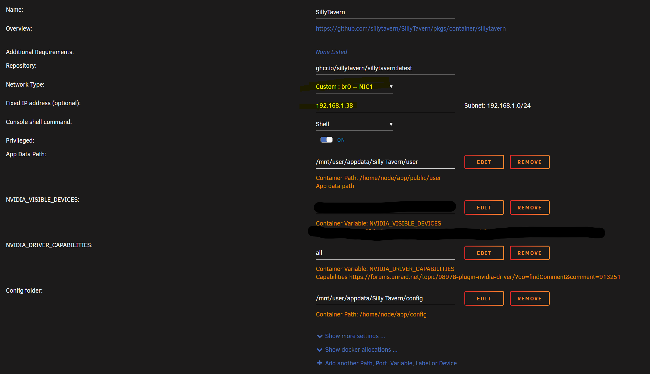

THought I would share the answer as I needed to play to get it working...
if you are going to use NVIDIA dont forget the runtime=nvidea setting for extra parameters
The network can be bridge setting I choose to use br0
Important thing is to get to the files which are in config and user.
Because I used sillytavern on the desktop initially I know what files to edit or where to add various bits.
(I would recommend doing this to get familiar with sillytavern files and setup)
Hope it helps someone, because it took me a few hours to work it all out reading the docker files!

Thanks for this post, I try mimic your layout and settings couldn't get pass to start the docker.
Here my logs:
# -- SERVER PLUGIN CONFIGURATION --
enableServerPlugins: false
The listen parameter is set to false. If you can't connect to the server, edit the "docker/config/config.yaml" file and restart the container.
The whitelistMode parameter is set to true. If you can't connect to the server, edit the "docker/config/config.yaml" file and restart the container.
Here my logs:
You'll need to edit your /mnt/user/appdata/Silly Tavern/config/config.yaml
changing:
listen: true
whitelistMode: false
securityOverride: true
Edited by brainbone_
