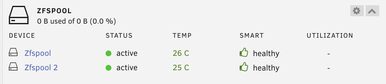

one drive in my zfs pool of 3 devices failed. And before I could change it my pool was gone and I'm not sure what to do now.
zpool list
only returns
no pools available
But the UI does list them as. The file system status says: "Unmountable: Unsupported or no file system"
2056614681_Screenshot2024-02-05at14_56_25.thumb.png.411aee108948b7115dc35c6ec2600ed1.png

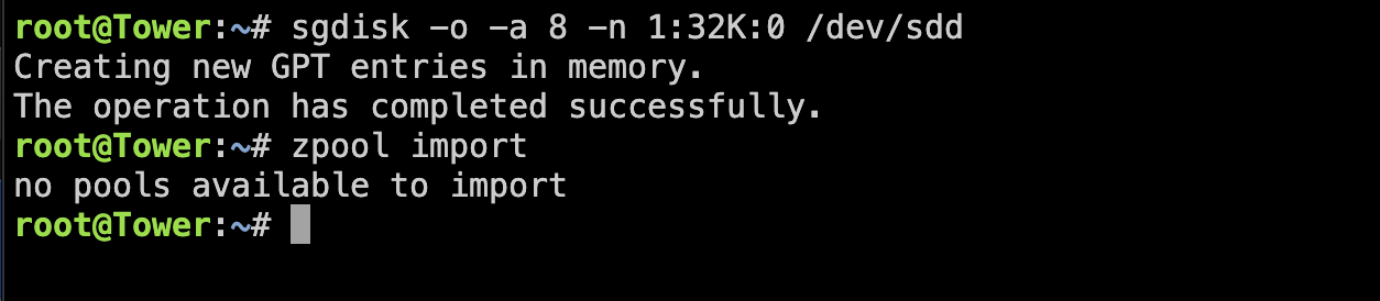

At least two of the devices were wiped by you when trying different things, if you didn't reboot since the last diags, type:
sgdisk -o -a 8 -n 1:32K:0 /dev/sdd
And then post the output of
zpool import
I didn't reboot. This is the result
2042696772_Screenshot2024-02-05at17_45_56.thumb.png.dd6501cbb371544e347e46945536fca0.png
/dev/sdd is the faulty drive.

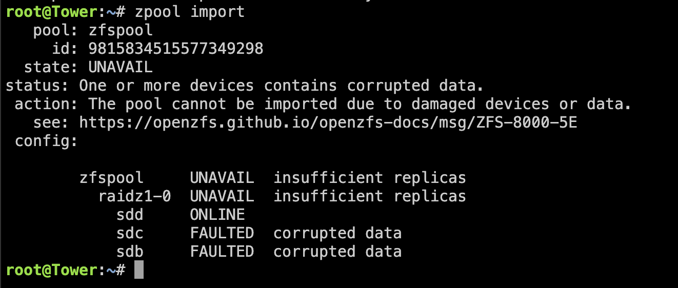

Ok something happened at least. I'm slightly positiv now 😃
916756386_Screenshot2024-02-05at19_51_59.thumb.png.bc9f9355da4260792429e16d92bca1d6.png
Although it reports sdb and sdc as "FAULTY" and sdd as "ONLINE" even though sdd should be the broken on
Unfortunately only sdd is showing up online, do you remember if your were using raidz or something else?
I'm pretty sure it was raidz.
I have 3 4TB drives and the total capacity was slightly below 8TB if I recover correctly.
OK, so with two faulted disks it's not possible to recover the pool, I'm afraid you will need to re-create it.

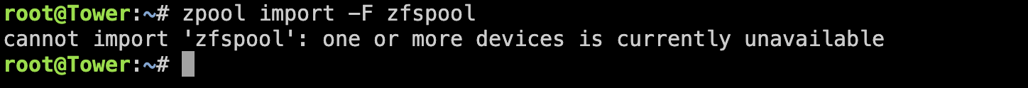

You can try some options with zfs import to see if the pool can still be imported, possibly by losing some of the last transactions, first try:
zpool import -F zfspool
Ok, it wouldn't be that bad if I loose some data, as long as not all of it is gone.
But this options only give me this

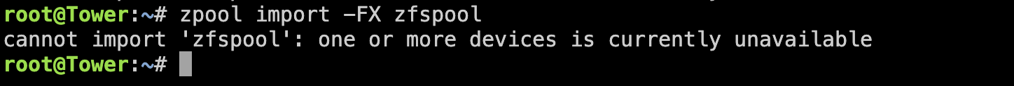

Now try
zpool import -FX zfspool
Same result, unfortunately
