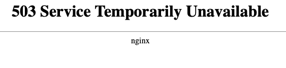

Most of the time I login I get this one:
After several refreshes, and plugging user/pass, I get inn. This time I had this:
This came up because I plugged the other server password.
I can't add any diagnostics as of now. But how to fix the first issue? The second as well as guess.
The 503 issue as also on my other server.
Cheers,
Frode

OK. I will test this during the coming days. What it seems to me, is that the nginx is restarting. If I wait a 20-40 sec., I usually can log in.
