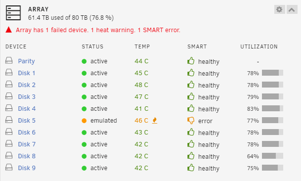

Device is disabled. contents emulated
I have been getting slow response for a while when accessing certain items. but i now have a failed disk apparently.
I read some other posts here before doing anything so i have not restarted the machine yet. Diagnostics attached. if it is possible for someone to educate me on how to read these if thats possible.

There are constant ATA errors for disk1 and the disabled disk, check/replace cables (including power) and post new diags after array start.
ok, i will need to order a new minisas to sata cable.
so before i checked everything the array was saying device disabled contents emulated. now it just says disk empty.
Have i lost my data?
Edit. nvm i disconnected the disk and stopped the array i can see the error saying content emulated now.
I am rebuilding with a new disc. this one seems to be the issue.
i may do the same with disk 1 also as you mentioned that was showing disconnection errors.
Edited by Driden
Emulated disk5 has plenty of data, rebuilding looks fine so far.
Don't see any reason to rebuild disk1 if that's what you mean.
Do any of your disks show SMART warning ( 👎 ) on the Dashboard page?
i just meant about rebuilding disk 5 not disk 1. i think the disk 1 errors might have been a bad sata cable.
the only one that shows an error is the disk 5. is that the new one? or left over data from the old one?
It would be the new disk, post new diags.
