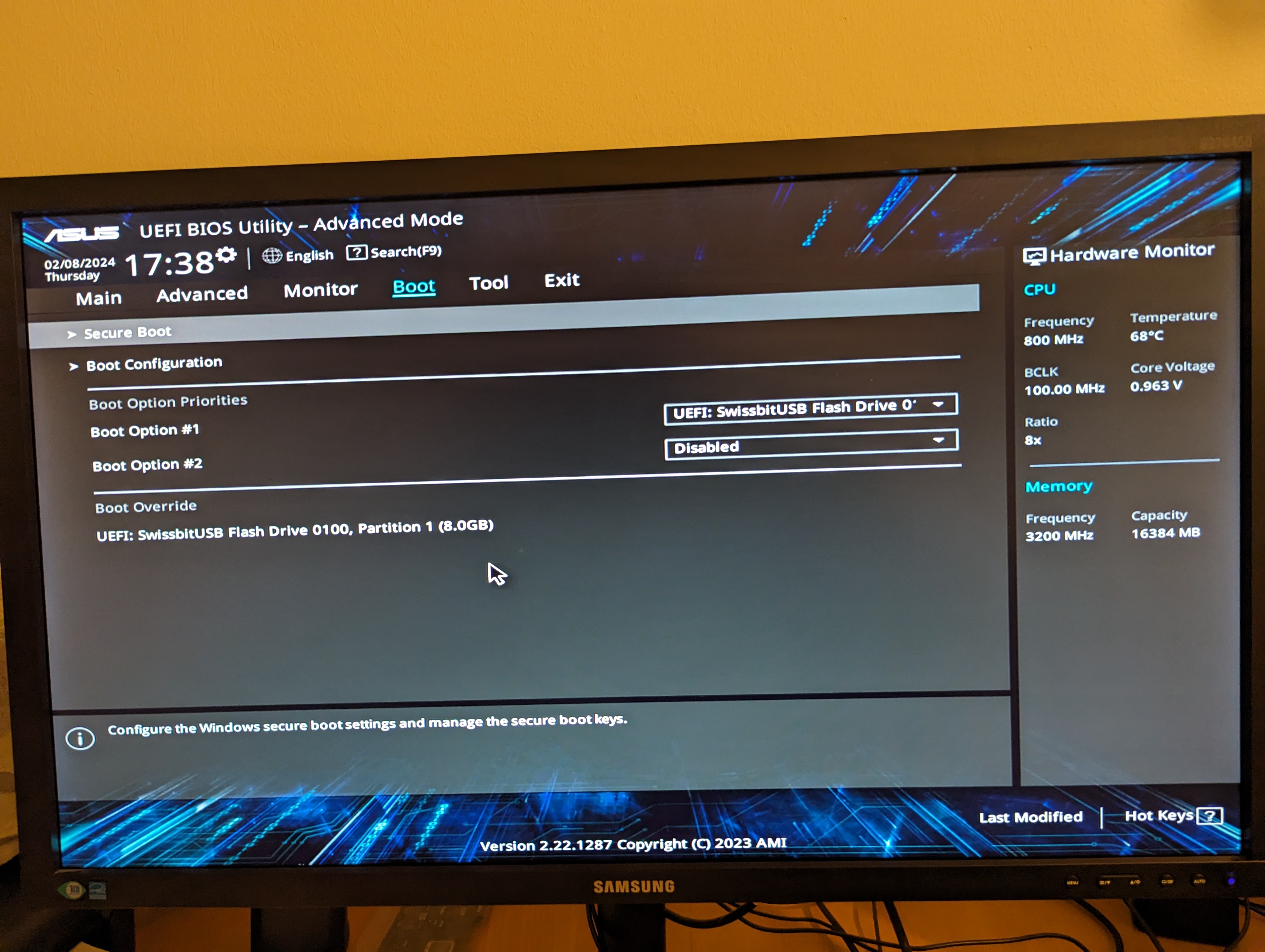

Since you know the flash drive is good it suggests a BIOS issue, make sure fast boot and Secure boot are disabled, also post a photo of the BIOS boot menu, with Asus you usually need to press F8.
I disabled fast boot and secure boot.

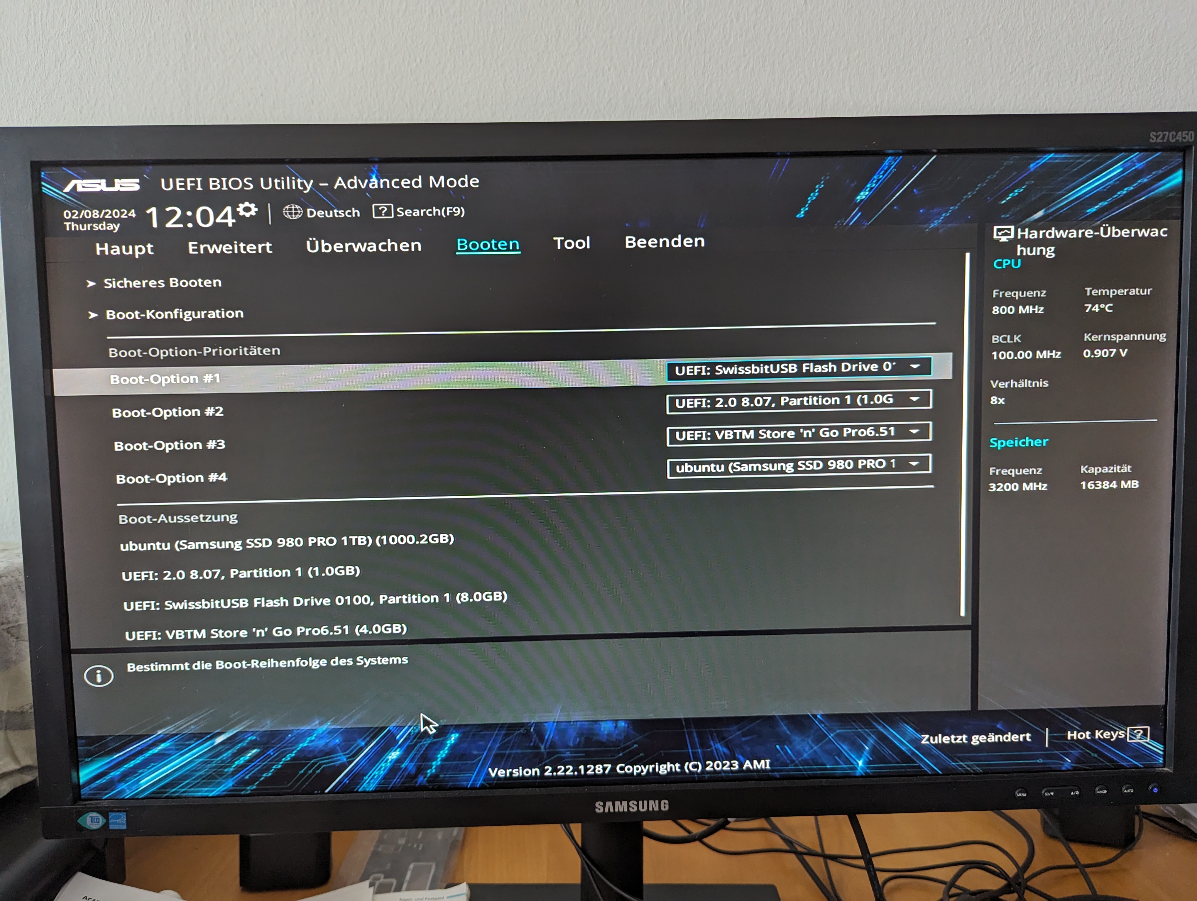

in picture 1 all devices are seen ( swissbit manualy installed, works on an old dell laptop but not on this asus barebone PN42; second usb stick , installed with unraid installer, 3.VBTM has a clonezilla live system , which works on the asus barebone PN42 when the first 2 sticks don't . 4 ubuntu SSD  (working)PXL_20240208_120416687.thumb.jpg.d669c0391ce61fb76f73d10463cb5b21.jpg

Select the Unraid flash drive in Boot Override, I assume it's the SwissbitUSB?
If UEFI boot is enabled in the flash drive (an EFI folder must exist, not EFI-), and it boots UEFI on a different PC and still doesn't on that one I'm sorry but I don't have more ideas.
yes it the swissbitUSB  I would like to use;

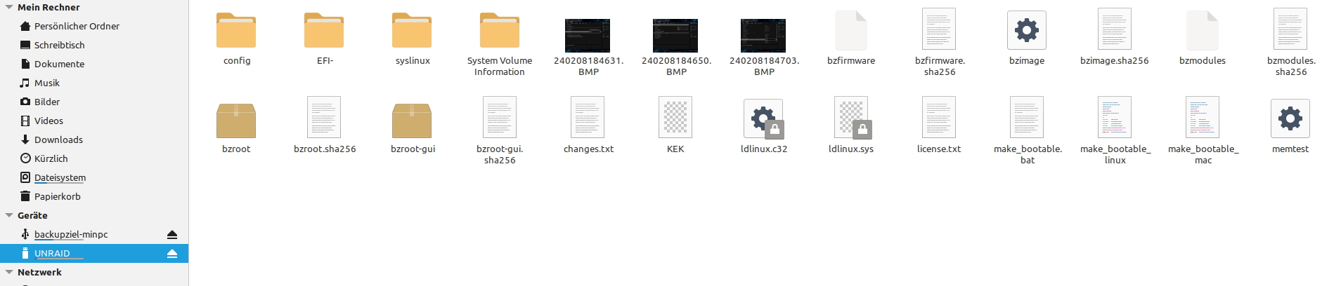

on this I see an EFI- folder not EFI??. I used the  zip file from the unraid page, extracted it to the Usb Stick, ran the make bootable bat. what else could i do (better)?
If you have an EFI- folder on the flash drive then you need to rename it to remove the trailing - character for UEFI boot to work.
I did the renaming and the issue is solved. THANK you all for your patience and quick help.
Remark: the EFI- comes with the unRAIDServer-6.12.6-x86_64.zip file. maybe it is worthwile to check?
That is expected.  When you run the make_bootable.bat file it should have asked if you want UEFI booting and if you said you did it would rename that folder.
