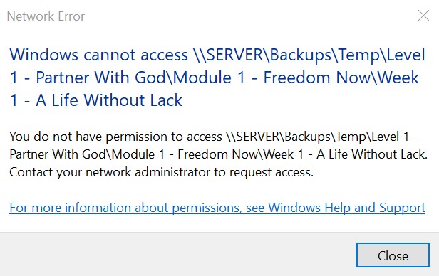

I made the changes, set up a new Read/Write user in the UnRAID Web GUI, and put the credentials into her windows credential manager, and then rebooted both her PC, and the UnRAID server (just to be sure). In testing, I was able to log onto the server OK, and go down several folder levels to try the folders she'd had permission issues with before. The issues are still there. In the third sub-directory down from the share there's a further set of folders all at the same level - (Week 1, Week 2, Week 3, Week 4, Week 5, plus a few random files - see the attached screen-shots).
The issue is - using the correctly set up user, she can open the Week 3, Week 4, Week 5 folders just fine, but if she tries to open the Week 1 or Week 2 folders, she gets a 'You do not have permission' Windows message. I didn't think that was possible - you either have access to a share or you don't. I didn't think you could set individual sub-folder permissions.

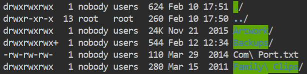

I used the GUI terminal as per your instructions, and got a listing of all the shares in the format shown in your example. FWIW the share with the issue is 'Backups'. Here's a look at the top level...
Note the "+" symbol on the end of the permissions column for the Backups share. I don't know what that symbol means, but it's the only share that has it. Going in deeper I can now see the permissions values for the different week sub-folders...

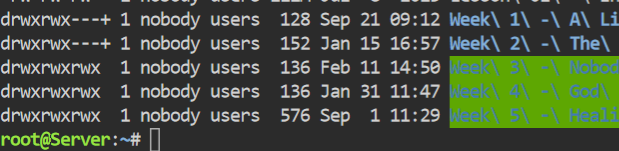

Note the permissions for 'Week 1' and 'Week 2' are VERY different from those for weeks 3-5, AND the Week 1 and Week 2 folders ALSO have the '+' symbol on the end of the permissions column. The other week folders don't have that.
This looks to me to at least point to what's causing this issue. It would be nice to understand what the '+' symbol means, and then the only thing left to fix the issue is altering/correcting the permissions for these folders.

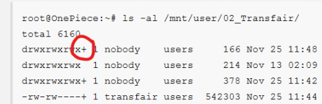

Recently, something has come to my attention about Unraid and SMB. There have been incidences where access to Unraid shares is restricted or blocked completely from users who should have access to it. What has been found in these cases is that a feature, has been enable on the Unraid side, called Access Control Lists (ACL for short). This will show up as an ‘+’ at the end of the Linux permissions. See the screen capture below:
Note that the ‘+’ is also on the file as well as the share/directory.   ACL changes the way that Linux is going to control access to these resources. After some research, I found out that Windows has used ACL for a long time.  The SAMBA group has added ACL into its version of SMB.  Unraid does not use ACL in its security scheme.
At the present time, I can think of only one way that a ACL could be found on any Unraid server. It was done by a Windows user who was trying to change how SMB worked by applying Windows security features to an Unraid share by changing the default Security settings. (Basically, right-clicking on the Share in Windows Explorer, selecting ‘Properties’, then the ‘Security’ tab and working from there.)
