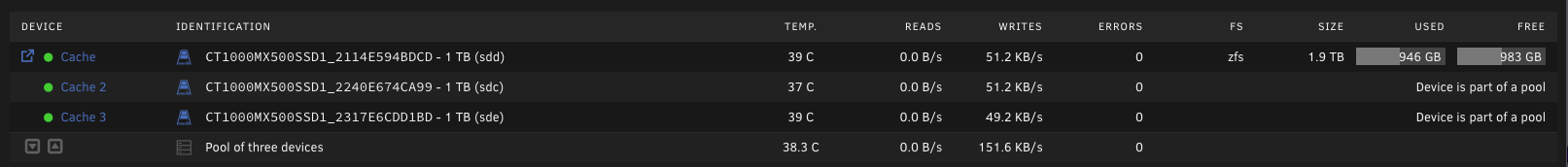

On my unraid server, i have this cache pool :
707912581_Capturedecran2024-02-11a18_33_52.thumb.png.b9a5c2e2e31344de6b313beb9195621d.png
It is 3x 1TB drives, with one mirror, for a total of 1.9 Tb useable capacity.

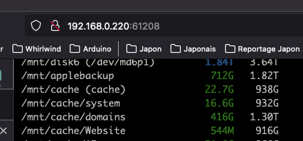

On the unraid console, when i do :
df -h
I have this output :

The "cache" is reported to be 939GB with only 23Gb used.
I dont really understand this value.
Is it because of ZFS ?

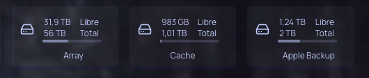

I use Glances (with Homepage), and i can't show the correct size of the cache pool :
It seems to be reported as the df command line.
Really not a big deal, but maybe i can use this to learn something more.

Because it's by dataset, look st the datasets and add them all, just domains dataset is using 417G, and note that those use GiB, GUI uses GB.

But why the main one (cache) did not report the full size of the pool array ?
It seems to only report one drive of the three.
That is more that i did not understand.
Because as far as df can see there's no data there, data is inside the datasets, and datasets are separate zfs filesystems, for example if you try to move some data from one dataset to another a full copy will be done, instead of a move.
