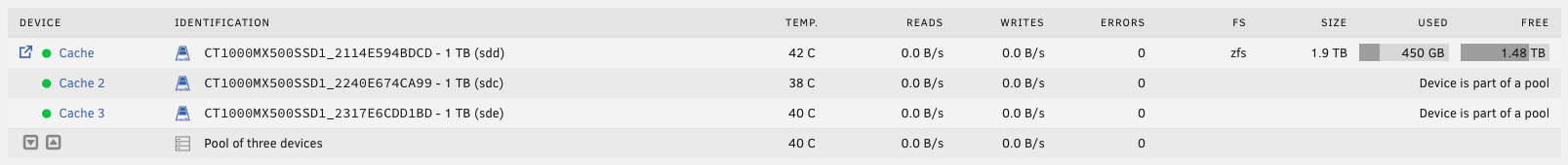

  3. Hello JorgeB, Indeed, it is by dataset. But why the main one (cache) did not report the full size of the pool array ? It seems to only report one drive of the three. That is more that i did not understand. Maybe i could have done better configuring it ? Thanks, K.

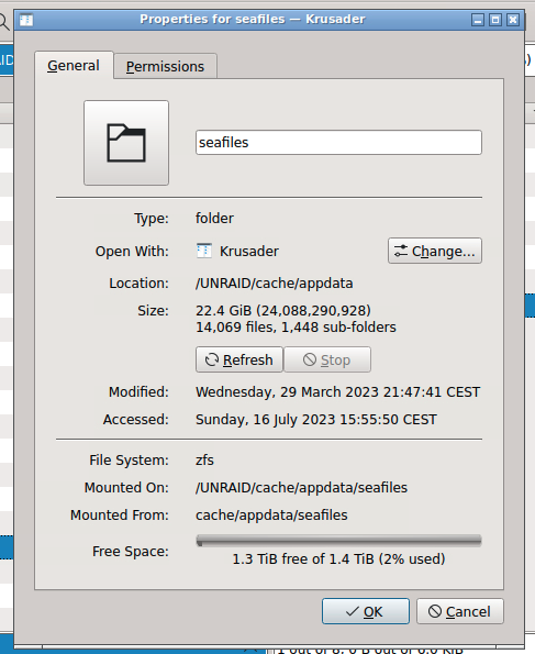

  4. Hello, On my unraid server, i have this cache pool : It is 3x 1TB drives, with one mirror, for a total of 1.9 Tb useable capacity. On the unraid console, when i do : df -h I have this output : root@Yggdrasil:~# df -h Filesystem Size Used Avail Use% Mounted on rootfs 24G 1.6G 22G 7% / tmpfs 32M 2.2M 30M 7% /run /dev/sda1 58G 2.5G 55G 5% /boot overlay 24G 1.6G 22G 7% /lib overlay 24G 1.6G 22G 7% /usr devtmpfs 8.0M 0 8.0M 0% /dev tmpfs 24G 0 24G 0% /dev/shm tmpfs 128M 1.5M 127M 2% /var/log tmpfs 1.0M 0 1.0M 0% /mnt/disks tmpfs 1.0M 0 1.0M 0% /mnt/remotes tmpfs 1.0M 0 1.0M 0% /mnt/addons tmpfs 1.0M 0 1.0M 0% /mnt/rootshare (array disks here) cache 939G 23G 916G 3% /mnt/cache cache/system 933G 17G 916G 2% /mnt/cache/system cache/domains 1.4T 417G 916G 32% /mnt/cache/domains cache/appdata 916G 2.3M 916G 1% /mnt/cache/appdata cache/appdata/mosquitto 916G 256K 916G 1% /mnt/cache/appdata/mosquitto cache/appdata/grafana 916G 1.3M 916G 1% /mnt/cache/appdata/grafana cache/appdata/homeassistant 916G 93M 916G 1% /mnt/cache/appdata/homeassistant cache/appdata/mysql 916G 119M 916G 1% /mnt/cache/appdata/mysql cache/appdata/nginx 916G 1.0M 916G 1% /mnt/cache/appdata/nginx (etc for others containers) The "cache" is reported to be 939GB with only 23Gb used. I dont really understand this value. Is it because of ZFS ? I use Glances (with Homepage), and i can't show the correct size of the cache pool : It seems to be reported as the df command line. Really not a big deal, but maybe i can use this to learn something more. Thanks all, K.

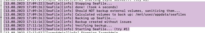

  10. Hello, I use your Seafile docker for four months : I love it. Thanks ! Right now, i use "Backup/Restore Appdata" to make a backup of the container, which require to stop Seafile. As i am the only user and store small amount of data, it took less than 10min, which i do overnight : I think it is time to move forward. I would like to store more data, and also open it to my family, mainly to store photos/videos of my nephews, as no one in the family really understand the word "MAKE BACKUPS" or "A file in one place is a dead file". So, the total amount of data will grow, and i think stopping the container and make an archive of 1 Tb+ won't be a right solution. What is recommandation ? To give you some context : - appdata (and seafile container) is on a zfs pool : - I kept my Appdata backup on the array inside /mnt/disk5/Backup/UNRAID/appdata - Every day, a second UNRAID server is turn on and use this script to backup the main server : On the backup server, inside a array, i have a zfs disk waiting for some snapshots : I think i can manage something with that, but i don't know if zfs snapshot or rsync is a good solution, as Seafile data can be updated at any time. Thanks you for your time, and for the container ! K.

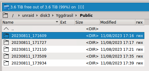

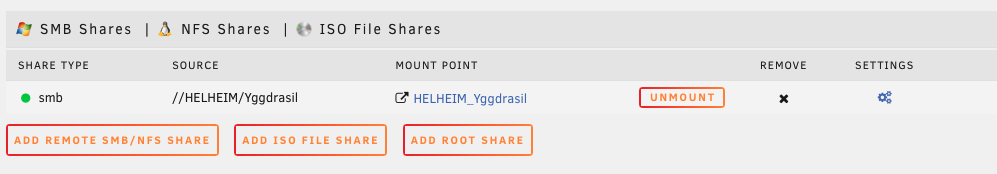

  13. Hello, I made some test with the folder Public but hardlink seems broken : root@Helheim:/mnt/disk3/Yggdrasil/Public/20230811_171609# ls 20230811_171609.log* log-cut.txt* log.txt* root@Helheim:/mnt/disk3/Yggdrasil/Public/20230811_174553# ls 20230811_174553.log* log-cut.txt* log.txt* root@Helheim:~# du -d1 -h /mnt/disk3/Yggdrasil/Public | sort -k2 6.9M /mnt/disk3/Yggdrasil/Public 1.2M /mnt/disk3/Yggdrasil/Public/20230811_171609 (...) 1.2M /mnt/disk3/Yggdrasil/Public/20230811_174553 I use Unassigned Devices to mount a SMB share (which is another local UNRAID server) : Then, i run the script with : # backup source to destination backup_jobs=( # source # destination "/mnt/user/Public" "/mnt/remotes/HELHEIM_Yggdrasil/Public" ) The destination folder is "disk3" formatted as BTRFS : Here is the log when i run the script : Script location: /tmp/user.scripts/tmpScripts/00 - Backup Yggdrasil to Helheim/script Note that closing this window will abort the execution of this script # ##################################### last_backup: '20230811_173934/' Create incremental backup from /mnt/user/Public to /mnt/remotes/HELHEIM_Yggdrasil/Public/20230811_174553 by using last backup /mnt/remotes/HELHEIM_Yggdrasil/Public/20230811_173934/ created directory /mnt/remotes/HELHEIM_Yggdrasil/Public/.20230811_174553 cd..t...... ./ cf...p..... .DS_Store cf...po.... log-cut.txt cf...pog... log.txt Number of files: 5 (reg: 3, dir: 2) Number of created files: 0 Number of deleted files: 0 Number of regular files transferred: 0 Total file size: 1.19M bytes Total transferred file size: 0 bytes Literal data: 0 bytes Matched data: 0 bytes File list size: 0 File list generation time: 0.001 seconds File list transfer time: 0.000 seconds Total bytes sent: 183 Total bytes received: 113 sent 183 bytes received 113 bytes 197.33 bytes/sec total size is 1.19M speedup is 4,017.89 File count of rsync is 5 Make backup visible ... ... through local mv renamed '/mnt/remotes/HELHEIM_Yggdrasil/Public/.20230811_174553' -> '/mnt/remotes/HELHEIM_Yggdrasil/Public/20230811_174553' # ##################################### Clean up outdated backups Keep daily backup: 20230811_174553 Keep multiple backups per day: 20230811_173934 Keep multiple backups per day: 20230811_173509 Keep multiple backups per day: 20230811_172110 Keep multiple backups per day: 20230811_171727 Keep multiple backups per day: 20230811_171609 In my case hardlink seems broken (i did not edit the content of Public) : root@Helheim:~# du -d1 -h /mnt/disk3/Yggdrasil/Public | sort -k2 6.9M /mnt/disk3/Yggdrasil/Public 1.2M /mnt/disk3/Yggdrasil/Public/20230811_171609 1.2M /mnt/disk3/Yggdrasil/Public/20230811_171727 1.2M /mnt/disk3/Yggdrasil/Public/20230811_172110 1.2M /mnt/disk3/Yggdrasil/Public/20230811_173509 1.2M /mnt/disk3/Yggdrasil/Public/20230811_173934 1.2M /mnt/disk3/Yggdrasil/Public/20230811_174553 Do you know how i can troubleshoot the situation ? Thanks, K.
