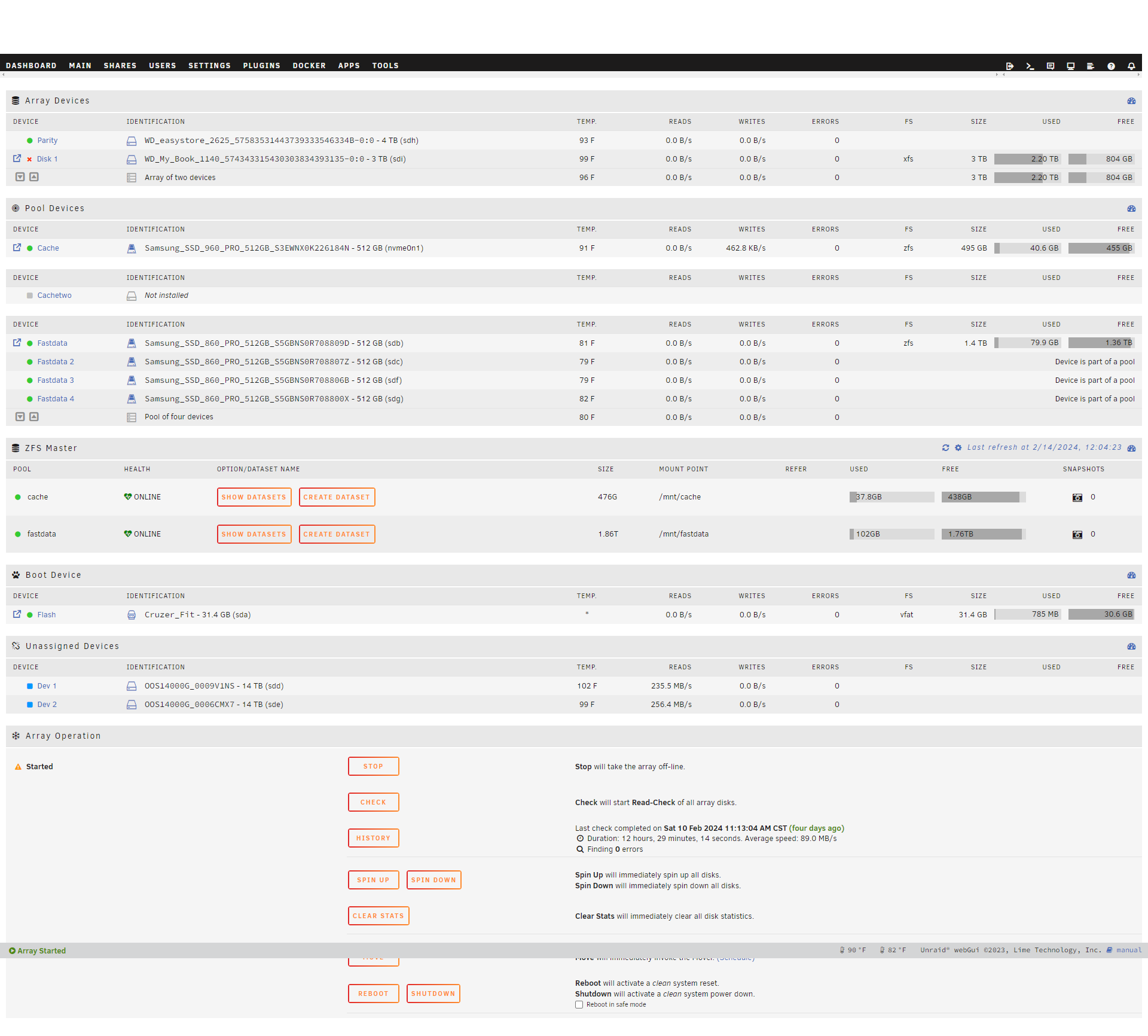

I HAD a 4TB drive as parity and a single 3TB drive as my data drive. My 3TB data drive is dead and disabled. I purchased two 14TB drives and want to replace the 4TB drive with one of the 14TB drives and use the second 14TB drive as my data drive. Can someone please point me in the right direction on how to go about that? My initial thought was to add one of the 14TB drives as my second parity drive, and once that is added, remove the 4TB drive from the system, and lastly, add the second 14TB drive as my new data drive.
Right now, my two 14TB drives are unassigned and going through a round of BadBlocks before I proceed to try anything.

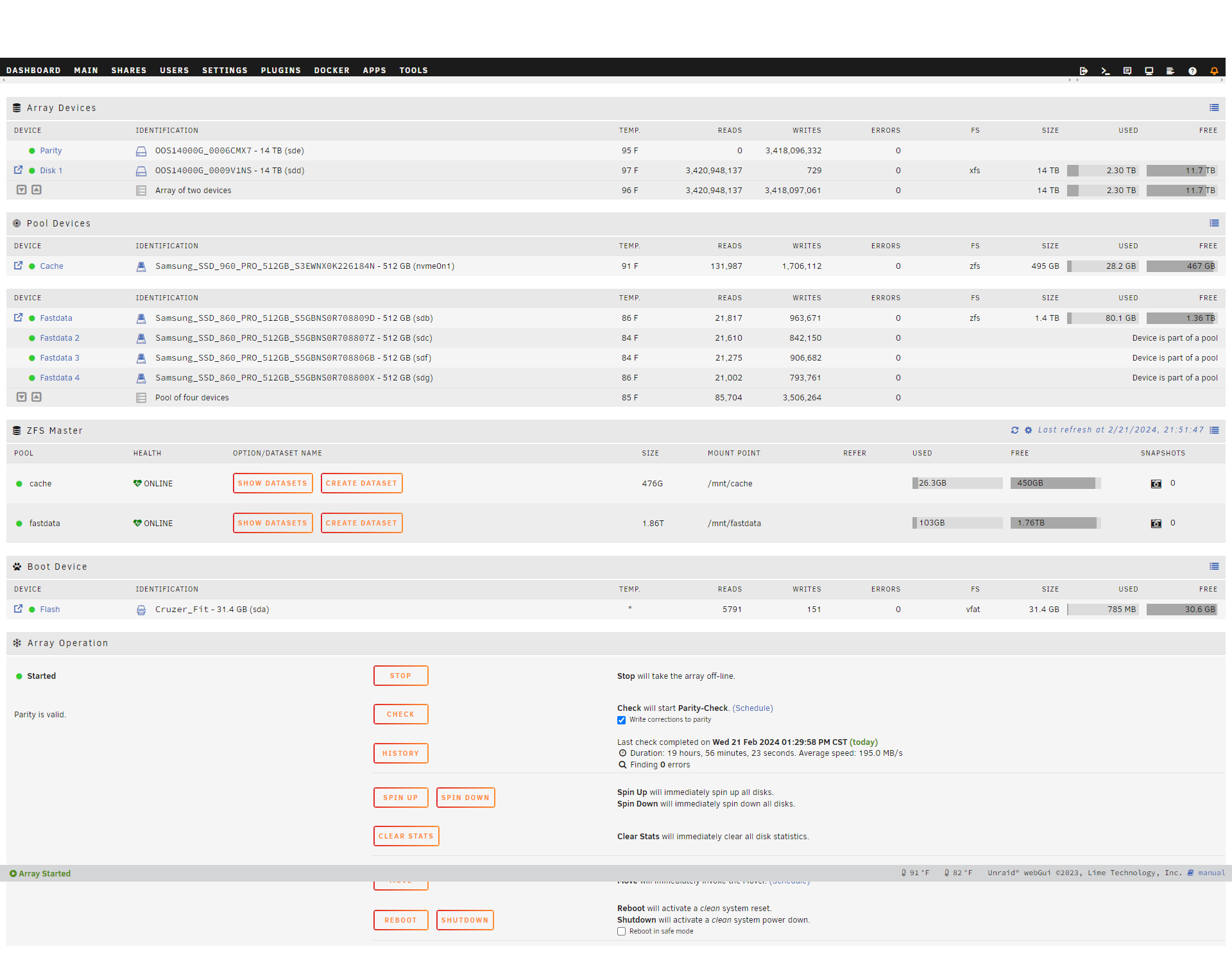

I finally got around to pushing the changes. It all would have worked as you stated but I accidently started expanding the array with the 4TB still in the disk1 section so I stopped it and some how that corrupted the new parity drive and my old parity drive had already started to be over written. I managed to move the newly created 14tb parity drive to disk1 and the second blank 14tb drive to parity but it wouldn't mount because the file system got corrupted. I ran  xfs_repair and once it completed successfully I restarted Unraid and started the array at which point parity started to rebuild and after about 20 hours, all is good.
Thanks for your help.
PS I got rid of the USB drives :)
