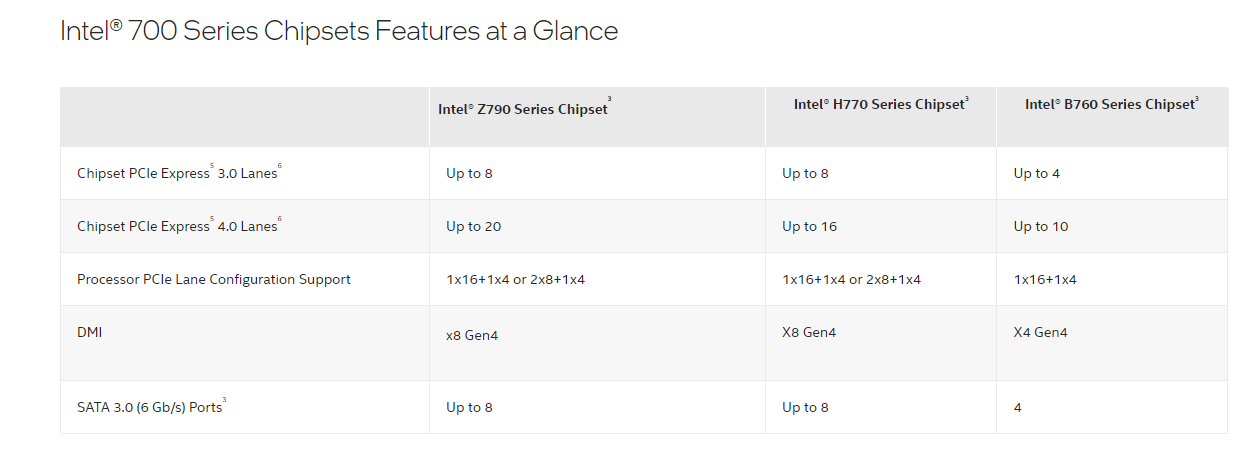

depends on how many drives you want to connect maybe the ASRock Z790 Pro RS is an alternative choise who has 8 sata already onboard
quick check on platform check you can see the z770 is limited to 16 lanes:
Otherwise you have to look in tho threadripper or xeon lines to have more pcie lanes to use it on full speed.
