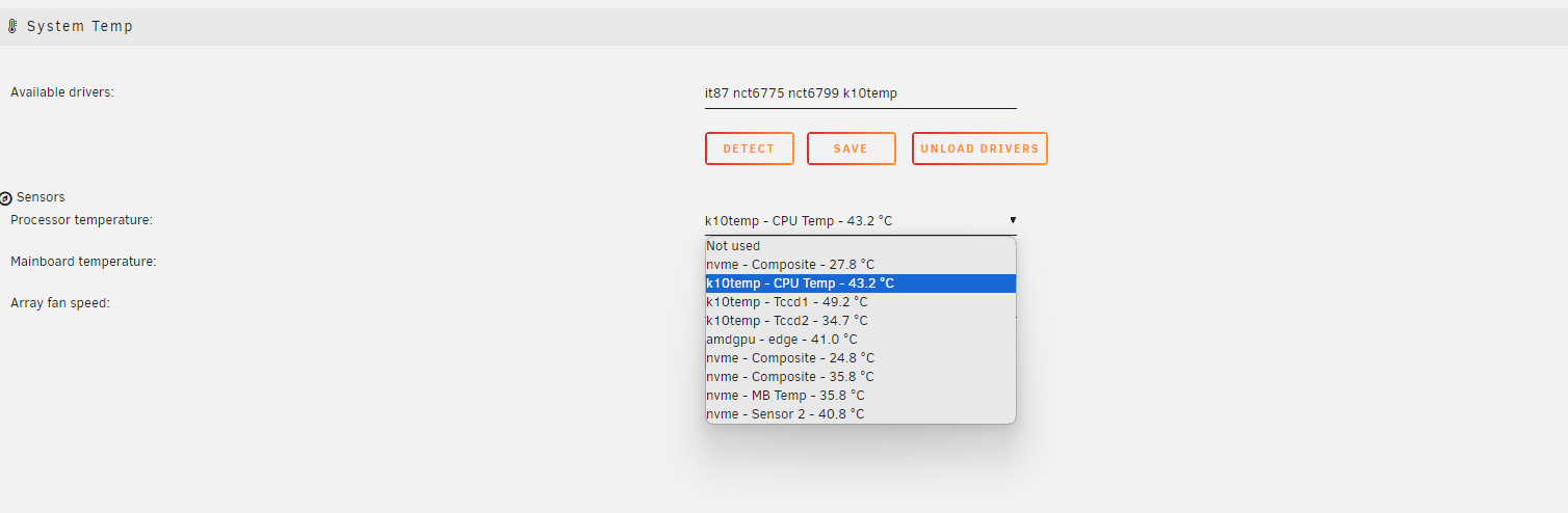

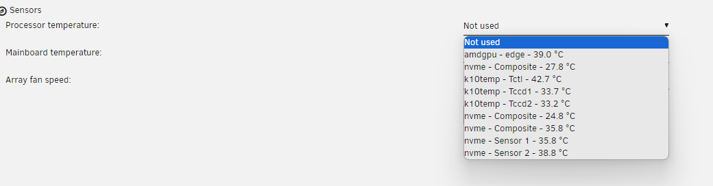

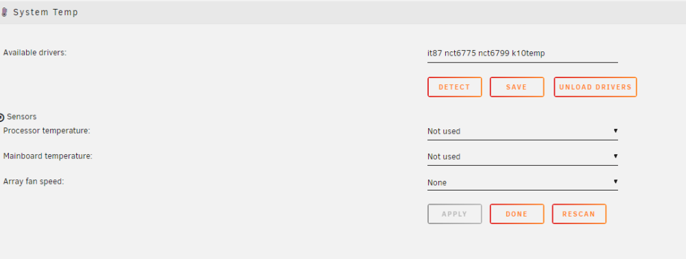

Show CPU temps on Dashboard with AM5 x670 with ryzen 7000 series
I set mine to tctl to monitor that one
Yeah it really is they don't run ad cold as intels Around 40~45 here with a 420mm aio on it Underload never above 75.. I mean real stress, cpu encoding compiling etc.. So yours is pretty normal, just check the temps under full load to be sure everything is OK.
The k10temp ones are the cpu, the cpu consist of 2 chiplets ccd1 and 2 i see them both in your drop down menu, the tctl is the total package temperature. Set the tctl as the cpu temp reader.

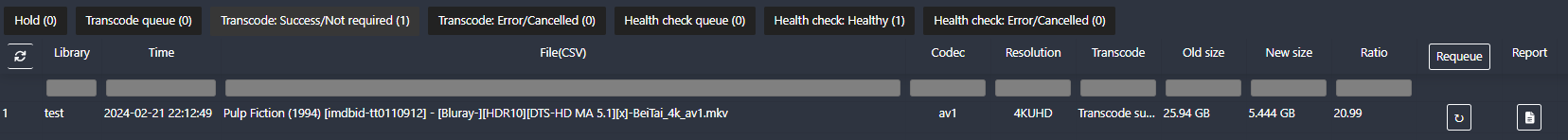

I've been using tdarr on windows server and node on baremetal and av1 encoding using arc380 always worked like charm because i couldnt get it working on unraid, so have been messing arround and can confirm that it works using a custom flow and using ffmpeg also does work and getting the same fps as on a windows node. How ever i'm a very noob and i can not get the same results like a json file i used created by handbrake. (it has all the settings i want, like cfr subtitles and audio want to keep and passthrough) If I import the json file, as a custom handbrake command, everything goes as expected till it gets to the transcoding part itself and i get the following error message in the logs: (i cutt out some time stamps to save space) QO3MF2pGX:Node[ARC-A380]:Worker[yummy-yeti]:libva info: User environment variable requested driver 'iHD' libva info: Trying to open /usr/lib/x86_64-linux-gnu/dri/iHD_drv_video.so libva info: Found init function __vaDriverInit_1_16 QO3MF2pGX:Node[ARC-A380]:Worker[yummy-yeti]:libva info: va_openDriver() returns 0 QO3MF2pGX:Node[ARC-A380]:Worker[yummy-yeti]:ERROR: encqsvInit: MFXVideoENCODE_Init failed (-17) Unknown Header.BufferId=1396846913 encqsvInit: using encode-only (LowPower) path QO3MF2pGX:Node[ARC-A380]:Worker[yummy-yeti]:[21:11:22] encqsvInit: AV1 Main profile @ level (null) Here is the log from same file with ffmpeg on unraid: 2024-02-21T21:47:16.266Z OZo_XfViU:Node[ARC-A380]:Worker[misty-mite]:Using cached scan results 2024-02-21T21:47:16.266Z OZo_XfViU:Node[ARC-A380]:Worker[misty-mite]:Loaded plugin inputs: { 2024-02-21T21:47:16.266Z "outputCodec": "av1", 2024-02-21T21:47:16.266Z "ffmpegPreset": "fast", 2024-02-21T21:47:16.266Z "ffmpegQuality": "25", 2024-02-21T21:47:16.266Z "hardwareEncoding": "true", 2024-02-21T21:47:16.266Z "hardwareType": "qsv", 2024-02-21T21:47:16.266Z "hardwareDecoding": "true", 2024-02-21T21:47:16.266Z "forceEncoding": "true" 2024-02-21T21:47:16.266Z } 2024-02-21T21:47:16.266Z OZo_XfViU:Node[ARC-A380]:Worker[misty-mite]:Plugin run complete 2024-02-21T21:47:16.267Z OZo_XfViU:Node[ARC-A380]:Worker[misty-mite]:{"_id":"/mnt/transcode/tdarr-workDir-node-swXQq8NdC-worker-misty-mite-ts-1708548335194/1708548337771/Pulp Fiction (1994) [imdbid-tt0110912] - [Bluray-2160p][HDR10][DTS-HD MA 5.1][x265]-BeiTai.mkv","outputNumber":1,"variables":{"ffmpegCommand":{"inputFiles":[],"streams":[{"index":0,"codec_name":"hevc","codec_long_name":"H.265 / HEVC (High Efficiency Video Coding)","profile":"Main 10","codec_type":"video","codec_tag_string":"[0][0][0][0]","codec_tag":"0x0000","width":3840,"height":1634,"coded_width":3840,"coded_height":1640,"closed_captions":0,"has_b_frames":2,"sample_aspect_ratio":"1:1","display_aspect_ratio":"1920:817","pix_fmt":"yuv420p10le","level":153,"color_range":"tv","color_space":"bt2020nc","color_transfer":"smpte2084","color_primaries":"bt2020","chroma_location":"topleft","refs":1,"r_frame_rate":"24000/1001","avg_frame_rate":"24000/1001","time_base":"1/1000","start_pts":0,"start_time":"0.000000","disposition":{"default":1,"dub":0,"original":0,"comment":0,"lyrics":0,"karaoke":0,"forced":0,"hearing_impaired":0,"visual_impaired":0,"clean_effects":0,"attached_pic":0,"timed_thumbnails":0,"captions":0,"descriptions":0,"metadata":0,"dependent":0,"still_image":0},"tags":{"language":"eng","title":"HEVC, [email protected]@High, 24/1.001 fps @ 19935 kbps","BPS-eng":"19935285","DURATION-eng":"02:34:30.678000000","NUMBER_OF_FRAMES-eng":"222274","NUMBER_OF_BYTES-eng":"23101701508","_STATISTICS_WRITING_APP-eng":"mkvmerge v49.0.0 ('Sick Of Losing Soulmates') 64-bit","_STATISTICS_WRITING_DATE_UTC-eng":"2022-11-20 09:35:38","_STATISTICS_TAGS-eng":"BPS DURATION NUMBER_OF_FRAMES NUMBER_OF_BYTES","DURATION":"02:34:30.677000000"},"removed":false,"mapArgs":["-map","0:0"],"inputArgs":[],"outputArgs":["-r","23.976023976023978","-c:{outputIndex}","av1_qsv","-qp","25"]},{"index":1,"codec_name":"dts","codec_long_name":"DCA (DTS Coherent Acoustics)","profile":"DTS-HD MA","codec_type":"audio","codec_tag_string":"[0][0][0][0]","codec_tag":"0x0000","sample_fmt":"s32p","sample_rate":"48000","channels":6,"channel_layout":"5.1(side)","bits_per_sample":0,"r_frame_rate":"0/0","avg_frame_rate":"0/0","time_base":"1/1000","start_pts":0,"start_time":"0.000000","bits_per_raw_sample":"24","disposition":{"default":1,"dub":0,"original":0,"comment":0,"lyrics":0,"karaoke":0,"forced":0,"hearing_impaired":0,"visual_impaired":0,"clean_effects":0,"attached_pic":0,"timed_thumbnails":0,"captions":0,"descriptions":0,"metadata":0,"dependent":0,"still_image":0},"tags":{"language":"eng","title":"English DTS-HD Master Audio 5.1 @ 3881 kbps","BPS-eng":"3880948","DURATION-eng":"02:34:30.688000000","NUMBER_OF_FRAMES-eng":"869127","NUMBER_OF_BYTES-eng":"4497382500","_STATISTICS_WRITING_APP-eng":"mkvmerge v49.0.0 ('Sick Of Losing Soulmates') 64-bit","_STATISTICS_WRITING_DATE_UTC-eng":"2022-11-20 09:35:38","_STATISTICS_TAGS-eng":"BPS DURATION NUMBER_OF_FRAMES NUMBER_OF_BYTES","DURATION":"02:34:30.687000000"},"removed":false,"mapArgs":["-map","0:1"],"inputArgs":[],"outputArgs":[]},{"index":2,"codec_name":"hdmv_pgs_subtitle","codec_long_name":"HDMV Presentation Graphic Stream subtitles","codec_type":"subtitle","codec_tag_string":"[0][0][0][0]","codec_tag":"0x0000","r_frame_rate":"0/0","avg_frame_rate":"0/0","time_base":"1/1000","start_pts":0,"start_time":"0.000000","duration_ts":9270687,"duration":"9270.687000","disposition":{"default":1,"dub":0,"original":0,"comment":0,"lyrics":0,"karaoke":0,"forced":0,"hearing_impaired":0,"visual_impaired":0,"clean_effects":0,"attached_pic":0,"timed_thumbnails":0,"captions":0,"descriptions":0,"metadata":0,"dependent":0,"still_image":0},"tags":{"language":"eng","title":"Eng/SUP","BPS-eng":"51409","DURATION-eng":"02:28:43.706000000","NUMBER_OF_FRAMES-eng":"4756","NUMBER_OF_BYTES-eng":"57345352","_STATISTICS_WRITING_APP-eng":"mkvmerge v49.0.0 ('Sick Of Losing Soulmates') 64-bit","_STATISTICS_WRITING_DATE_UTC-eng":"2022-11-20 09:35:38","_STATISTICS_TAGS-eng":"BPS DURATION NUMBER_OF_FRAMES NUMBER_OF_BYTES","DURATION":"02:29:13.028000000"},"removed":false,"mapArgs":["-map","0:2"],"inputArgs":[],"outputArgs":[]},{"index":3,"codec_name":"hdmv_pgs_subtitle","codec_long_name":"HDMV Presentation Graphic Stream subtitles","codec_type":"subtitle","codec_tag_string":"[0][0][0][0]","codec_tag":"0x0000","r_frame_rate":"0/0","avg_frame_rate":"0/0","time_base":"1/1000","start_pts":0,"start_time":"0.000000","duration_ts":9270687,"duration":"9270.687000","disposition":{"default":0,"dub":0,"original":0,"comment":0,"lyrics":0,"karaoke":0,"forced":0,"hearing_impaired":0,"visual_impaired":0,"clean_effects":0,"attached_pic":0,"timed_thumbnails":0,"captions":0,"descriptions":0,"metadata":0,"dependent":0,"still_image":0},"tags":{"language":"eng","title":"Eng/SUP","BPS-eng":"59094","DURATION-eng":"02:28:43.706000000","NUMBER_OF_FRAMES-eng":"5504","NUMBER_OF_BYTES-eng":"65917856","_STATISTICS_WRITING_APP-eng":"mkvmerge v49.0.0 ('Sick Of Losing Soulmates') 64-bit","_STATISTICS_WRITING_DATE_UTC-eng":"2022-11-20 09:35:38","_STATISTICS_TAGS-eng":"BPS DURATION NUMBER_OF_FRAMES NUMBER_OF_BYTES","DURATION":"02:29:13.028000000"},"removed":false,"mapArgs":["-map","0:3"],"inputArgs":[],"outputArgs":[]},{"index":4,"codec_name":"hdmv_pgs_subtitle","codec_long_name":"HDMV Presentation Graphic Stream subtitles","codec_type":"subtitle","codec_tag_string":"[0][0][0][0]","codec_tag":"0x0000","width":1920,"height":1080,"r_frame_rate":"0/0","avg_frame_rate":"0/0","time_base":"1/1000","start_pts":2461,"start_time":"2.461000","disposition":{"default":0,"dub":0,"original":0,"comment":0,"lyrics":0,"karaoke":0,"forced":0,"hearing_impaired":0,"visual_impaired":0,"clean_effects":0,"attached_pic":0,"timed_thumbnails":0,"captions":0,"descriptions":0,"metadata":0,"dependent":0,"still_image":0},"tags":{"language":"eng","title":"Eng/SUP","BPS-eng":"51040","DURATION-eng":"02:29:23.372000000","NUMBER_OF_FRAMES-eng":"2029","NUMBER_OF_BYTES-eng":"57187401","_STATISTICS_WRITING_APP-eng":"mkvmerge v49.0.0 ('Sick Of Losing Soulmates') 64-bit","_STATISTICS_WRITING_DATE_UTC-eng":"2022-11-20 09:35:38","_STATISTICS_TAGS-eng":"BPS DURATION NUMBER_OF_FRAMES NUMBER_OF_BYTES","DURATION":"02:29:25.833000000"},"removed":false,"mapArgs":["-map","0:4"],"inputArgs":[],"outputArgs":[]}],"container":"mkv","hardwareDecoding":true,"shouldProcess":true,"overallInputArguments":[],"overallOuputArguments":[]}}} don't know what it does, but on the test run it's like this after transcode: I still do have to check for quality haven't got the time for yet, I happy that i got av1 working only if i could achieve this with my json files would be perfect. (1 for HDR content and one for non HDR) anyway to let the node use the same driver as ffmpeg probably i915_dri.so or the i965_dri.so so i can use it like i'm used to?

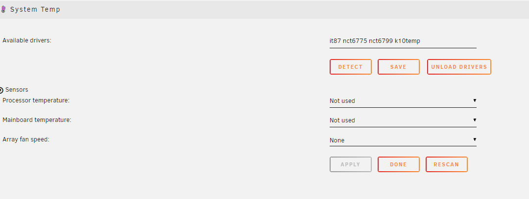

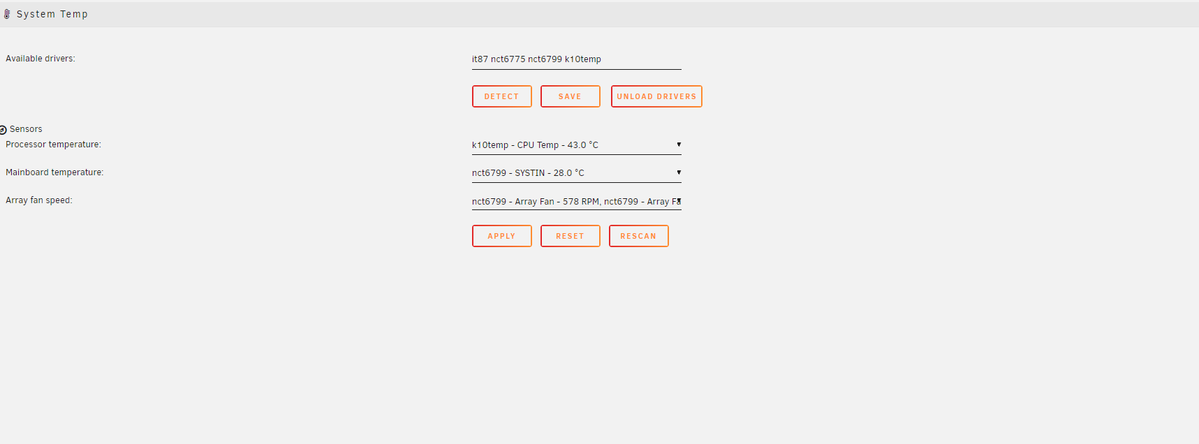

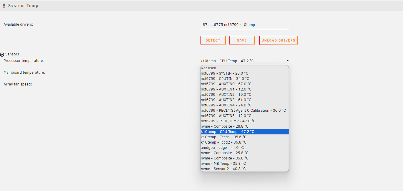

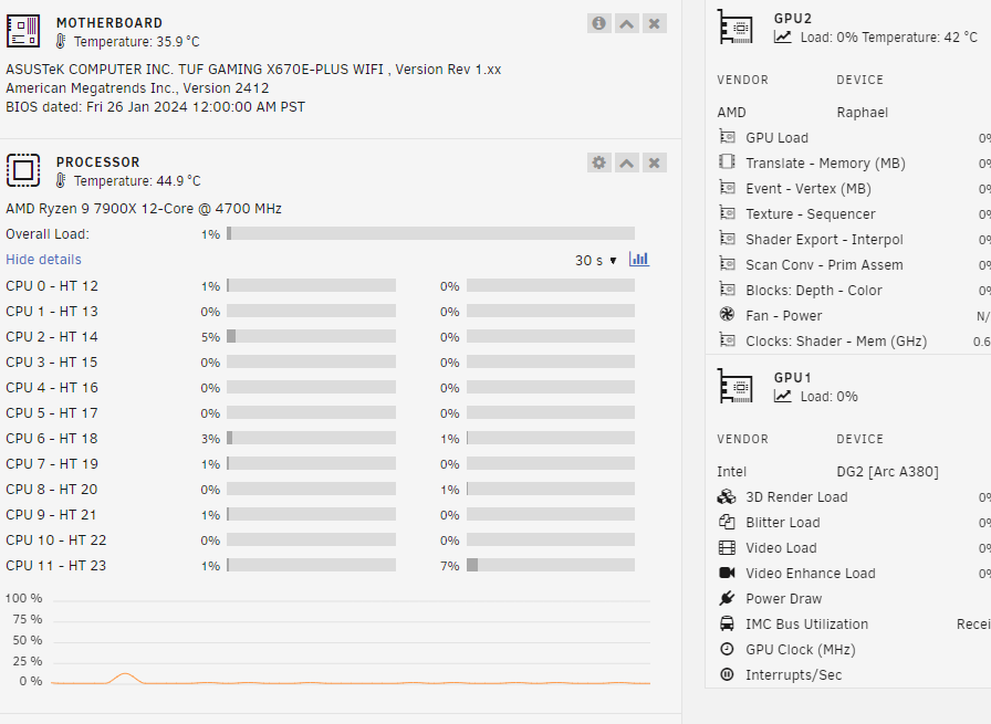

Hi all, After looking for an solution for many many days now, reading all known forums I saw many threads with same issue as I had, so I share with you the steps I took to make the CPU temps shown on the dashboard after many trials and errors. Hope it helps you out too.. My setup is an ASUS TUF X670E-PLUS wifi edition with an Ryzen 9 7900x Before all I'm using custom kernel for Intel ARC compatibility, and am on 6.12.7-rc2 I'm using Thor kernel latest version (more info: https://github.com/thor2002ro/unraid_kernel) Use it on your own risk, and it will break the nvidia drivers if you are using them!! Allright let's begin First open up an terminal window or ssh in to your box. type in sensors and your output should look something like this: nct6799-isa-0290 Adapter: ISA adapter in0: 1.22 V (min = +0.00 V, max = +1.74 V) in1: 1000.00 mV (min = +0.00 V, max = +0.00 V) ALARM in2: 3.39 V (min = +0.00 V, max = +0.00 V) ALARM in3: 3.30 V (min = +0.00 V, max = +0.00 V) ALARM in4: 1000.00 mV (min = +0.00 V, max = +0.00 V) ALARM in5: 1.03 V (min = +0.00 V, max = +0.00 V) in6: 408.00 mV (min = +0.00 V, max = +0.00 V) ALARM in7: 3.38 V (min = +0.00 V, max = +0.00 V) ALARM in8: 3.26 V (min = +0.00 V, max = +0.00 V) ALARM in9: 3.30 V (min = +0.00 V, max = +0.00 V) ALARM in10: 1.28 V (min = +0.00 V, max = +0.00 V) ALARM in11: 1.10 V (min = +0.00 V, max = +0.00 V) ALARM in12: 1.03 V (min = +0.00 V, max = +0.00 V) ALARM in13: 208.00 mV (min = +0.00 V, max = +0.00 V) ALARM in14: 2.03 V (min = +0.00 V, max = +0.00 V) ALARM in15: 944.00 mV (min = +0.00 V, max = +0.00 V) ALARM in16: 3.38 V (min = +0.00 V, max = +0.00 V) ALARM in17: 1.27 V (min = +0.00 V, max = +0.00 V) fan1: 590 RPM (min = 0 RPM) fan2: 845 RPM (min = 0 RPM) fan3: 624 RPM (min = 0 RPM) fan4: 604 RPM (min = 0 RPM) fan5: 760 RPM (min = 0 RPM) fan6: 0 RPM (min = 0 RPM) fan7: 0 RPM (min = 0 RPM) SYSTIN: +29.0°C (high = +80.0°C, hyst = +75.0°C) (crit = +125.0°C) sensor = thermistor CPUTIN: +34.5°C (high = +80.0°C, hyst = +75.0°C) (crit = +125.0°C) sensor = thermistor AUXTIN0: +66.0°C (high = +80.0°C, hyst = +75.0°C) (crit = +125.0°C) sensor = thermistor AUXTIN1: +12.0°C (high = +80.0°C, hyst = +75.0°C) (crit = +125.0°C) sensor = thermistor AUXTIN2: +19.0°C (high = +80.0°C, hyst = +75.0°C) (crit = +125.0°C) sensor = thermistor AUXTIN3: -61.0°C (high = +80.0°C, hyst = +75.0°C) (crit = +100.0°C) sensor = thermistor AUXTIN4: +24.0°C (high = +80.0°C, hyst = +75.0°C) (crit = +100.0°C) PECI/TSI Agent 0 Calibration: +34.0°C (high = +80.0°C, hyst = +75.0°C) AUXTIN5: +12.0°C PCH_CHIP_CPU_MAX_TEMP: +0.0°C PCH_CHIP_TEMP: +0.0°C PCH_CPU_TEMP: +0.0°C TSI0_TEMP: +45.0°C intrusion0: ALARM intrusion1: OK beep_enable: disabled amdgpu-pci-1400 Adapter: PCI adapter vddgfx: 1.46 V vddnb: 1.24 V edge: +42.0°C PPT: 3.19 W nvme-pci-0e00 Adapter: PCI adapter Composite: +28.9°C (low = -5.2°C, high = +79.8°C) (crit = +84.8°C) k10temp-pci-00c3 Adapter: PCI adapter CPU Temp: +45.1°C Tccd1: +36.0°C Tccd2: +35.1°C i915-pci-0300 Adapter: PCI adapter in0: 0.00 V power1: N/A (max = 55.00 W) energy1: 12.39 kJ nvme-pci-1300 Adapter: PCI adapter Composite: +24.9°C (low = -273.1°C, high = +84.8°C) (crit = +89.8°C) nvme-pci-0500 Adapter: PCI adapter Composite: +35.9°C (low = -273.1°C, high = +89.8°C) (crit = +94.8°C) MB Temp: +35.9°C (low = -273.1°C, high = +65261.8°C) Sensor 2: +38.9°C (low = -273.1°C, high = +65261.8°C) If you see something similir like this continue to next step: We're going to create a driver.conf file in the plugin directory (It normally gets created after sensors are being detected but for some reason the sensors dont get correctly recognized on the x670e or the ryzen 7000 series by the plugin or both dont know i am not a coder just a guy trying to fix broken stuff) to tell the plugin what sensors to use for readings In the same terminal window type: touch /boot/config/plugins/dynamix.system.temp/drivers.conf and after that nano /boot/config/plugins/dynamix.system.temp/drivers.conf add the following lines: it87 nct6775 nct6799 k10temp press ctrl + o followed by enter followed by ctrl + x after this go to the plugin page and you should see the 4 drivers listed under available drivers: from here you can go ahead and choose cpu, mainboard, and fan speeds as normally: after choosing the correct sensors (mine looks like this:) don't forget to press the apply button. I tested this on the official kernel and thor kernel both work allthough on the official kernel the nct 6799 doesnt get loaded and the choises will be more limited it will look like this: As you can see only nvme and cpu temps are showing up then. Happy Temp watching on your Dashboards
