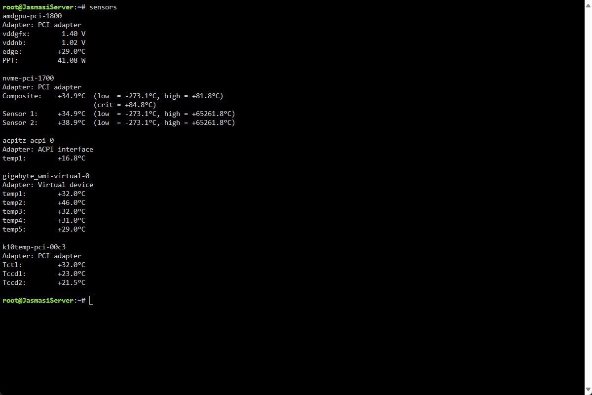

First open up an terminal window or ssh in to your box.
type in sensors and your output should look something like this:

If you see something similir like this continue to next step:

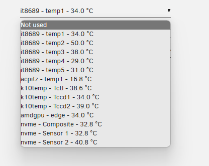

after this go to the plugin page and you should see the 4 drivers listed under available drivers:
from here you can go ahead and choose cpu, mainboard, and fan speeds as normally:
after choosing the correct sensors (mine looks like this:) don't forget to press the apply button.

also, I managed to get temps and fan readings without using the thor kernel by adding the drivers manually to the driver file in the plugin folder like your post mentions and installing the it87 plugin (for it8689 sensor) from ich777. I believe I figured out which one was the cpu temp by just running a trancode in plex and waiting for that temp to go up what I know to be normal for my cpu. As far as the motherboard temp though, I am lost. This is the last piece of the puzzle lol.
EDIT: nevermind.. the readings are all wrong. CPU temp doesn't match what I see in corefreq and what I see in corefreq makes a lot more sense.
Edited by MightyRufo
The k10temp ones are the cpu, the cpu consist of 2 chiplets ccd1 and 2 i see them both in your drop down menu, the tctl is the total package temperature. Set the tctl as the cpu temp reader.
The weird thing is it doesn't seem accurate. It reads slightly higher than what it actually seems to be. My 7950x really idles at 41c? lol

I set mine to tctl to monitor that one

I got it also working but I needed to load the nct6775 module manually by modprobe nct6775
