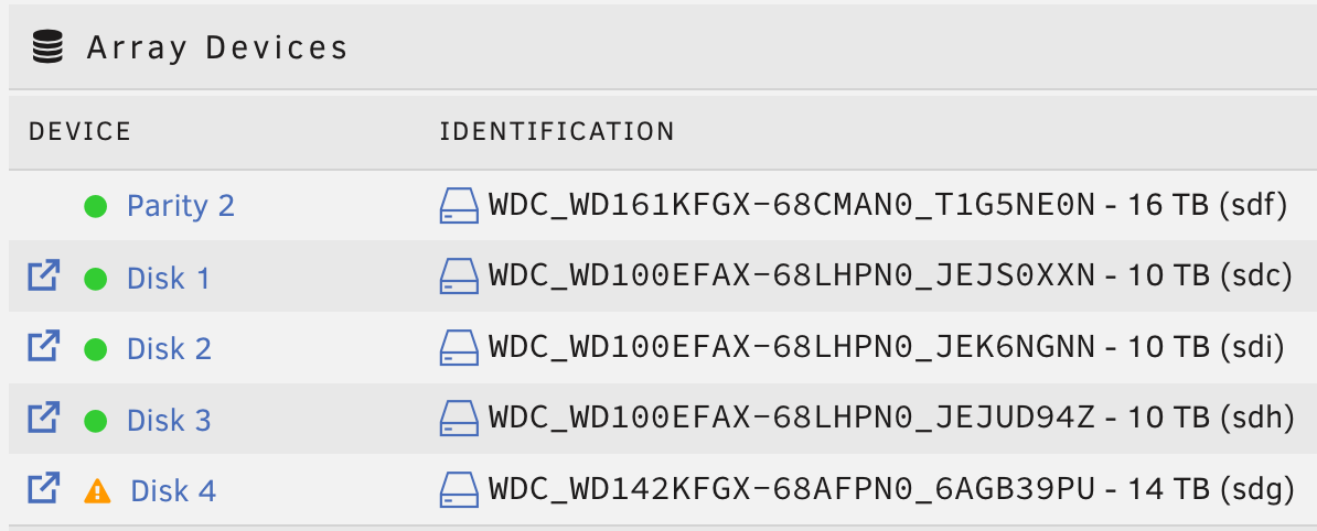

  1. If I wanted to ensure that I have a parity drive in place during this transition, can I add a second Parity 2 drive with a new disk and then once this Parity 2 drive is fully synced, unmount the original Parity 2 and move it to Parity 1?
  2. Thanks. That makes good sense. I will wait for disk 4 to finish and then I will change the drive to Parity’and this will sort things out.
  3. HI All, I have been running unraid for around 5 years now and a number of my original drives are starting to fail so I'm going through the process of upgrading them to larger ones. The 6 disks I had originally put in the machine were all 10TB and two of these were "Parity" and "Parity 2". I have recently removed "Parity" as I needed more space and have consumed the original "Parity" disk as a data drive. So this has left the "Parity 2" drive in place. What I wanted to know is if I can rename "Parity 2" to be "Parity" and if so, how do I do it? I have attached a pic of my drive setup for reference.

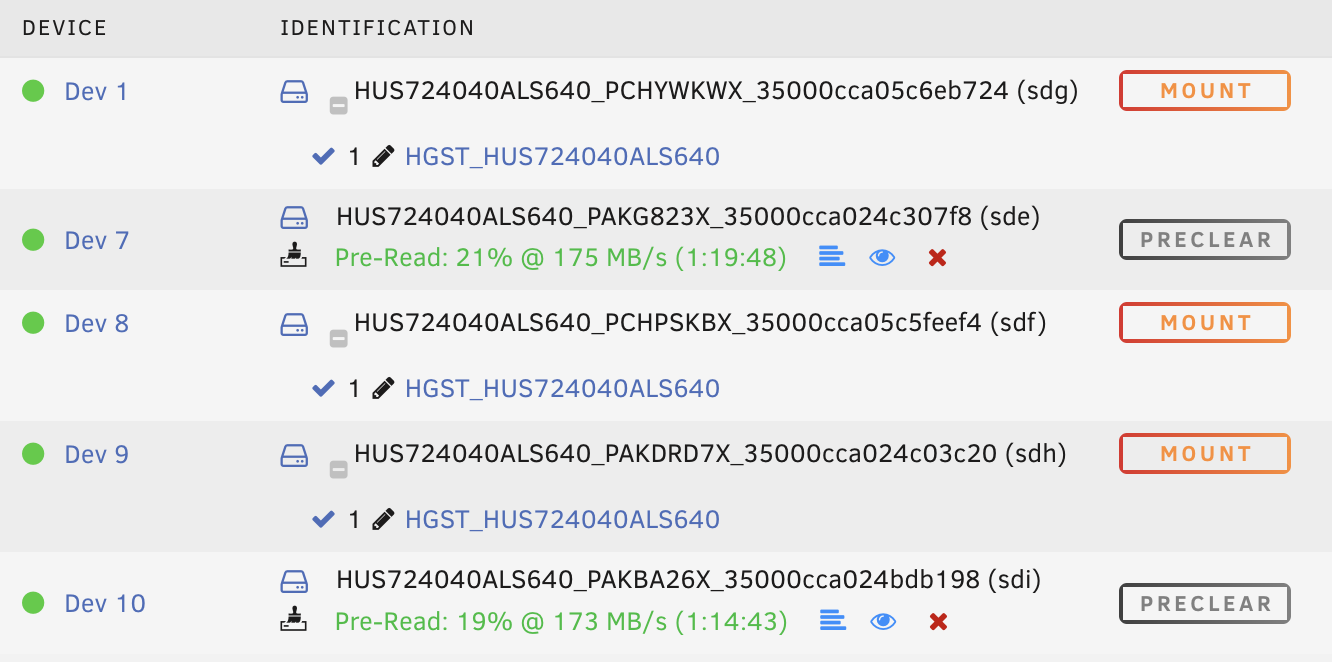

  7. I worked it out! For anyone interested: 1. Make sure you have "Unassigned Devices Plus" plugin 2. Go into the settings of Unassigned Devices 3. Enable "Destructive Mode" 4. Click on the red X next to the drive serial to remove the partition Obvious now that I know
