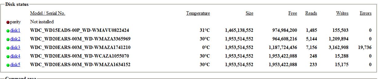

Now Windows is telling me that I don't have permission to copy anything to the array. The user share is still mounted, and mapped to a network drive. I can't rename or copy files that are already on the share, either. Apparently I only have read-only permission.  I also notice that many of the folders it copied are blank - just empty folders - even though the copy dialog from Windows indicated that I was very near the end of the copying operation. There were 1123 files to be copied in 84 folders, and the media share indicates that only 445 were copied in 83 folders. I tried to play one of the video files in that batch from the array and vlc wouldn't play it. It would however, play video files that had been copied earlier.
I went to web interface and discovered that one of the disks appears to have had over 19,000 errors and is showing at a temperature of 0 degrees. I've attached an image of the disk status page. Since disks 3 through 5 had just been added immediately before this operation, were empty, and I am using the "High-Water" method, all the files copied in this last batch had been placed on this drive by unRAID (Not by me. I didn't copy directly to the disk share).
I'm not at all sure how to proceed. I'm hesitant to stop and restart the array, reboot the unRAID server, and or reboot the PC fearing I could make something irreparable. (BTW I have a preclear on another drive that's been ongoing for about 7 hours so I don't want to reboot on a whim but will do so if so advised.)
Do I have a bad drive (even though it precleared without error, just today) and if so should I just remove it. Or is this some artifact of a permission issue that might go away with a reboot. Suggestions much appreciated.
We need a syslog.
But it sounds like that drive might be dying, or you have a cabling issue that is causing those errors.
If I had to guess that drive has been set read-only and that is the reason you can not longer write to it.
