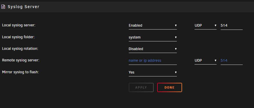

I thought syslog was already logging, but I see now that it needs to be setup in the settings. I've now enabled it and will report back on the next crash.
Edit: I set my syslog server to write to system/, but when I check the share, no new files or folders are created. Should I see something there?
You are missing the remote server IP, use the Unraid server's IP, or just enable the mirror to flash drive option.
Ah, got it. Thanks for that! I now see a syslog-<IP>.log appearing in the folder. Like I said, I'm still relatively new to unraid, so I appreciate the guidance. :)

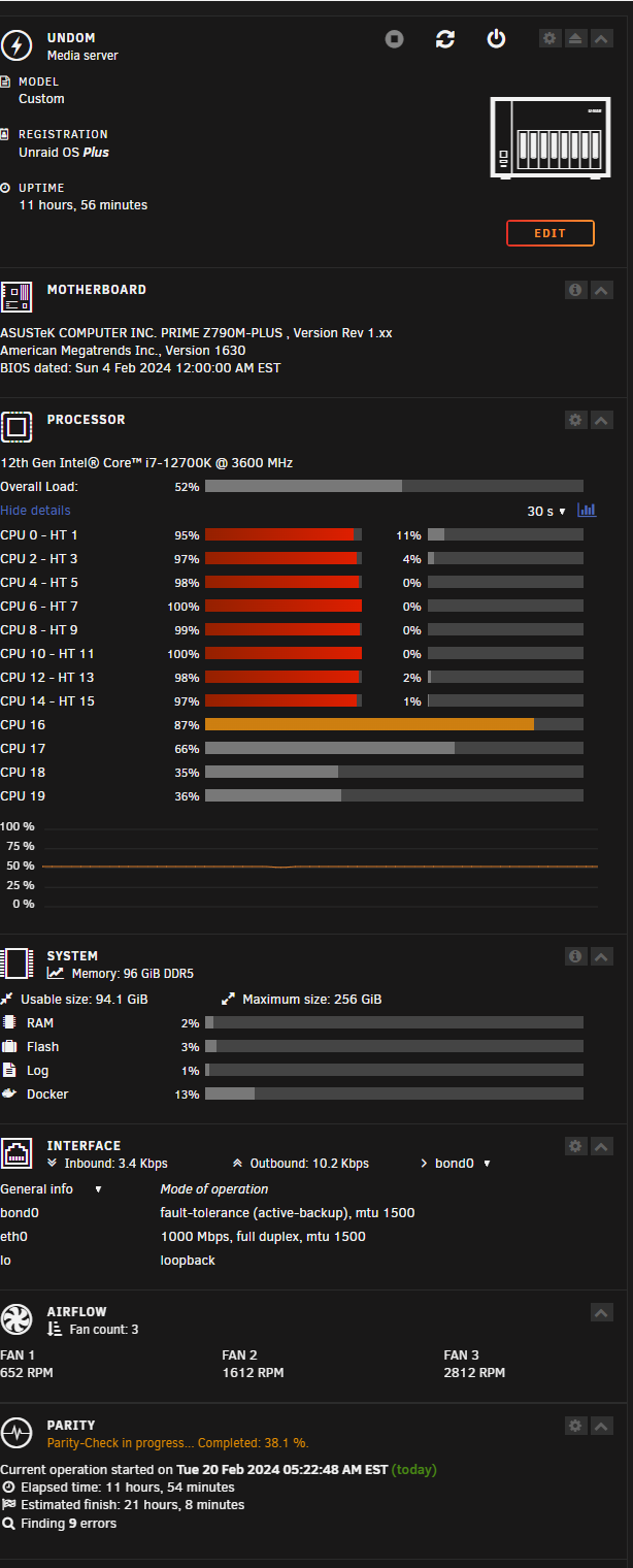

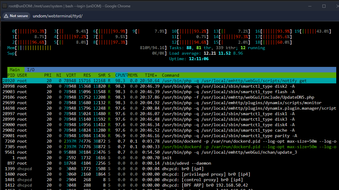

So it looks like it's about to happen again. I'm trying to see what is causing the issue, as it happens. All of a sudden, my unraid server just goes nuts using CPU. It's not doing anything other than a parity check. No one is reading files from it and I am not transfering anything to the server.
Syslog says nothing at all.
But I ran a ps command and it looks like notify, smartctl_type, php, and monitor are taking a lot of CPU.
I will wait and see if it recovers, though it hasn't every other time. Eventually, it becomes inaccessible.
I have no idea what changed.

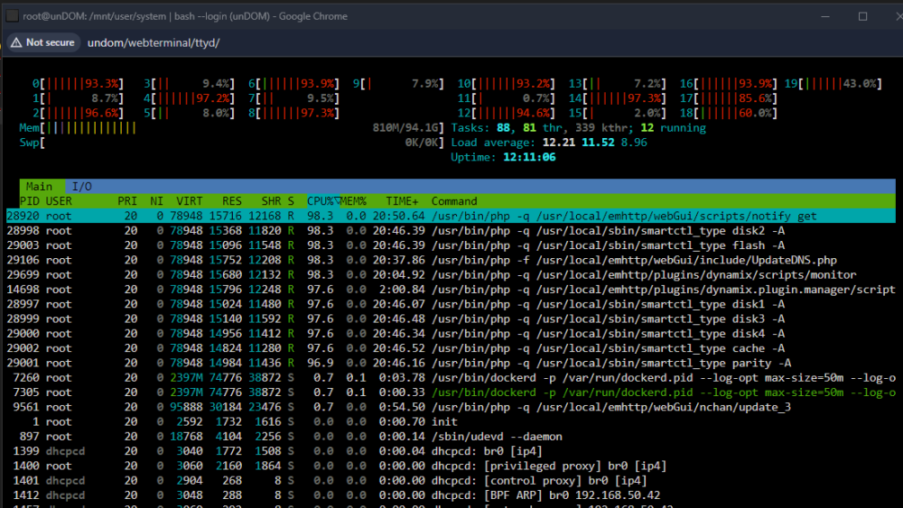

Edit: adding syslog for good measure. I tried to run Diagnostics from the WebGUI and via CLI, but both hung. I've also included a screenshot of htop (I opened a terminal session before the WebGUI became unresponsive).

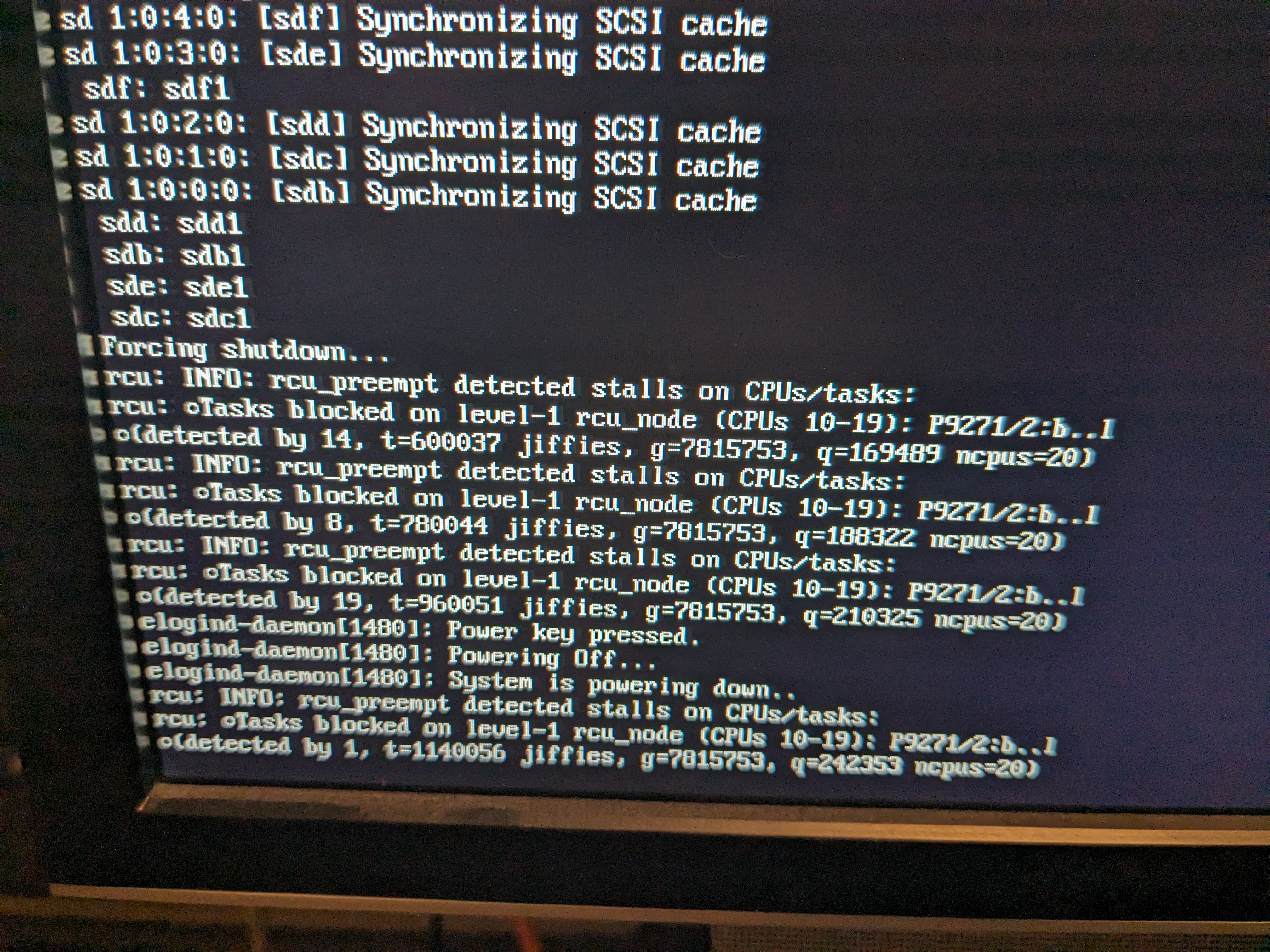

I tried to run the shutdown command: powerdown -r, which might be deprecated, so then just poweroff. It seems to be having trouble even turning off. I do have an updated syslog file, though.
The system has not shut down, now about 10 minutes after sending the command via CLI. The shares are still accessible. Parity-check had already stalled when I noticed the CPU spike. I'm just about to long-press the power button.
When I boot back up, I will send a proper diagnostics file.
Regards,
Dom
syslog-192.168.50.42-final.log
So, I pressed the power button without long-pressing it. The screen I had attached sprung to life, despite not responding to keyboard presses earlier.
I attached a photo.
The system is now off. I'm going to let it cool down then turn it back on and send diagnostics.

Those processes should never cause such high CPU, have you checked that CPU temps are fine?
