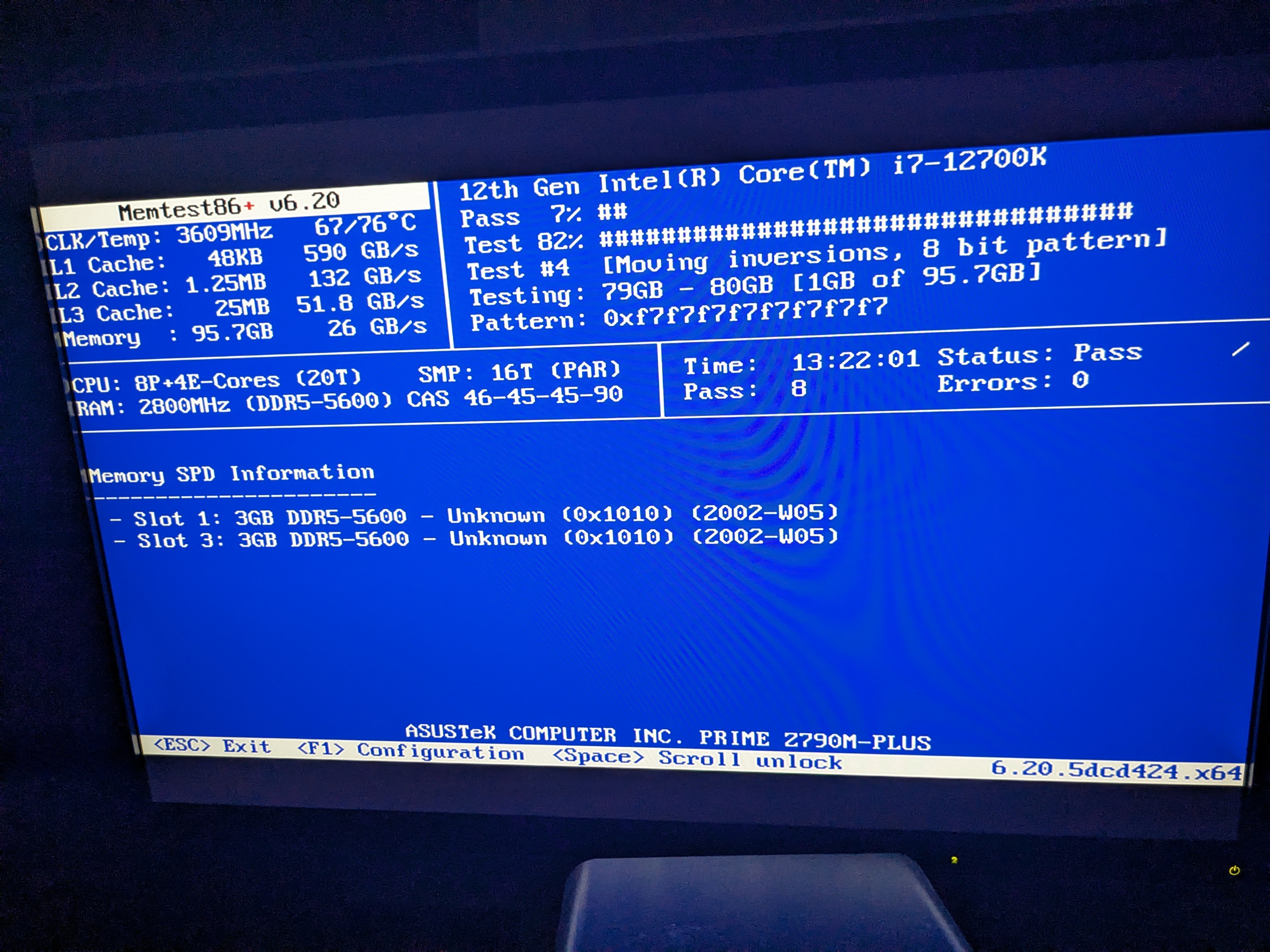

  9. I really thought it was bad RAM, too. But I tested it for over 13 hours and 8 passes. Could a bad USB flash drive cause something like this? It shouldn't, I think, since unraid is loaded to RAM on boot from my understanding. But I think I've had a crash before when I bumped the USB boot drive, so I'm not sure.

  13. Hello there! I am still relatively new to unraid, having build my machine and installed it about December 2023. In my time using unraid, it has been quite unstable and I don't know why. I tried many things to stabilize it, but it's only gotten worse. Here is a timeline of events: Install on 6.2.18 around December 2018 Imported about 60TB from old NAS Started installing some containers in parallel Some containers may have been setup incorrectly as the system became unstable after installing them; uninstalled all containers System was stable-ish Upgraded to 6.2.19 Every so often (maybe once a week), the system would lock up: WebUI unavailble, no response from keyboard presses, no activity on attached monitor, single-press power button did not trigger shutdown Tried to update BIOS, which resulted in my RAM no longer being correctly recognized by my motherboard (issue raised to Asus) Downgraded BIOS; tested RAM extensively (8 passes on MemTest86+, see attached) Installed Immich Upgraded to 6.2.20 Now extremely unstable; cannot even stay up long enough to complete parity check The WebUI remains accessible, but all shares disappear. I can shut down via the WebUI. This is also the case if I start in safe mode Diagnostics are attached. Thanks for any help! This is driving me bonkers! undom-diagnostics-20240410-0833.zip
