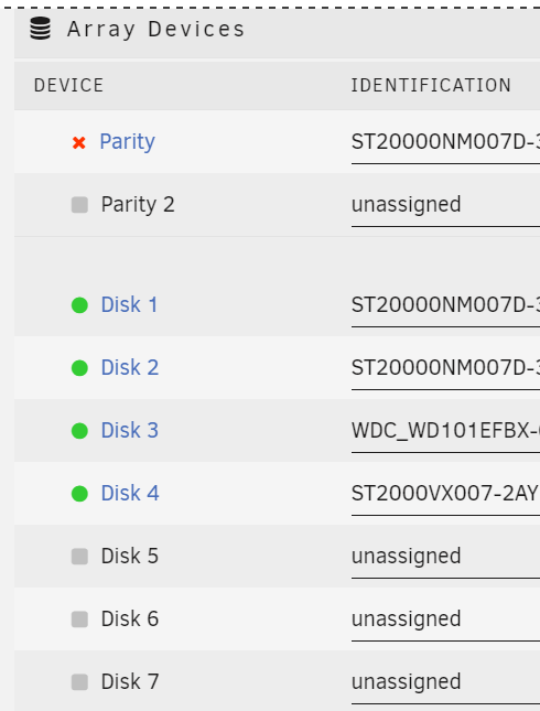

February 21, 20242 yr Why cant we have useful error messages? I got a message parity device disabled. No other meaningful information given and it refuses to re-enable. Assuming a parity error is detected why is the correct thing to do is to disable parity instead of re-doing parity? Honestly very frustrating. Running SMART reveals no errors and no CRC I tried creating a new configuration. Copying the prior config. Still refuses to re-enable parity. Edited February 21, 20242 yr by xokia
February 21, 20242 yr Community Expert Have you followed the procedure that is documented here in the online documentation accessible via the Manual link at the bottom of the Unraid GUI. In addition every forum page has a DOCS link at the top and a Documentation link at the bottom. If you think the drive is fine you can rebuild it to itself.
February 21, 20242 yr Author 6 hours ago, itimpi said: Have you followed the procedure that is documented here in the online documentation accessible via the Manual link at the bottom of the Unraid GUI. In addition every forum page has a DOCS link at the top and a Documentation link at the bottom. If you think the drive is fine you can rebuild it to itself. Yes I read it, it still doesnt explain to me why it believes my parity failed. Why must one go digging for the error? You flash a notification that parity failed. Why not include the reason unraid believes the drive failed into the error message you are flashing on the screen? For me unassigning and reassigning the parity drive did absolutely nothing it still refused to rebuild parity. I could not force the parity drive back into the array. It would always say drive disabled. I had to take the drive offline clear the drive then reattach the drive and parity finally restarted. I changed nothing on the system. Non of the drives are showing any sign of a drive failure. SMART check shows nothing on any of the drives. Reads/Write appear to be working fine at normal speeds of 200MB/s. Also unclear to me why disabling the parity drive is the correct solution for a parity error. Would you not want to try and restart parity if you detected an error? If you detect some error threshold then disable a drive? I'm not seeing what benefit off lining a drive solved. Edited February 21, 20242 yr by xokia
February 21, 20242 yr Community Expert All you would get is an indication that a write failed (which is what leads to a disk being disabled), not why that write failed. Nothing more would be available without digging into logs. 4 minutes ago, xokia said: For me unassigning and reassigning the parity drive did absolutely nothing it still refused to rebuild parity did you start the array after unassigning the array to commit the drive as missing, and then stop it again to reassign the drive before starting it again to rebuild parity?
February 21, 20242 yr Author 27 minutes ago, itimpi said: All you would get is an indication that a write failed (which is what leads to a disk being disabled), not why that write failed. Nothing more would be available without digging into logs. did you start the array after unassigning the array to commit the drive as missing, and then stop it again to reassign the drive before starting it again to rebuild parity? Why not include the information in the log in the error message is the question? Why must the user dig into the logs? The OS created the error message the OS knows the information. Give the user a meaningful message (I know this is easier said then done). I would think some error threshold had to be met before off lining a drive. One write fails offline a drive is the solution? How does that help me? I would think multiple attempts would be tried so the OS is sure that its dealing with a real fault. It seems to easy to kick a drive out of the array. Maybe some routine that pauses the array on error to prevent further writes, does some basic self test. If it detects additional faults offline a drive. Give the user the results of that self diagnostic? Restore array with drive disabled to keep uptime. IDK but seems like some improvements could be made here. Yes I tried enabling array with drive deselected then stop the array again and re-add the "disabled" drive it still stated disabled. Only after clearing the drive could I get it back into the array. Edited February 21, 20242 yr by xokia

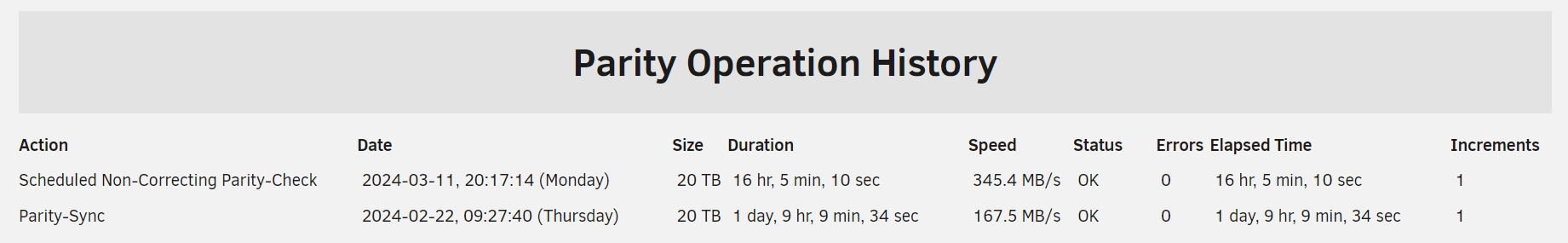

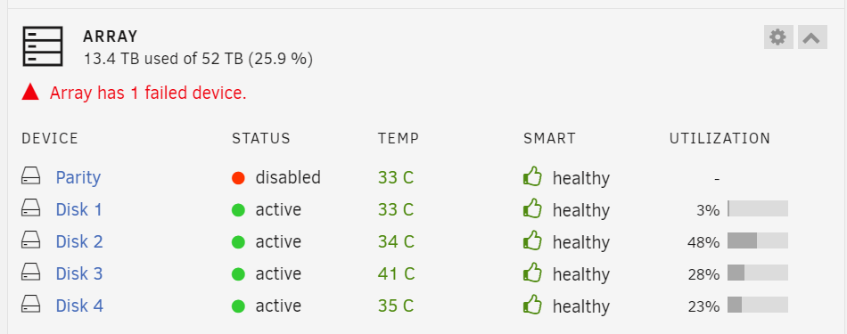

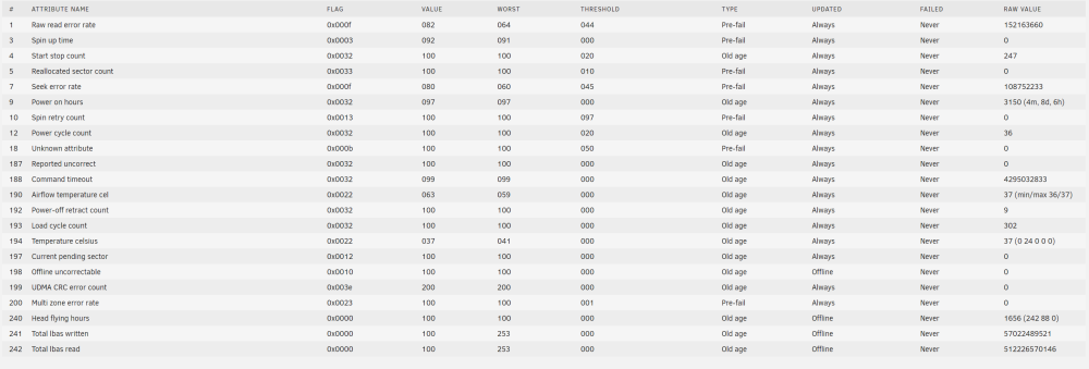

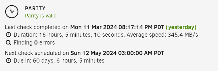

March 13, 20242 yr Author ok so this is the second time parity has failed with unraid. Nothing apparent was wrong no error indicators. What I noticed was when I went to go write to one of my drives it said it was locked and writing was not possible. So I reset the system. It reboots and says parity disabled. 1 day prior it ran a parity check and everything was good. In fact it still says parity valid. Howver parity is obviously not valid since the parity disc is disabled. Smart check doesn't show anything out of the ordinary. There should have been no writes to any of these drives when the failure happened as everything is cached on a 1TB SSD and only writes to the drives when 60% full. ST20000NM007D-20240312-2049.txt Edited March 13, 20242 yr by xokia
March 13, 20242 yr Community Expert Since parity is disabled, last check would have been a read-check only so I agree it should not say parity is valid. You might want to consider installing the Parity Check Tuning plugin. It has been designed to make parity checks less intrusive when you have large disks to check so that checks can take a long time. Even if you do not use its other features it will also enhance Parity History entries to give more information such as why the check was run and what type of check it was.
March 13, 20242 yr Author 17 minutes ago, itimpi said: Since parity is disabled, last check would have been a read-check only so I agree it should not say parity is valid. You might want to consider installing the Parity Check Tuning plugin. It has been designed to make parity checks less intrusive when you have large disks to check so that checks can take a long time. Even if you do not use its other features it will also enhance Parity History entries to give more information such as why the check was run and what type of check it was. I actually have that already installed
March 13, 20242 yr Community Expert Just now, xokia said: I actually have that already installed So what does the history say about the last check?
March 13, 20242 yr Author I believe the parity disk is attached to an IO crest 582 board if that matters. I ordered a JMB585 with heatsink. Not sure that matters. Should be here Thursday, its something to try I guess since I am getting random failures. Its always the parity drive that fails. These are relatively new 20TB seagate exos drives (around 6 months old) Edited March 13, 20242 yr by xokia
March 13, 20242 yr Community Expert OK at that point parity WAS valid I think (unless I have introduced a bug into the plugin so it is not recognising read-checks) and that is what the message you showed is saying, and parity has been disabled since then. Why is not clear. Since you reset the system we have no log from when the drives was disabled unless you happen to have the syslog server enabled with the mirror to flash option set.
