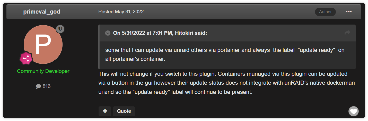

这个只是 docker-compose 插件的显示问题,根据开发者描述,由 docker-compose 所创建出来的容器,它们的“应用更新”状态提示并不集成到 DockerMan 的 UI 中(也就是 Docker 原本的管理界面),所以会一直提示你镜像可以进行更新:
另外我看到某些网友表示可以通过修改一些配置文件来解决一直提示更新的问题,但是我没有试过,你可以参考这里的资料去了解看看:

这是作者的答复:
Before you waste your time on this please note that any "fixes" are unlikely to be merged. I dont consider it to be an issue with this plugin. The problem is the same for any containers on the system created by means other than Dockerman (cli, portainer, composeman, etc.) thus the fix should be in Dockerman. Update tracking is not a feature of the compose manager plugin, and is in many cases irrelevant as locally built containers are a more common use case with compose.
