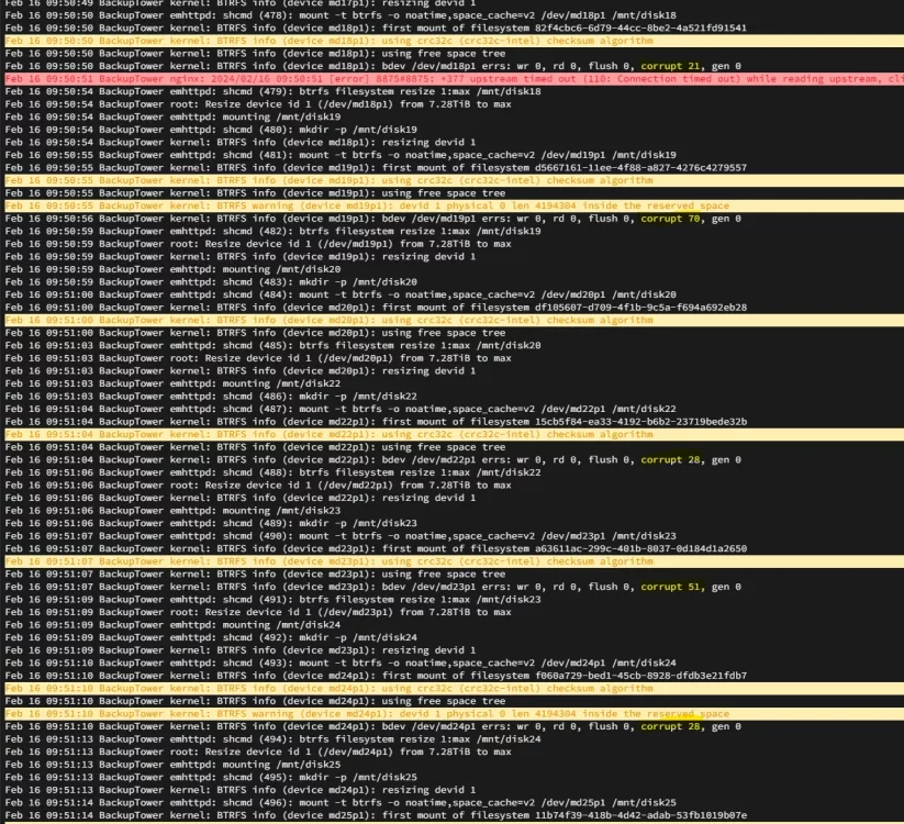

After upgrading to the latest release of unRAID I've noticed a lot of my drives are reporting corruption.
I understand its possible with the new kernel in this release, its detecting corruption that may he been there for some time was just not detected by previous kernels.
Should I run a scrub on each affected disk?
I do have a complete backup of my data on another server running ZFS.
Yes, it would also be a good idea to run memtest, very unlikely that this is kernel related.
How do I identify the disks again? I did this once before but can't remember, there was a command I ran that listed all the disk ID's
Thanks, blkid was what I was looking for though.
You can run scrubs from the GUI, in case you are not aware.
Thanks, I am aware and doing that right now, appreciate your help.
