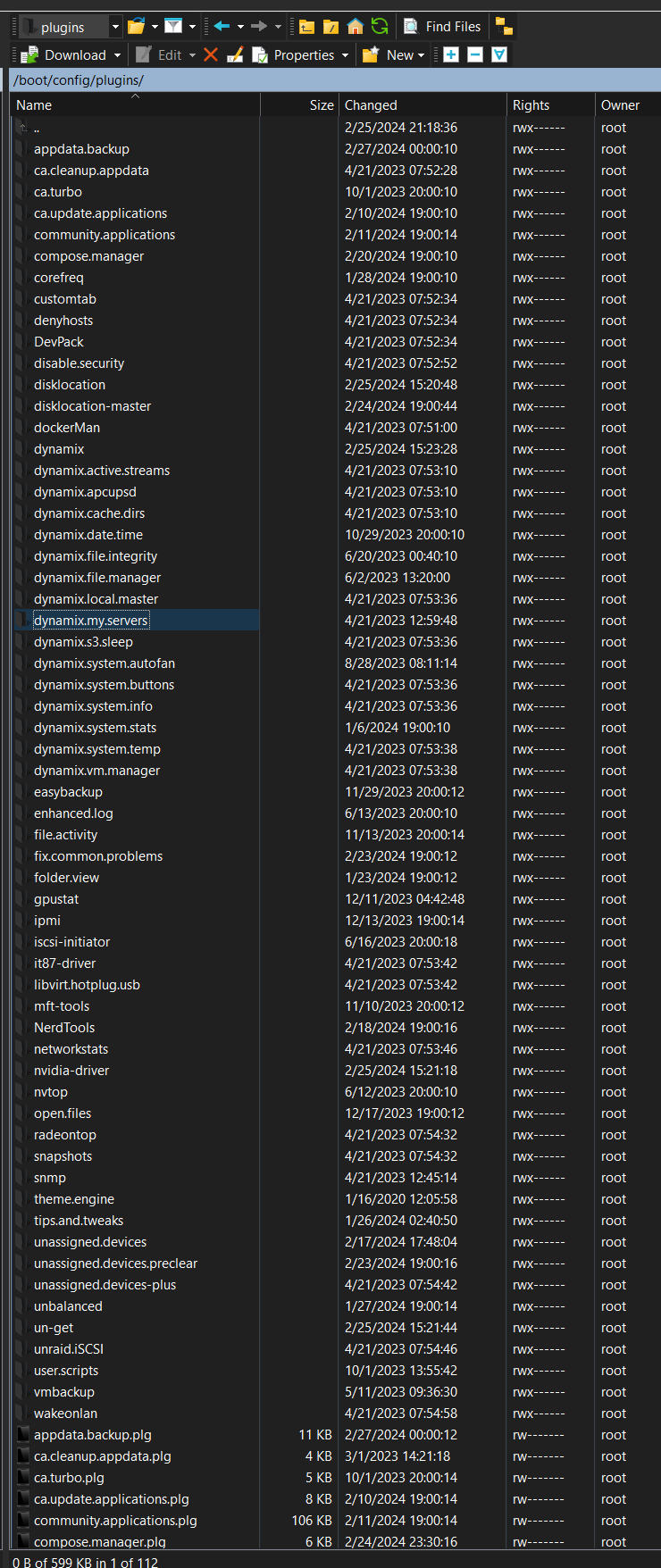

I have this plugin as a folder on the USB:
There's no corresponding .plg file for it.
Can i just delete the folder to make the issue go away?
Thanks
You can delete it, not sure it will help, but it won't hurt for sure.
Thanks @JorgeB, I deleted the plugin folder and rebooted, no more errors.
