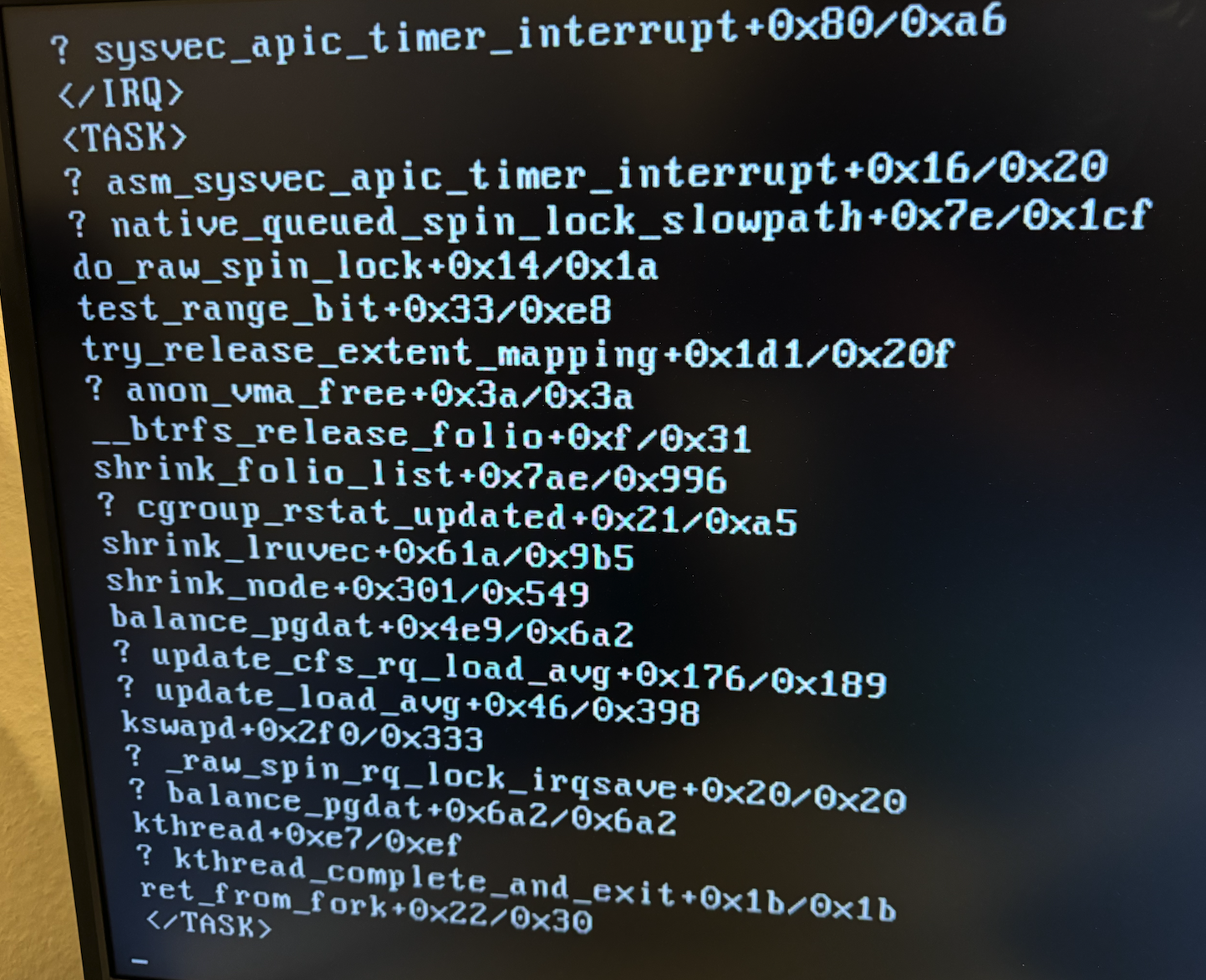

First time it happened a few weeks ago, before that i didn't change anything hardware or software related recently. Since then i had to swap out a defective hdd and recently updated to 6.2.18 trying to fix the issue.

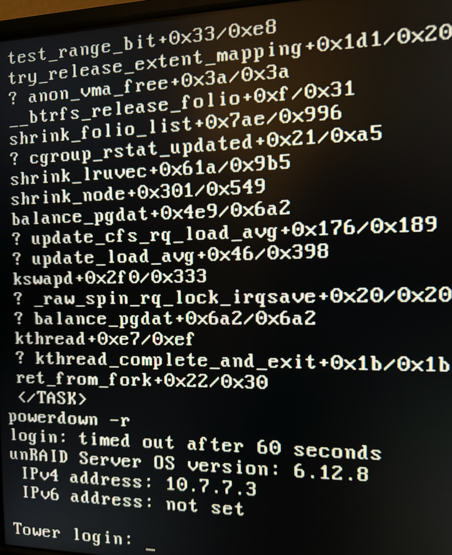

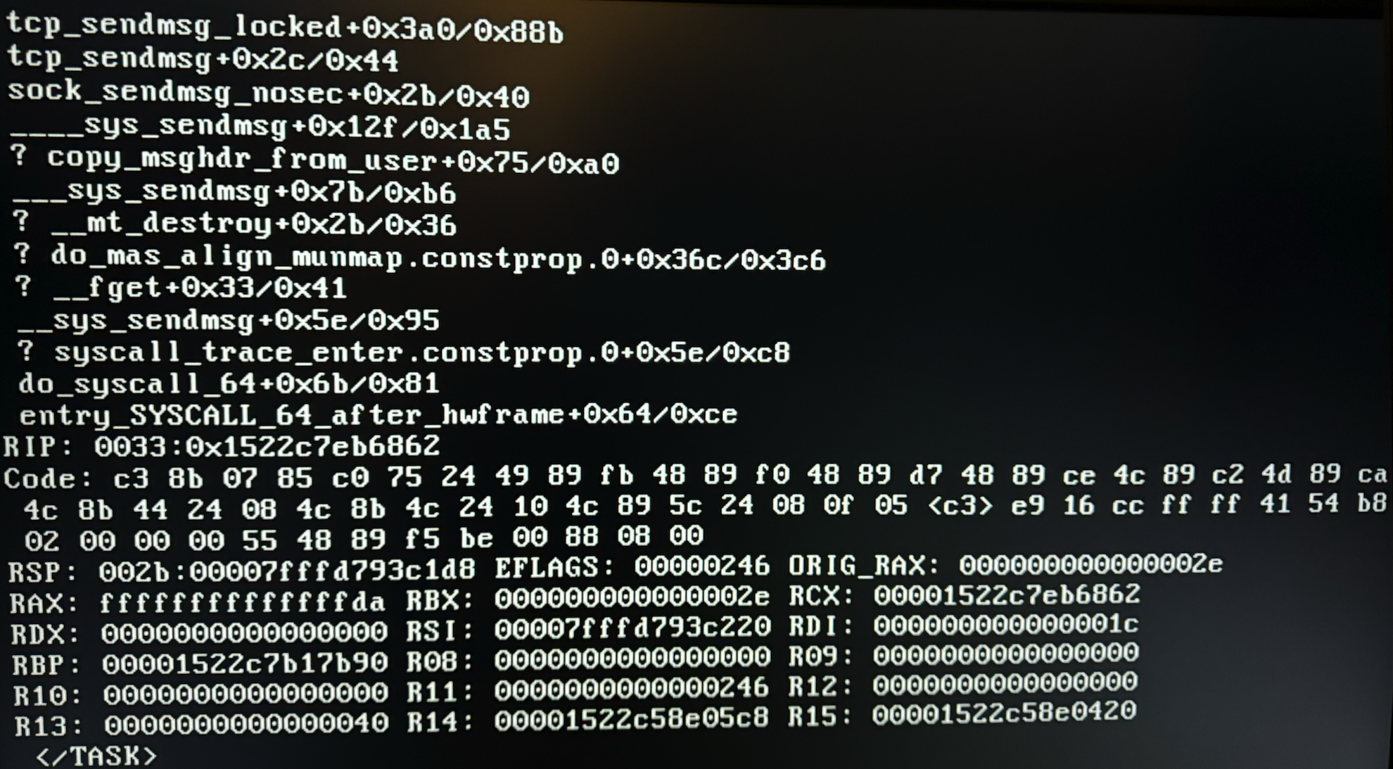

When it happens, i can't access any docker containers or the webui, pinging also doesn't work. I had plugged in a screen last time it happend, but after typing in my credentials nothing happend.
Ive attached my diagnostics, syslog up to the point where i manually restarted it and also photos from the display output. Any recommendation what i should try?

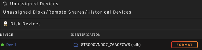

Looks like you have a problem with the following drive as it is showing I/O errors so what is it being used for?:
Device Model:     ST3000VN007
Serial Number:    Z6A0ZCWS
Not used at all currently, its unassigned. Do you think it could still make unraid crash? I will find it and remove it from the server for now.
There's nothing relevant in the persistent syslog, was it active when the server crashed?
Yes, the server crashed somewhat after 2 am today.
Without anything relevant logged it's difficult to guess what the problem could be, one thing you can try is to boot the server in safe mode with all docker containers/VMs disabled, let it run as a basic NAS for a few days, if it still crashes it's likely a hardware problem, if it doesn't start turning on the other services one by one.
