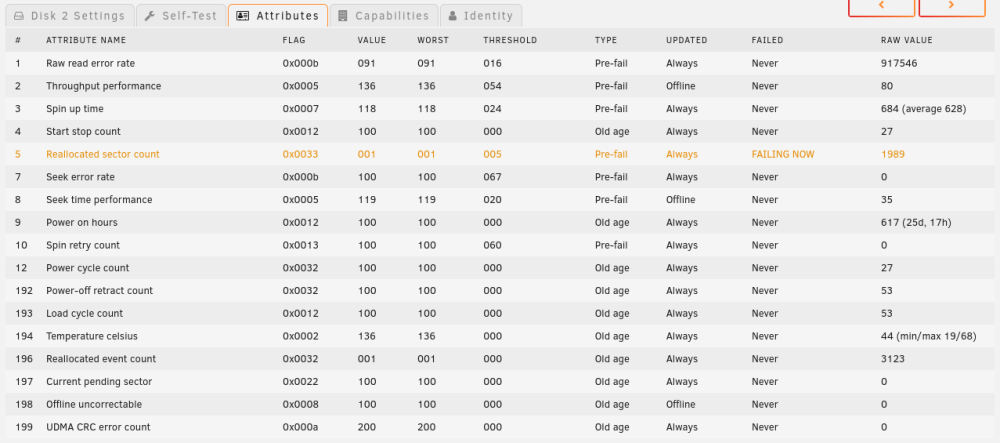

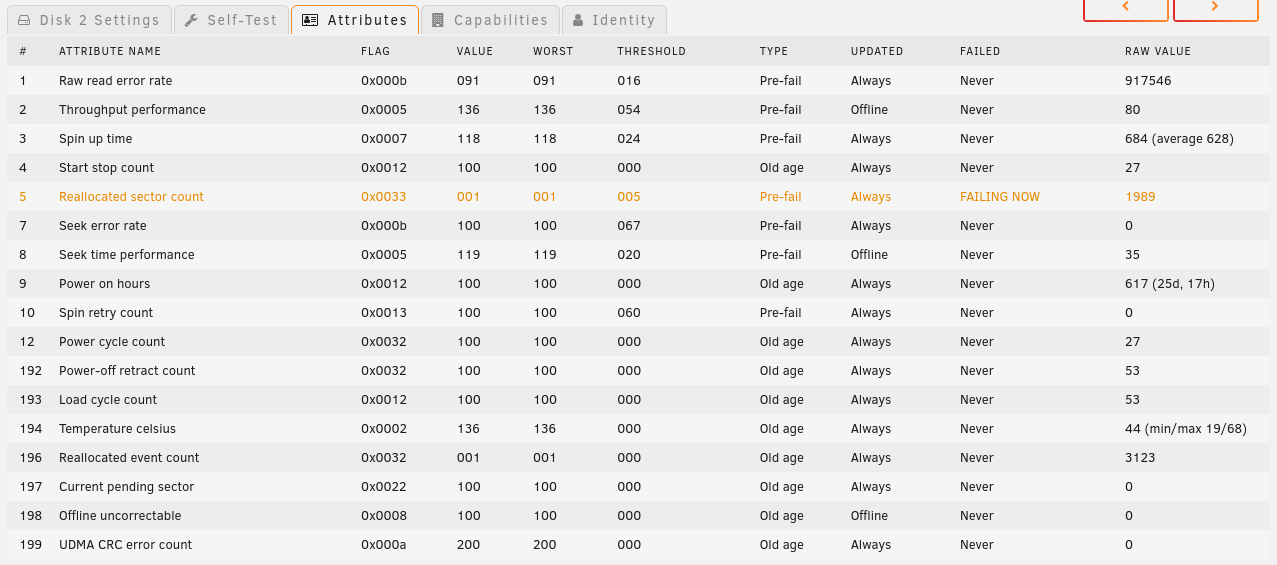

CivBase Posted March 23 Author Share Posted March 23 (edited) I formatted disk2 and disk3 and got the data copied back into the array. Then I ran SMART tests and got errors on disk2 (screenshot attached). I guess that explains how the file system got corrupted. It's one of the new disks I got a few weeks ago, so that's a bummer. I ordered a replacement and I'm currently using the unbalanced plugin to move all the data from disk2 onto disk4. I still have all the data I recovered from disk2, so if something goes wrong with the transfer I should still be able to restore it. Edited March 23 by CivBase 1 Quote Link to comment
