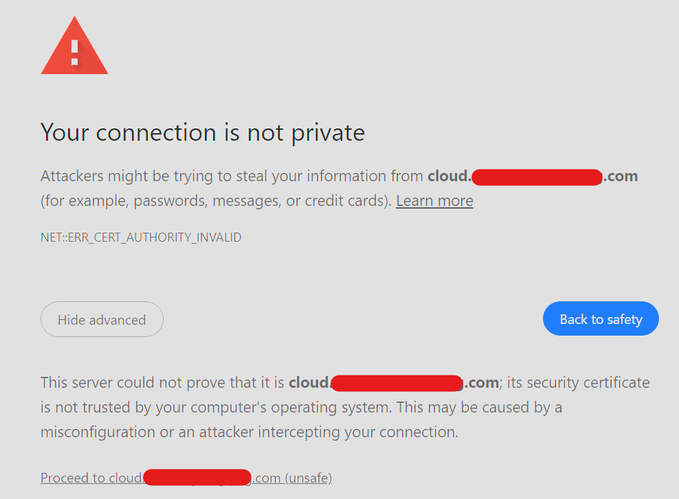

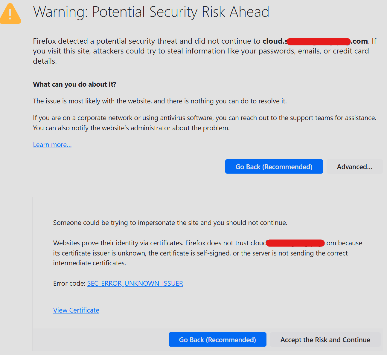

Firefox: SEC_ERROR_UNKNOWN_ISSUER
Google Chrome: NET::ERR_CERT_AUTHORITY_INVALID

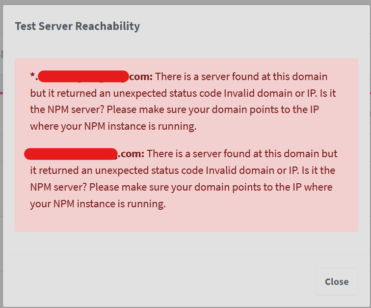

Use NPM to test server reachability.
*.domainname.com: There is a server found at this domain but it returned an unexpected status code Invalid domain or IP. Is it the NPM server? Please make sure your domain points to the IP where your NPM instance is running.
