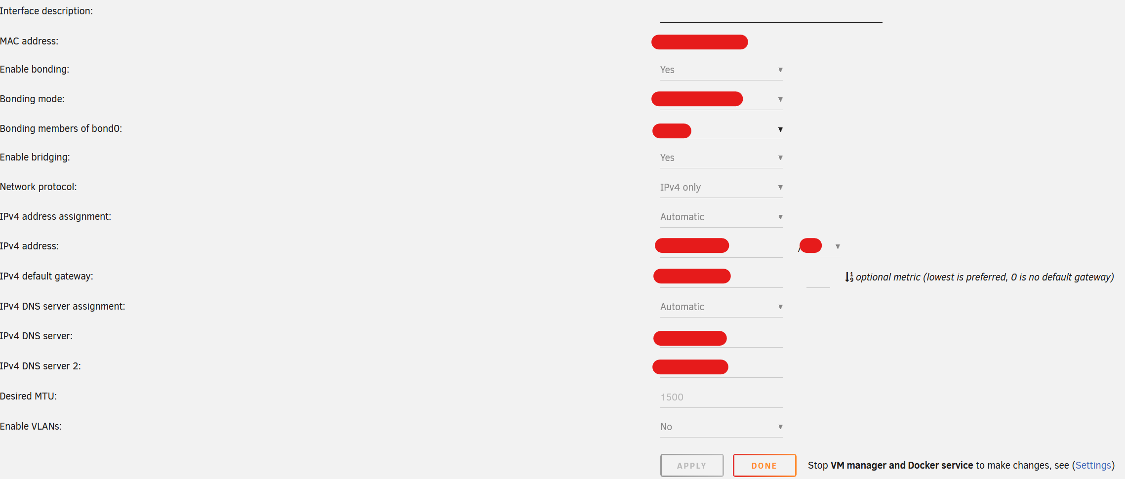

  8. My solution: 1. Stop VM manager and Docker service 2. Change `IPv4 DNS server assignment` to `Static` -> to regenerate `/etc/resolv.conf` 3. Change `IPv4 DNS server assignment` to `Automatic` -> originally value, and preferred it to be automatic This is definitely on UnRaid, I don't touch that `resolv.conf` file. And it only gets regenerated by toggling `IPv4 DNS server assignment` value
  9. UnRaid version: 6.12.8 I think my UnRaid has some network issue, specifically DNS. root@yourhostname:~# nslookup google.com ;; connection timed out; no servers could be reached root@yourhostname:~# cat /etc/resolv.conf # Generated by rc.inet1 root@yourhostname:~# cat /etc/resolv.conf.head root@yourhostname:~# cat /etc/resolv.conf.tail # Generated by rc.inet1 Is UnRaid `resolv.conf` supposed to be empty? If not? How should I fix it?
