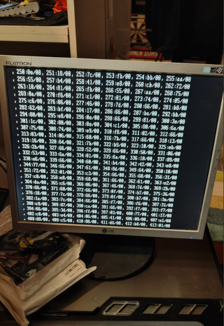

Hello Everyone.
My Server recently stated doing this and im concerned. The server used to display "login" and ask for my user and now it displays this wall of text and never moves on to the login screen. I tired waiting for a day and it just sits on this screen.
The server on the WebUI works just fine, I can log in and nothing is out of place, but I am concerned; this is not normal.
Logs where generated just after boot and are attached; any advise?

Update:
I think the issue was I was passing my video card to a VM. I have 2 video cards in my system. I set the second video card to handle my monitor output rather then the one being passthrough and the issue went away.
