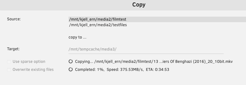

The copy speed on my servers are generally quite poor.
For Server1 in the signature. Copy a single file from 10 x sata ssd raidz2 to 2 x NVMe ssd in btrfs raid 0 should be significantly better than below 400MB/s. That's the speed from one single sata ssd. To my understanding the speed should be: 10 x 550 MB/s x 50% = 2750 MB/s. Right/wrong?

Sorry, its local speed, not over smb.
The singel threaded performance of I7-13700 is quite good. Can you see/suggest any reason this performance is well below 1 - 2GB/s?

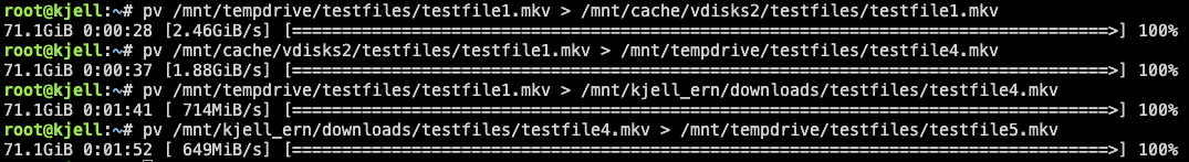

I removed the HBA card and mounted in the three M.2 slots on the mobo to get a baseline.
cache:        2 x mirror ZFS nvme ssd
tempdrive:  1 x btrfs nvme ssd
kjell_ern:     10 x sata ssd in raidz2
762459964_Screenshot2024-03-12at21_28_00.thumb.png.a5319a1a58c23a9c6841893ad07ac1dc.png
The nvme drives seems to be ok.
