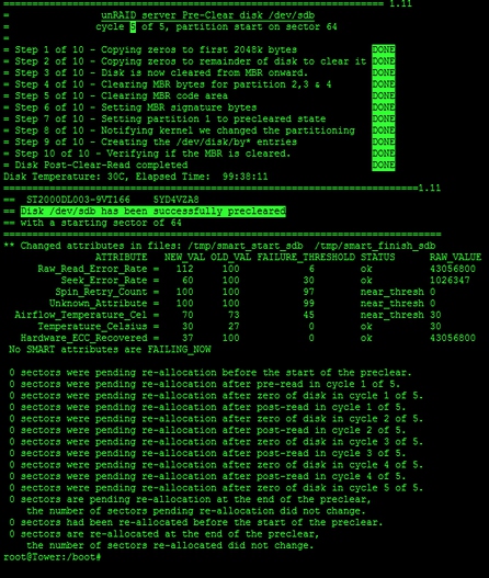

[SOLVED] preclear results check please??
I'm concerned about the "near_thresh" status indicators.  Anything to worry about?
a man of few words :)  Thanks.
Just an FYI... You are using a version of the prclear script that is two versions old.   Current is 1.13.
Of course, since you did 5 cycles of pre-clear, it might have been only 1 version old when you started  ;)
No need to clear again, but just a reminder to always check for an updated script.
huh ... I thought I had checked that, clearly I was wrong.  Thanks for the heads up.
